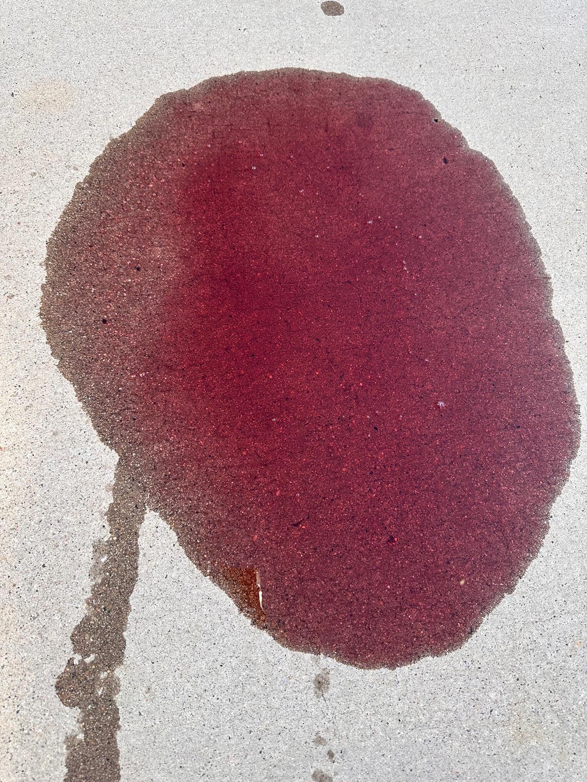

Three weeks ago (April 11th) after 3,700 miles on my 2023 Lariat, the rear motor had a catastrophic failure.
I was decelerating from about 40mph and turning into my neighborhood when I felt something weird in the back of the truck. As I came out of the turn and began accelerating something didn’t feel right.
After exiting the truck, I noticed a trail of fluid up my driveway. I pulled the truck forward, and there was a puddle of red dielectric fluid (see attached photo). That trail of fluid leads all the way back to where I turned into the neighborhood.

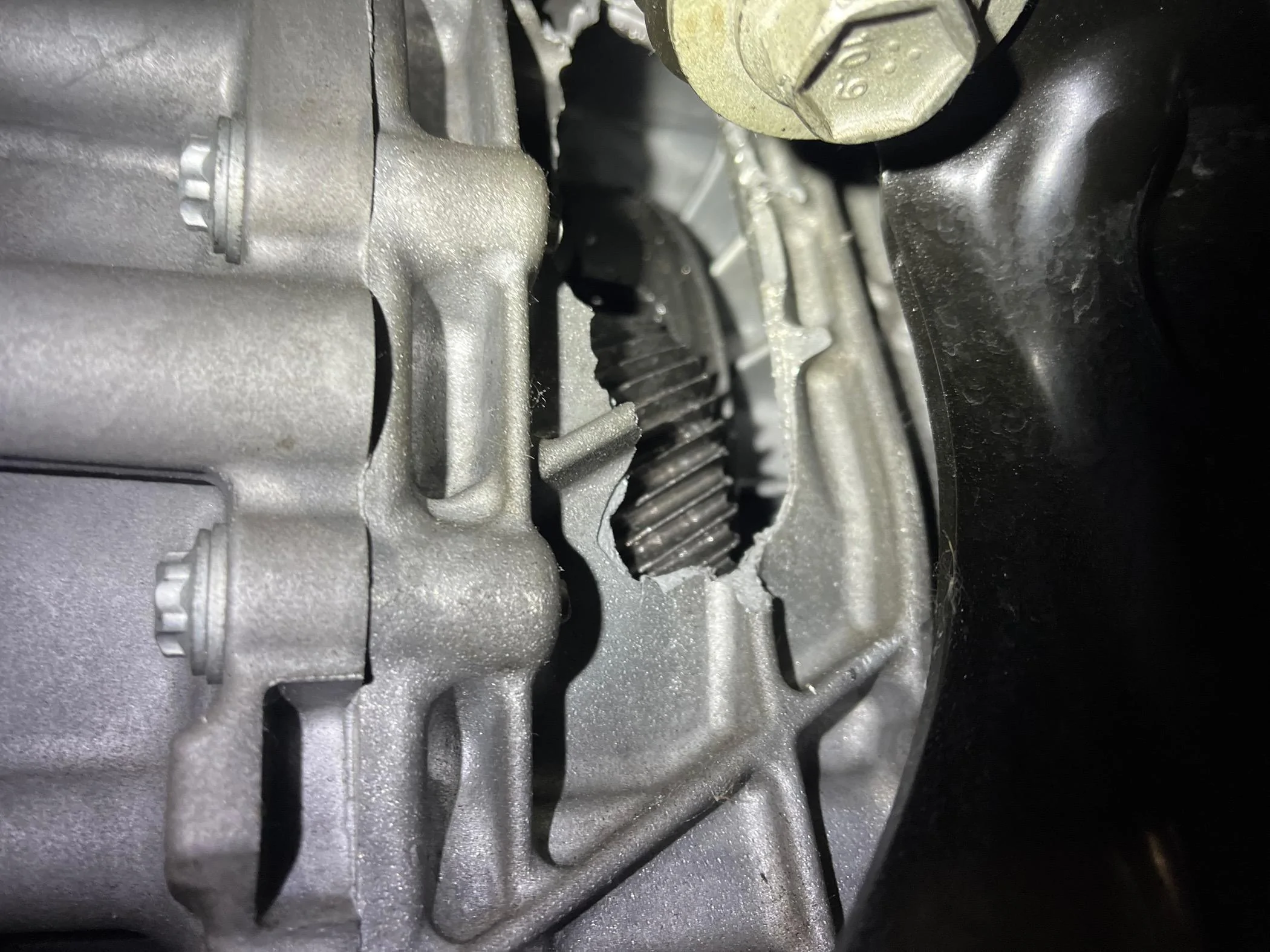

The next day, I had Ford roadside assistance tow it to a nearby dealer. The dealer said the rear motor was ā€˜blownā€ and there was a decent sized hole in it. (I’ve asked for photos. If I get them, I’ll share them.)

Received photos of the hole in the housing. The dealership was expecting to receive the necessary part(s) today. Hoping this doesn’t go beyond six weeks.

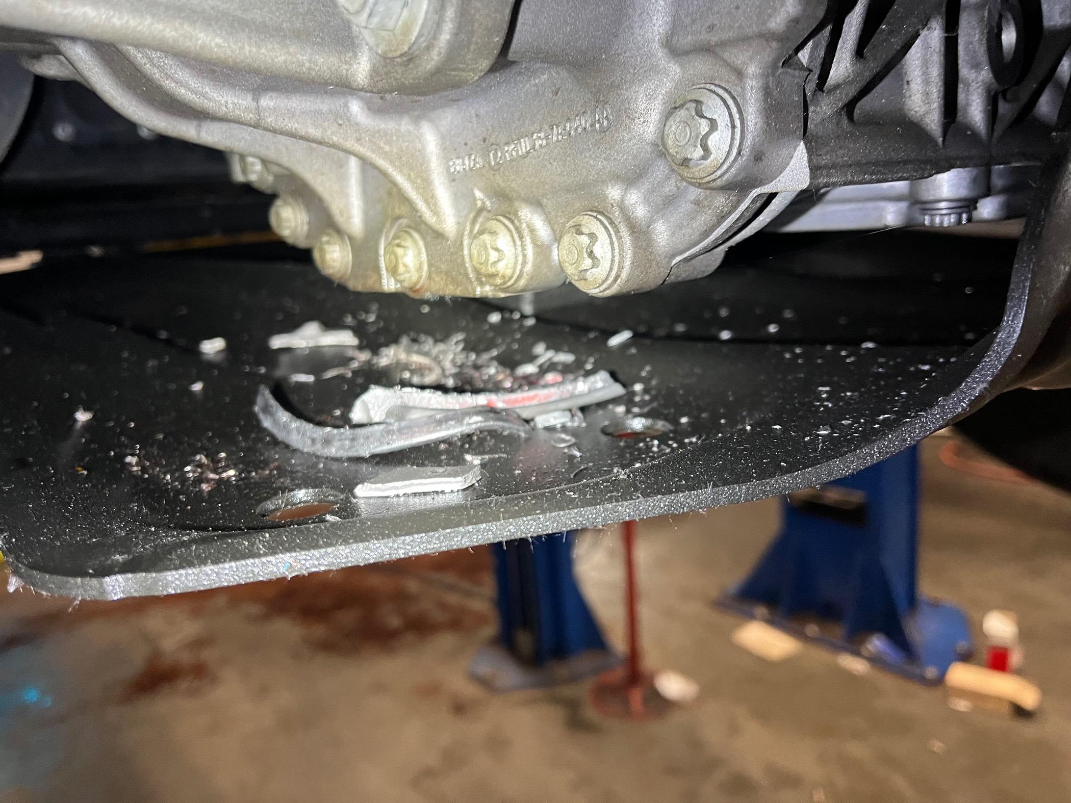

It’s March 2025. Mine is a 2023 I bought in December of 23. Lariat extended range. The rear motor just had a catastrophic failure driving in my neighborhood. I was approaching a stop sign at like 10-5 mph and heard a clanking sound. I have the one pedal driving engaged in sport mode. Leaked a red fluid. I called a tow to take to the dealer and then climbed under the rear. Chunks of metal are on the skid pan. I can’t believe the motor exploded. 26k miles on the truck. I have towed a boat weighing around 8 k pounds. But that was summer of 24.

Hope your replacement EDM comes in quickly and you're on the road soon.
Now that it's in the shop, could you get some photos of the carnage?
