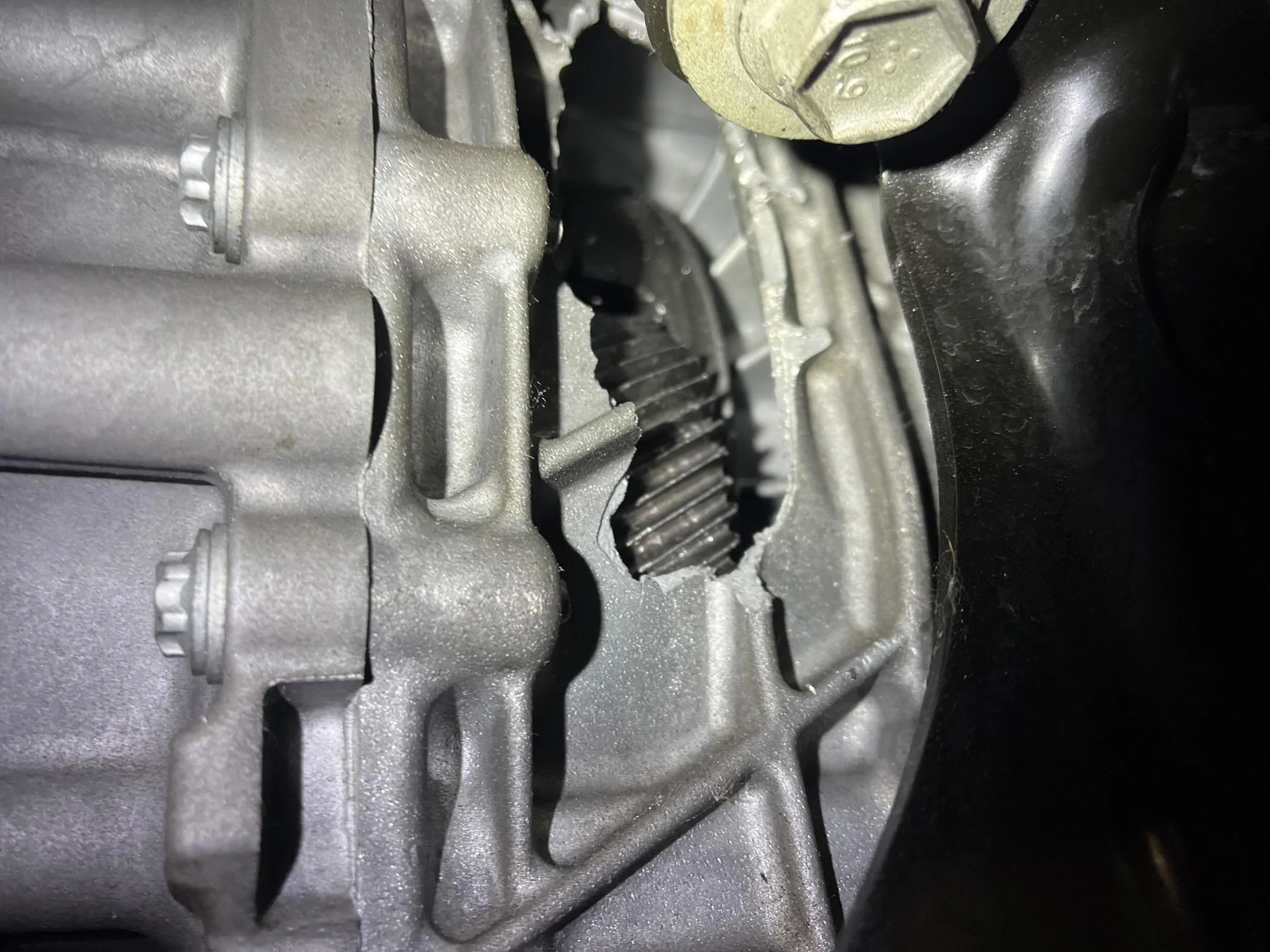

Very curious about the “decent size hole” thing. That doesn’t sound like a casting failure crack. I wouldn’t think a rock thrown up from road debris would have enough force to put a hole in a motor housing.
Oh yea I had to look up exsanguination! Thanks!
I’m certain it was an internal failure. Something broke while I was slowing using the regenerative braking. The force from the motor flying apart punched a hole in the housing.
Definitely not external debris because the motor is protected by a steel plate. If I can get photos, I’ll share them.

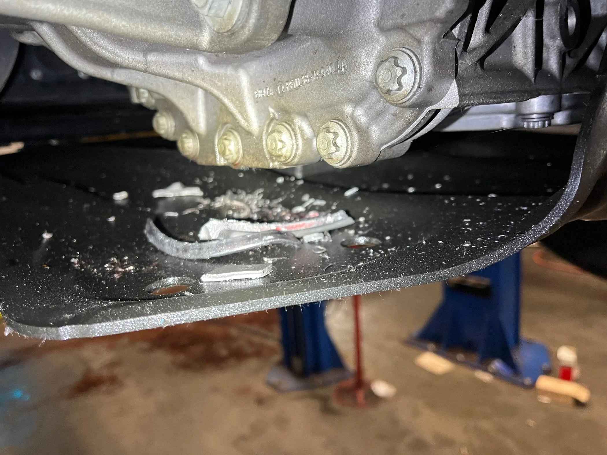

Really curious to see the photos, case fracture because of casting weakness, parking pawl miss engagement, other......?
Added photos. It looks like something catastrophically failed in the differential.

Received photos of the hole in the housing. The dealership was expecting to receive the necessary part(s) today. Hoping this doesn’t go beyond six weeks.
Ford F-150 Lightning Rear motor death by exsanguination. img_3243-jpeg
Ford F-150 Lightning Rear motor death by exsanguination. img_3244-jpeg
Ouch, something come loose and punched the case out!
Are they sending a complete EDM?
That was my understanding. But that was also nearly six weeks ago when I picked up the loaner vehicle. With the amount of damage and the tight tolerances, I don’t see how they could do it otherwise.
