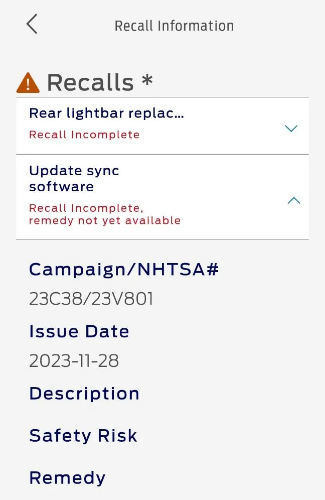

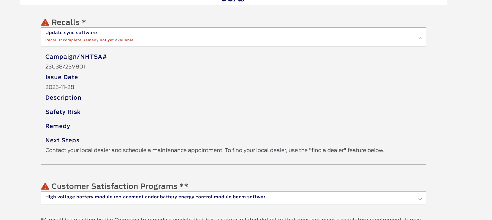

I just saw this today.
Update Sync Software
Campaign/NHTSA#
23C38/23V801
Issue Date
2023-11-30
Description
Affected vehicles may have software logic that does not reset the electronic stability control esc system to default operation at the initiation of each ignition cycle. Section 5.4.1 of fmvss no. 126 requires that the vehicles esc system return to the manufacturers original default esc mode at the initiation of each ignition cycle
Safety Risk
The vehicle operator may not notice that the vehicle operates differently after receiving the ota update 6.3.0 and now remains in off-road mode with a reduced esc state after cycling the ignition. If the vehicle operator does not notice the esc off telltale in the cluster, they may not know the vehicle is in a reduced esc state. For these vehicles, failing to revert back to a normal esc-on state after being in off-road mode makes the vehicles noncompliant to fmvss no. 126, increasing the risk of crash.
Remedy
The remedy for this program is a software update to accessory protocol interface module apim. Ford began Ford power-up over-the-air deployments to update the apim software for affected vehicles in November 2023. Alternatively, owners will have the option to take their vehicle to a Ford or Lincoln dealer to complete the software update. There will be no charge for this service. Ford provided the general reimbursement plan for the cost of remedies paid for by vehicle owners prior to notification of a safety recall in may 2023. The ending date for reimbursement eligibility is estimated to be January 5, 2024. Ford will forward a copy of the notification letters to dealers to the agency when available.
