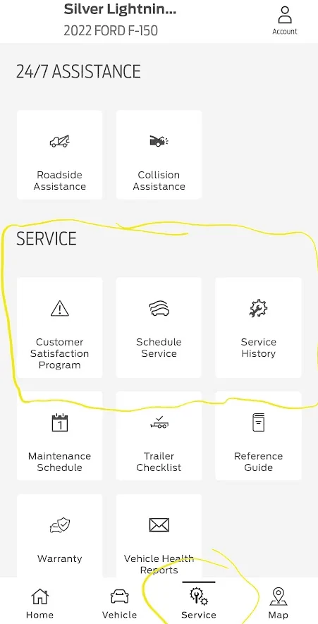

What does your Ford Pass tell you about these concerns?
Look under the Service tab, if there are open Recall's or CSP's the tile(s) will be active under the {Service} section, tap them to review the listed concerns, have them addressed on your next service visit

Take a look at your FordPass app, or log into your ford.com account, and see what pops up as taxman suggested

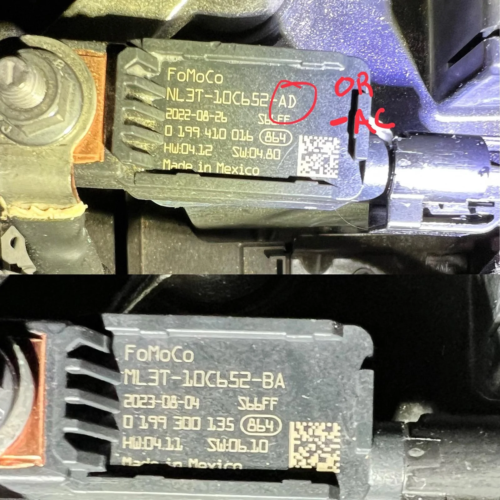

You can also check to see if you have the affected part. Open the battery door at the back of the frunk and look at the part mounted on the negative battery terminal. If the part number matches the top photo it needs to be replaced. The bottom photo is the new unit.

As always, you are all very helpful. It is indeed CSP 23B57 "high voltage battery module replacement and/or battery energy control module becm software update"
And it does look like the part I have currently matches the top photo in the above post. But I'm glad to hear its a simple fix so I shouldn't be nervous having someone do it.

The B57 one is usually just a software update that only takes a few minutes. They should be able to do both B57 and B70 in less than half a day. Make sure the dealer has the part for B70 in stock and then schedule them both together.
