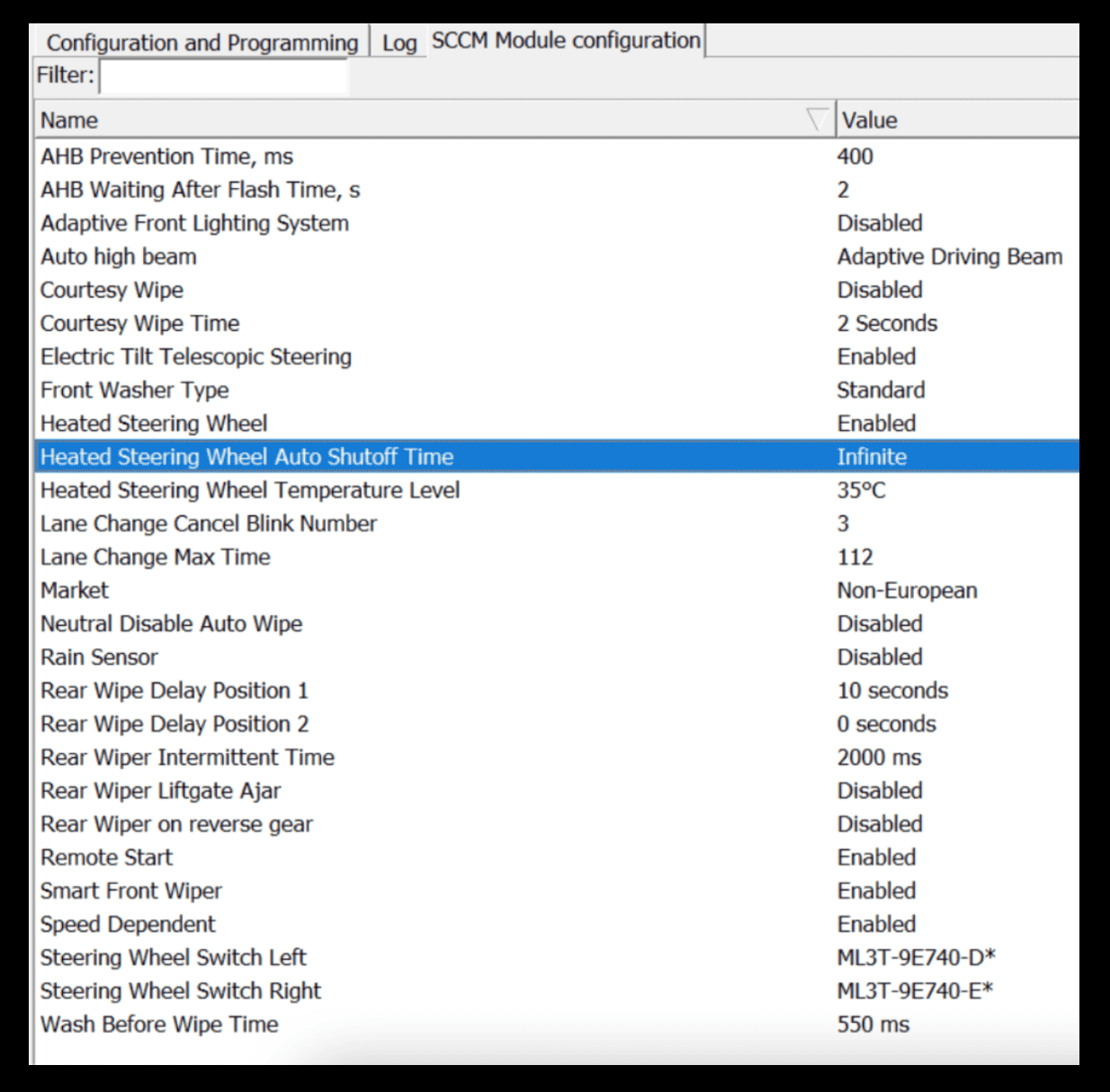

My dealer just fixed my issue. They did this TSB 21-2232.
"Some 2021 F-150 vehicles equipped with a heated steering wheel and built on or before 14-Jun-2021 may experience the heated steering wheel turning off within 10 minutes after being manually enabled and/or the heated steering wheel not being"
I had already check this setting in Forscan and my setting already configured to Infinite.
Mine was built after the affected dates for that service bulletin. My heated steering wheel works fine while driving. It’s when the truck is remote started that the heated steering wheel and seats don’t work as they did in the previous generations.
