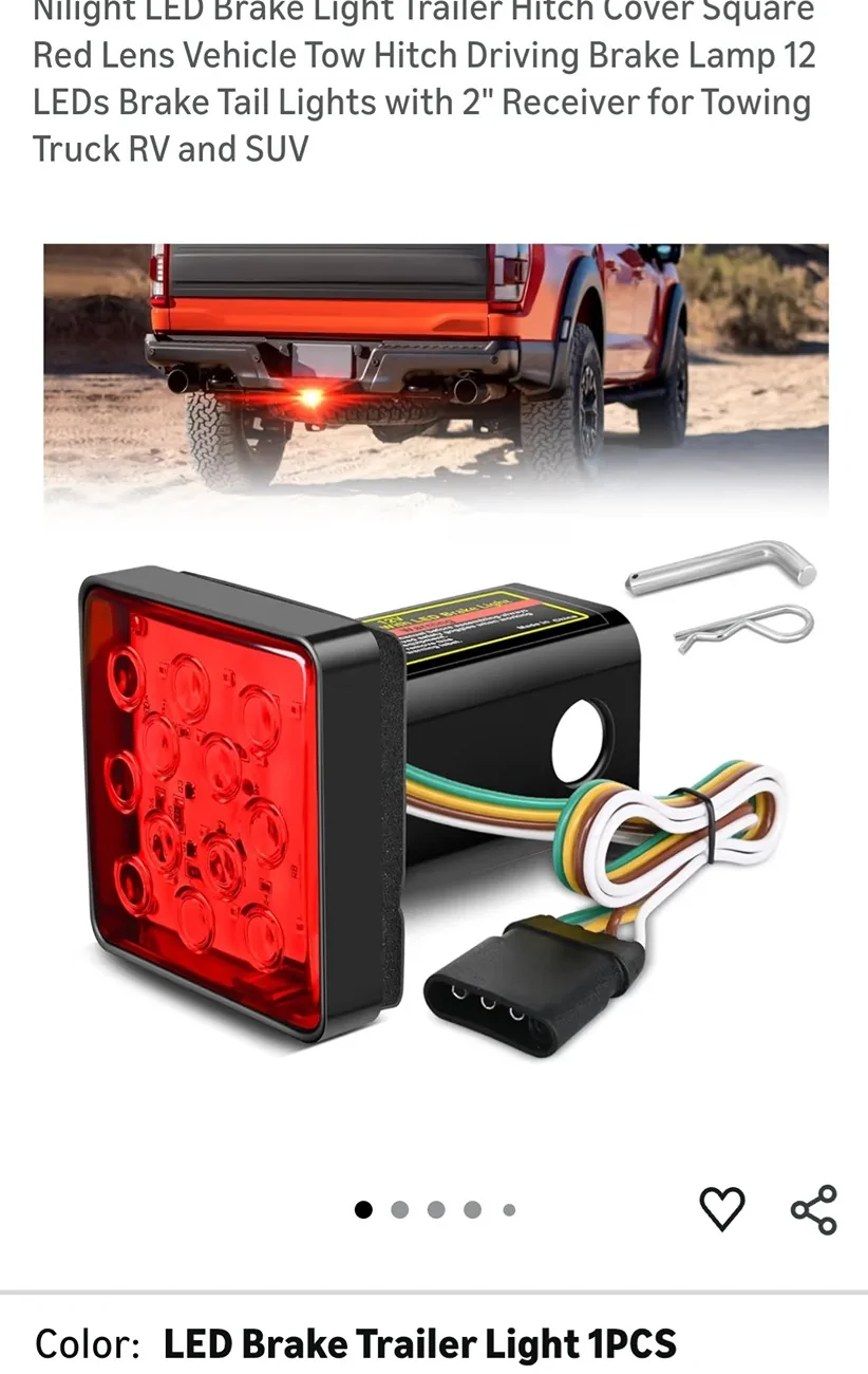

The only way is to plug something into trailer connection that draws enough power to make the truck think it has a trailer connected. If there is a way to do it with FORScan, don't hold your breathe for me to figure it out. That is above my paygrade. lol
Install a trailer brake light? Going to try today after adding feature to Forscan. Anyone get this work already?
Problem with this is that truck will assume you have a trailer connected and most of the driver assistance aids will be unavailable like BC etc.
Yea. I can disable the warning but BC unavailable, which is fine for my commute which is all under 55mph. Turn camera activation on Sync screen is a nice addition if BC and rear sensors aren't import for your route.
So did this work for camera activation?
