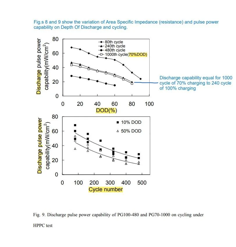

The following is taken from an older report of a HPPC test of a pouch similar to ours, but with a different cathode chemistry. We must wait for results of our pouch cells to know if it applies, however it is of interest if you regularly charge to 100% without needing to.

The report found an equal amount of added resistance within the cells after charging to 100% capacity 240 times; as is found when charging 70% capacity 1000 times. In addition, they determined the loss of capcity is not linear over the first 240 cycles, but the additional internal cell resistance can be measured before half that number of cycles.

Interesting, although older is quite older ... (2003) :), thanks for sharing!
So, at 0.5C, room temperature, 1000 cycles, they report 14% capacity loss for 70% DOD, and 70% capacity loss for 100% DOD, under the HPPC test.
They do say at the end that: "The large capacity and power losses in this cell chemistry come mainly from increases in the bulk and/or interfacial impedance of the cathode".

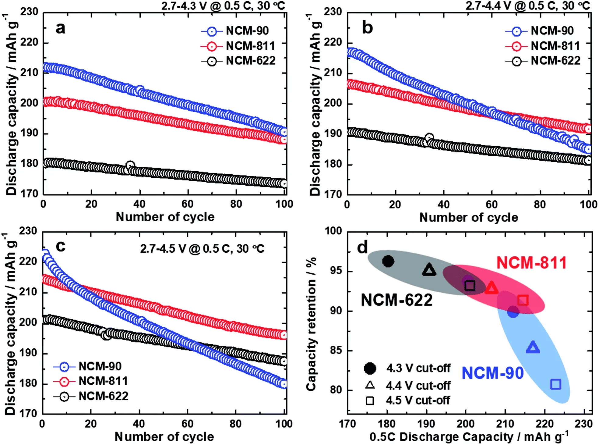

This is a 5 year old article announcing the SK NMC9: NCM 90: successor of NCM 811 battery cells - Posts - 🔋PushEVs, including some comparative data pasted below:
Ford F-150 Lightning Running the Battery to 0% 1712449837333-tk
An excerpt regarding the NMC9:
The NCM 90 cathode when cycled between 2,7 and 4,3 V at 0,5 C retains 90 % of its initial battery capacity after 100 cycles. Therefore, a new electric car with a 600 km range would have a 540 km range after 57.000 km [(600 + 540) / 2 x 100)] in these conditions. The good news is that no electric car battery is cycled in these extreme conditions. They are far better protected.
I would like to see how the NCM 90 cathode behaves when cycled between 2,8 and 4,1 V, it’s reasonable to expect that the cycle life is much better than only 90 % capacity retention after 100 cycles. It has to be good enough to allow a standard battery warranty, which for most EVs guarantees a minimum capacity of 70 % for eight years or 160.000 km (100.000 miles).
Does the last paragraph sound familiar? :)

Something seems off in these graphs. Why are they overcharging the cell? Vmax (maximum voltage) should be 4.2 V, but the graphs show going above this. When I program my cyclers, the safety limits are set to 4.25 V, and they will shut down if the voltage goes over this value. Did they have an agenda to show how bad NMC 9 1/2 1/2 would perform? Also, it's lazy to label this chemistry as 90 instead of including the half for Manganese and Colbolt.
Box Cat
Feb 25, 2024
Portland, OR
Well, they go as high as 4.5V which is even worse.
When I purchase a cell I get the specs from the manufacturer and set the charger/ BMS accordingly.
I assume 4.5V is within the safe range for testing the cell.
Yeah, people are lazy, but it is probably ok in the context. Also the article does not provide the whole paper so details may be missing.

Most probably, since they call it NCM 90 the CM portion might not have been disclosed at that time.
