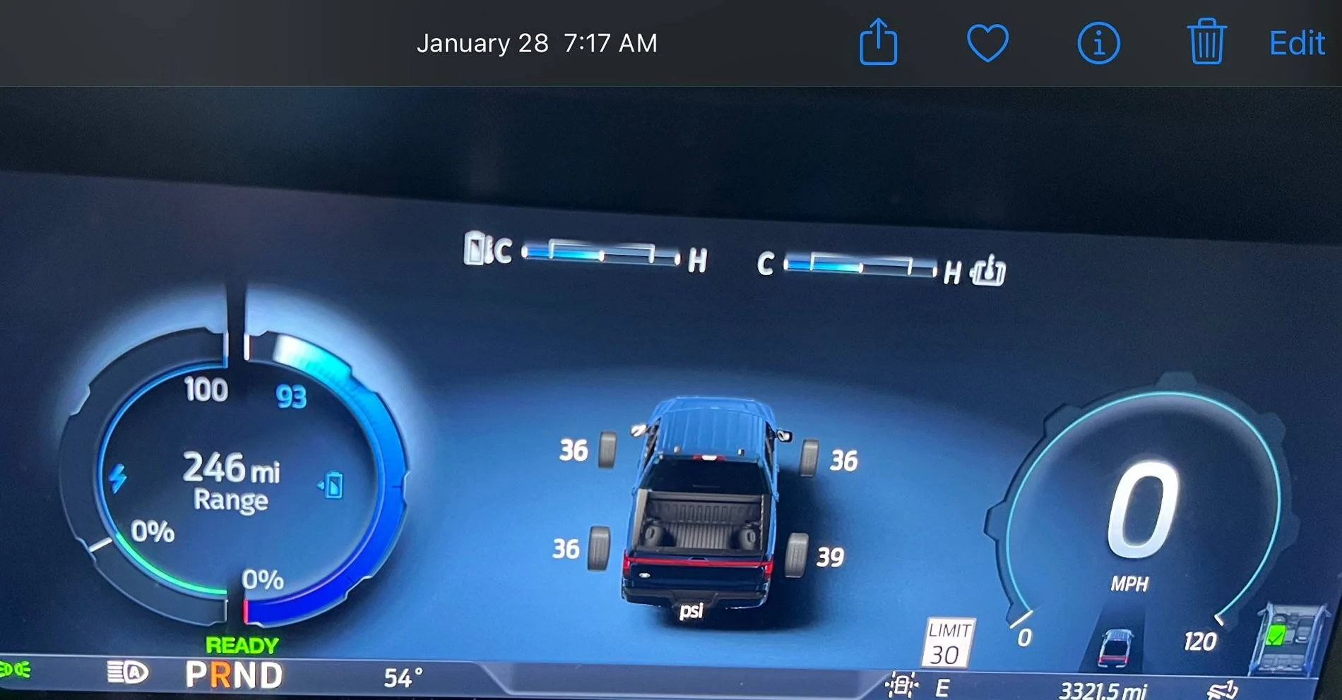

The cold weather performance of EVs are abysmal at this time, and this is coming from someone in Orlando FL. :unsure:
My personal experience with both a Tesla S100D and an F150L Lariat are that you’ll get 2/3 advertised range in wintertime, with the lowest daytime lows being mid-40s(F) and driving in a manner consistent with any other vehicle.
Yes, you can increase range by bundling up and using minimal heat, driving under the limit in the right lane, etc… but to me , time and comfort = $. Personally the more concessions I have to make, the more indicators I’ve made the wrong choice. YMMV.
Here’s a screenshot of my dash GOM. 50/50 Mixed city/HW and minimal use of heat with temps in the 50s here in CFL.

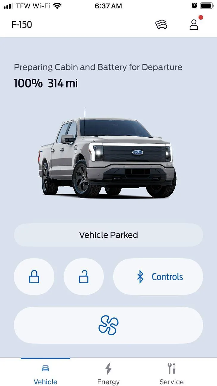

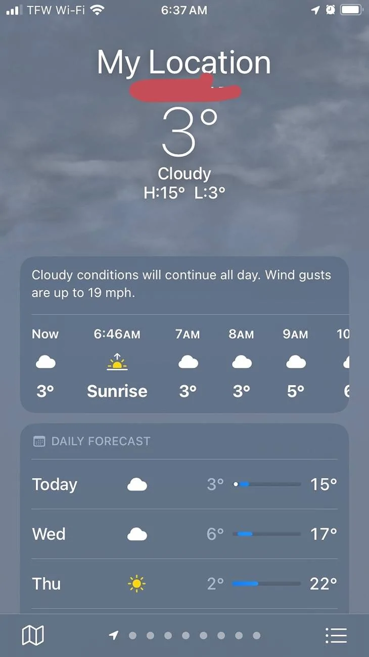

My Lariat stays outside year round. Currently warming at the moment. In these climates, getting a little over 200 range has been my experience on long drives. A lot depends on how you drive, though. I really stick the speed limit and utilize the blue cruise to maintain some consistency.
