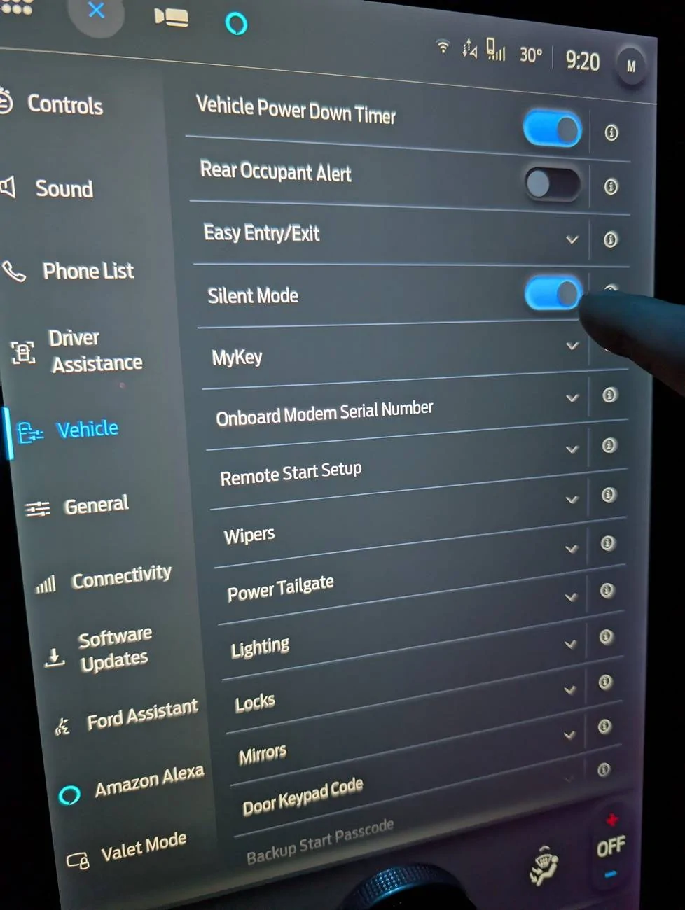

The "Silent Mode" setting allows you to tell the truck not to respond to anyone's approach. It won't turn on puddle lights, rear lights, the light bar, interior lights (except one), etc.
This has to be enabled in Forscan (at least on my 2023 Lariat it did). I don't have Forscan running at the moment, but I believe the setting was available in one of the pre-configured settings so it doesn't even require editing modules' hex codes. If someone else has recently found this mode in Forscan and would be willing to provide the specifics, that would be helpful to others.
Here's a video of me approaching the truck with my key. Silent mode is toggled off.
I toggle on Silent Mode:
Ford F-150 Lightning Silent Mode (dark mode). Useful for camping, astrophotography, astronomy... PXL_20250102_042050050.RAW-01.COVER (1)
Then I lock the truck, walk away, and then return a short time later, with the key.

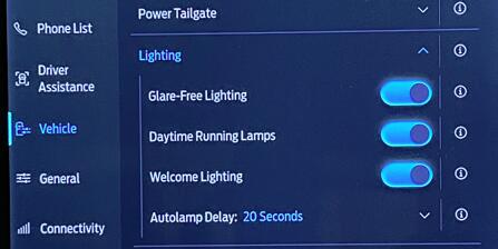

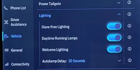

There is a setting further down in the Lighting section called Welcome Lighting that is is supposed to toggle approach lighting on/off. Is this different than that?
I could imagine a true campground setting that would keep the truck dark when also unlocking or opening a door for example (as opposed to just approaching).
This is different and more akin to a "true campground" setting. With the "Silent Mode" on, as seen in the second video, I can get into the vehicle with only the IPC dimly lighting up. No other lights come on.
With the welcome lighting turned off, we still get a lot of light when opening the door, for example.
