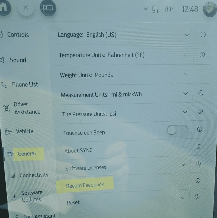

Where does one get to see the update number? All I see is a vague description of what may have changed.
Should see the number associate with the brief description on the Sync screen, ignore the yellow highlight on this snap shot, see [Software Updates]
On my Android phone, I see the update via the Ford app: Select Vehicle / Features & Settings / Software Updates / Recent Changes (shows the download date) / details and Version.

On my Android phone, I see the update via the Ford app: Select Vehicle / Features & Settigs / Software Updates / Recent Changes (shows the download date) / details and Version.
Yup, that too, wasn't sure which way the poster was looking for it, but both methods work.

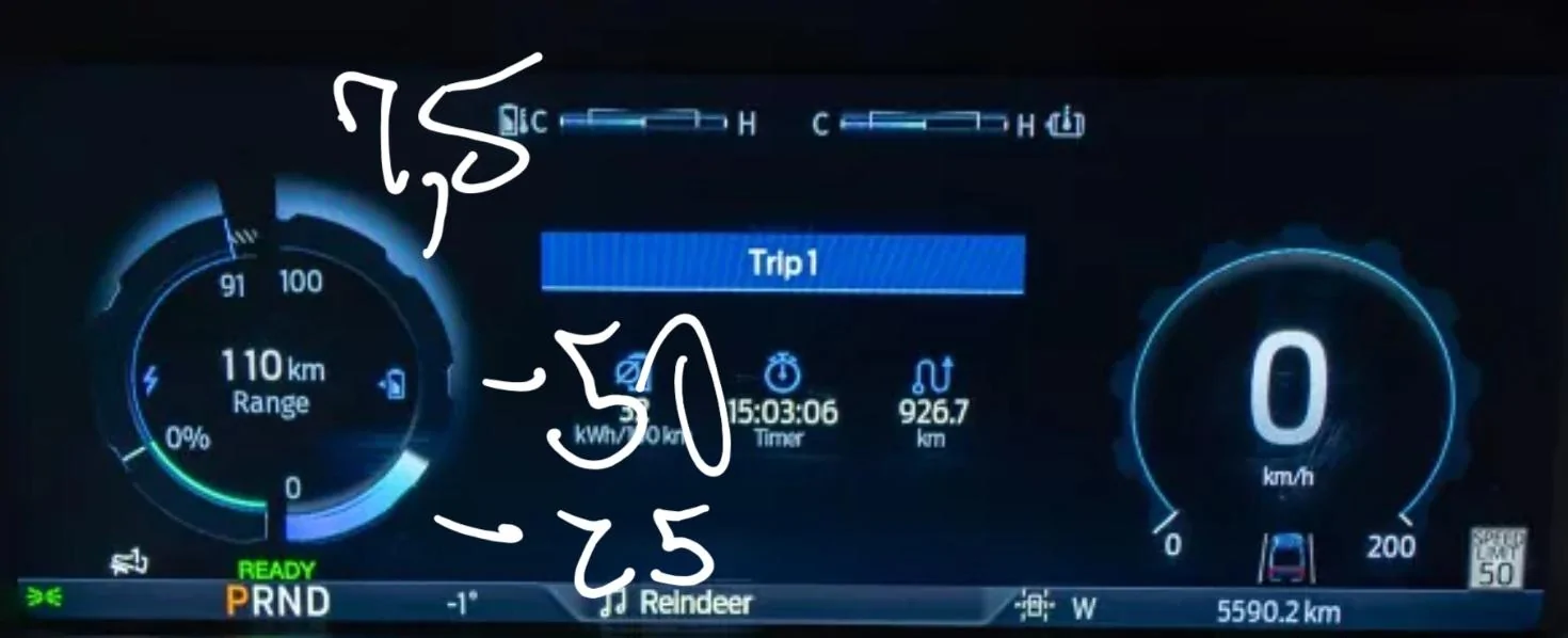

As far as user friendliness goes, even without the % specifically, the gauge is there with tick marks at 25, 50 and 75% so you should have a decent ballpark already. Neither Calm Screen or the charge app are difficult to get to either if you need the specific %
As far as the update pattern, your comment applies way more intelligence to the process. It's really just phased roll-outs that eventually cover everyone, but new cars and trucks don't get added to the roll-out population for awhile.
Are you talking about tick marks on the left side above the SOC % ? If so , I only see ticks for the regen - braking energy recaptured . all other times , there's nothing. Otoh , it may be somewhere else on screen & I've been oblivious to it the entire time . Tends to be a problem of mine , missing the obvious.

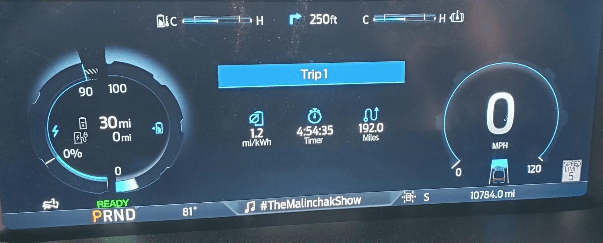

@TheWoo beat me to it, here's my dash before the SOC update last summer, you can see the quarter increments clearly when the SOC's really low [15%] as seen in the photo, road trip to Salem NH with me and two passengers and a 7x14 tandem axle trailer in tow.

Ford F-150 Lightning SOC Display on Instrument Display 1703796026905

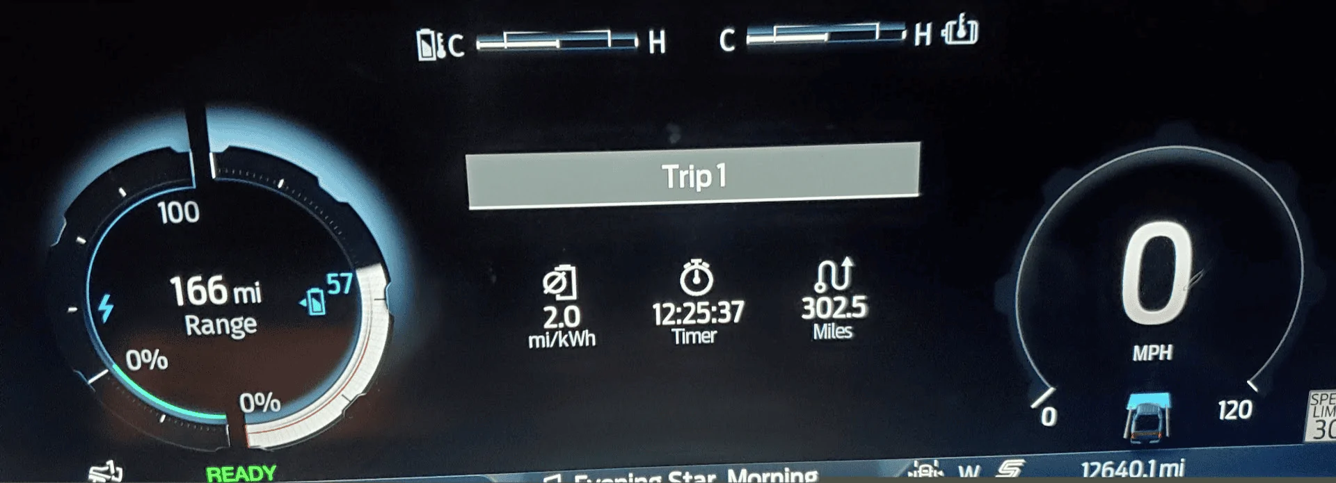

What it looks like after the SOC update last August 26 2023
Ford F-150 Lightning SOC Display on Instrument Display 1703812123351

@TheWoo beat me to it, here's my dash before the SOC update last summer, you can see the quarter increments clearly when the SOC's really low [15%] as seen in the photo, road trip to central Connecticut on a very cold day with me and two passengers.
Good pics @TaxmanHog - I'll add for the @Buio that not everyone has received the updated SOC reading, so don't freak if yours doesn't have it yet. Mine still is 100 and 0 and I've had other recent updates but keep missing out on this one. It's probably the update I most covet that I haven't received.

@TheWoo beat me to it, here's my dash before the SOC update last summer, you can see the quarter increments clearly when the SOC's really low [15%] as seen in the photo, road trip to central Connecticut with me and two passengers. as seen in the photo, road trip to Salem NH with me and two passengers and a 7x14 tandem axle trailer in tow.
Whoaa! Your dash is showing 1.2 mi/kWh and it's summertime! Were you towing something or doing 100 mph in central Connecticut! 😀
