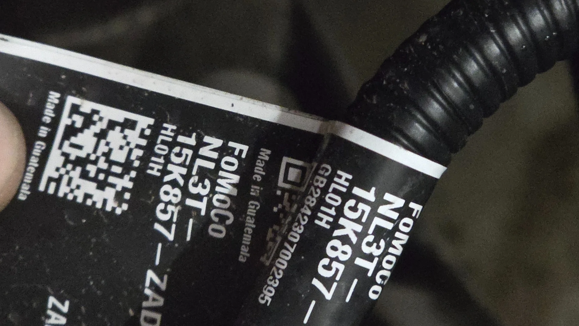

tarik
Taras
Dec 2, 2025
Toronto
F150 lighting lariat 2022
What exactly did they change? I changed the ABS sensor that ForScan showed, but the problem remained even in the rain. Maybe they changed something else?
tarik
Taras
Dec 2, 2025
Toronto
which ones? maybe you have a photo or information. I have the same problem during the rain. but replacing the sensor did not help

tarik
Taras
Dec 2, 2025
Toronto
Sorry. What exactly did they change? I changed the ABS sensor that ForScan showed, but the problem remained even in the rain. Maybe they changed something else?
tarik
Taras
Dec 2, 2025
Toronto
[ЦИТАТА="RLXXI, повідомлення: 611370, учасник: 4618"]
Англійською, будь ласка.
[/ЦИТАТА]
the abs sensor that forscan indicated was replaced. but at the first rain this problem appeared again
