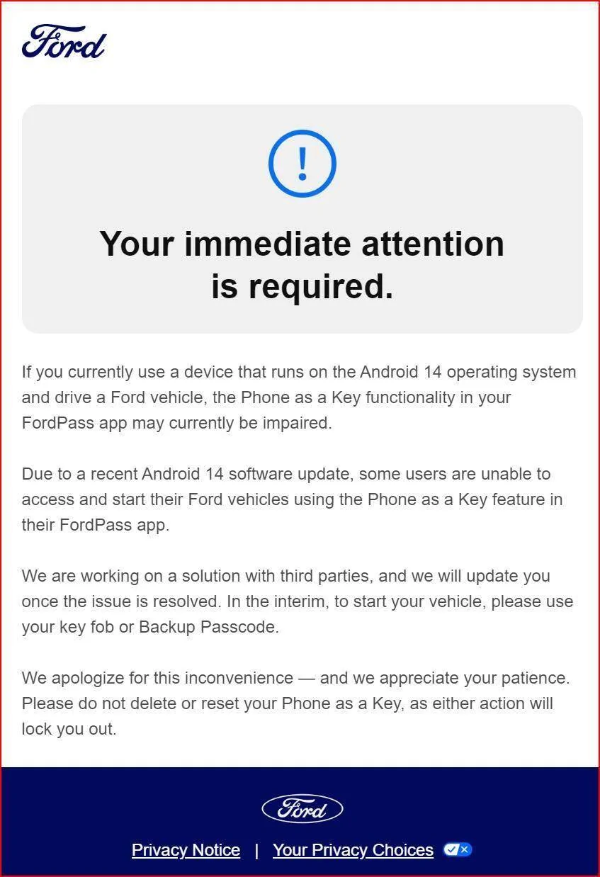

Well all I can say is that the CSP warning for Android users of phone as a key stated to not delete the phone.

Thanks, I was not aware of the CSB on Android. Do you happen to have the Bulletin number for reference?
