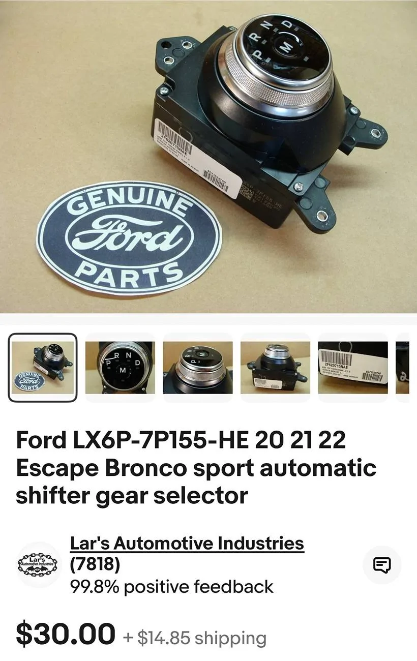

I’ve already received and tried two different orders of ones that the knob covers do not fit unfortunately. I have the shifter from the OP that is $30 and has the M button. The FORD LX6P-7P155
Maverick one is too big, 😩
Bronco Sport one is too big 😩
Ford F-150 Lightning Stick to Rotary Shift Knob Conversion w/ 3D Printed Rotary Shifter Holder IMG_8126
