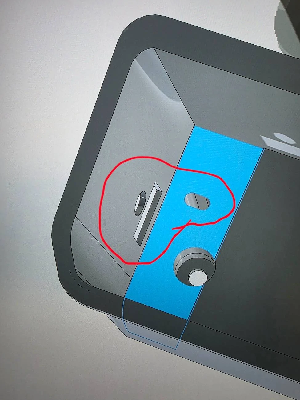

I have another question...
What is the purpose of the little "step-down" at the back and the three different holes ?
i.e. can any of them be deleted if Im not doing a charger and/or the storage containers?

Thank you very much for sharing this !
Good question. The little step down was a requirement for my particular use to allow for enough depth for the wireless charger to engage and charge my iPhone 15 Pro. It really serves no other purpose and my solution to make the design more universal was to design and include a "TPU matt" piece that covers that depression and extends all the way to the shift box. That matt is called "TPUMat_Full" on Thingiverse, FYI.
As for the three holes you circled, I would say non are truly necessary, although the one on the bottom of the console was present in my reference design and allows you to visually align the console to an existing OEM plastic post that sits between the front bolt holes. The two holes on the back face (what would be "firewall" facing) are for USB accessories. The top is a dumb passthrough to accommodate anything you wanted to pass into the void, or into another console (I passed a separate USB into the frontmost console; the one with the sliding top). The bottom one is for the panel mount USB pigtail I included in the BoM. Both can certainly be deleted/covered over if you have no use for USB in the console.
P.S. Huge thanks to @Drayday55 and someone else from the forum (not sure of their username here, and not trying to dox anyone) for adding to my beer fund via the Thingiverse tip jar. My cup runeth over guys :beer:... it seriously means a lot to me and really keeps me motivated to keep drinking and making things :crackup: .
