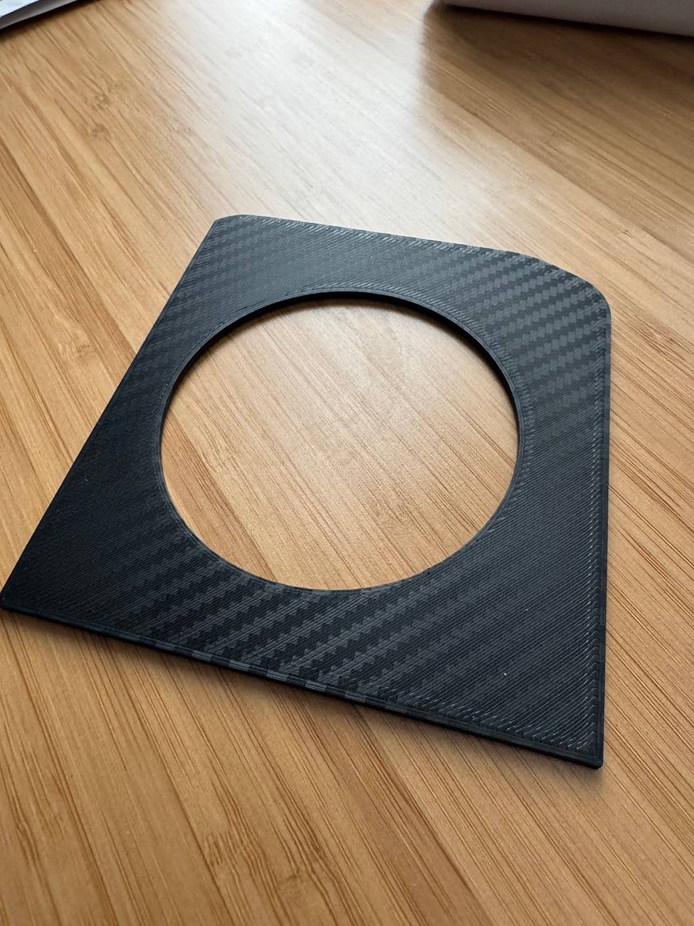

If anyone wants some texture on their 3d print, here is a cool idea for the cap.
I did a quick sample print of the cap (just the top) with a carbon fiber textured build plate and Polylite ABS. Use the flat lid….print it upside down. Kind of cool!! Worked first time out
plate used: https://a.co/d/fbbGtCs
That looks sick! The extrusion lines around the edges almost make it looks stitched too. Very cool.

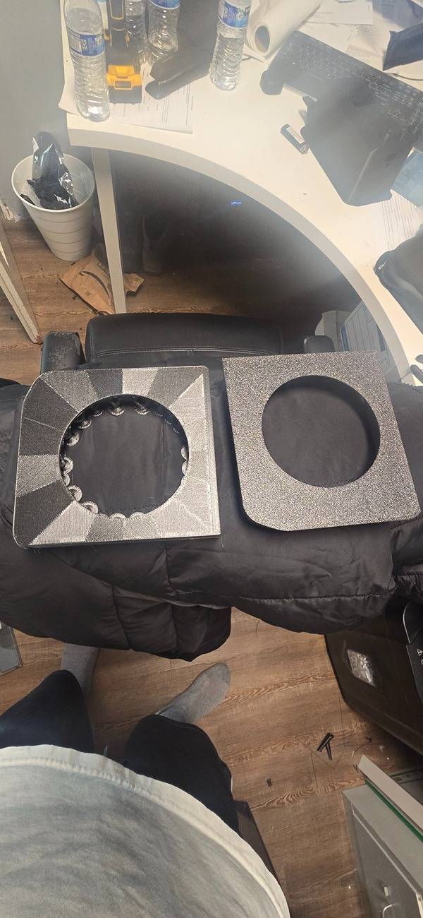

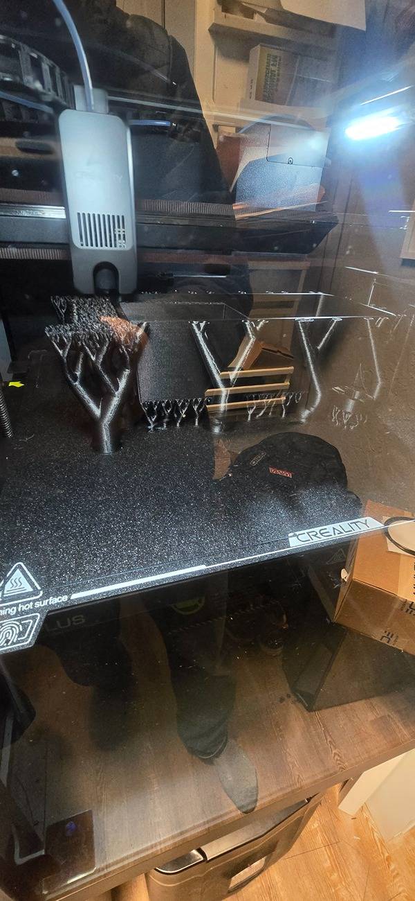

What do you guys think? Textured or pattern?
I vote textured as there are a lot of patterns going on there already.
