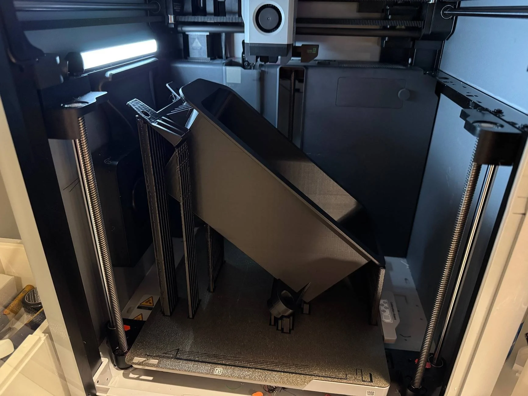

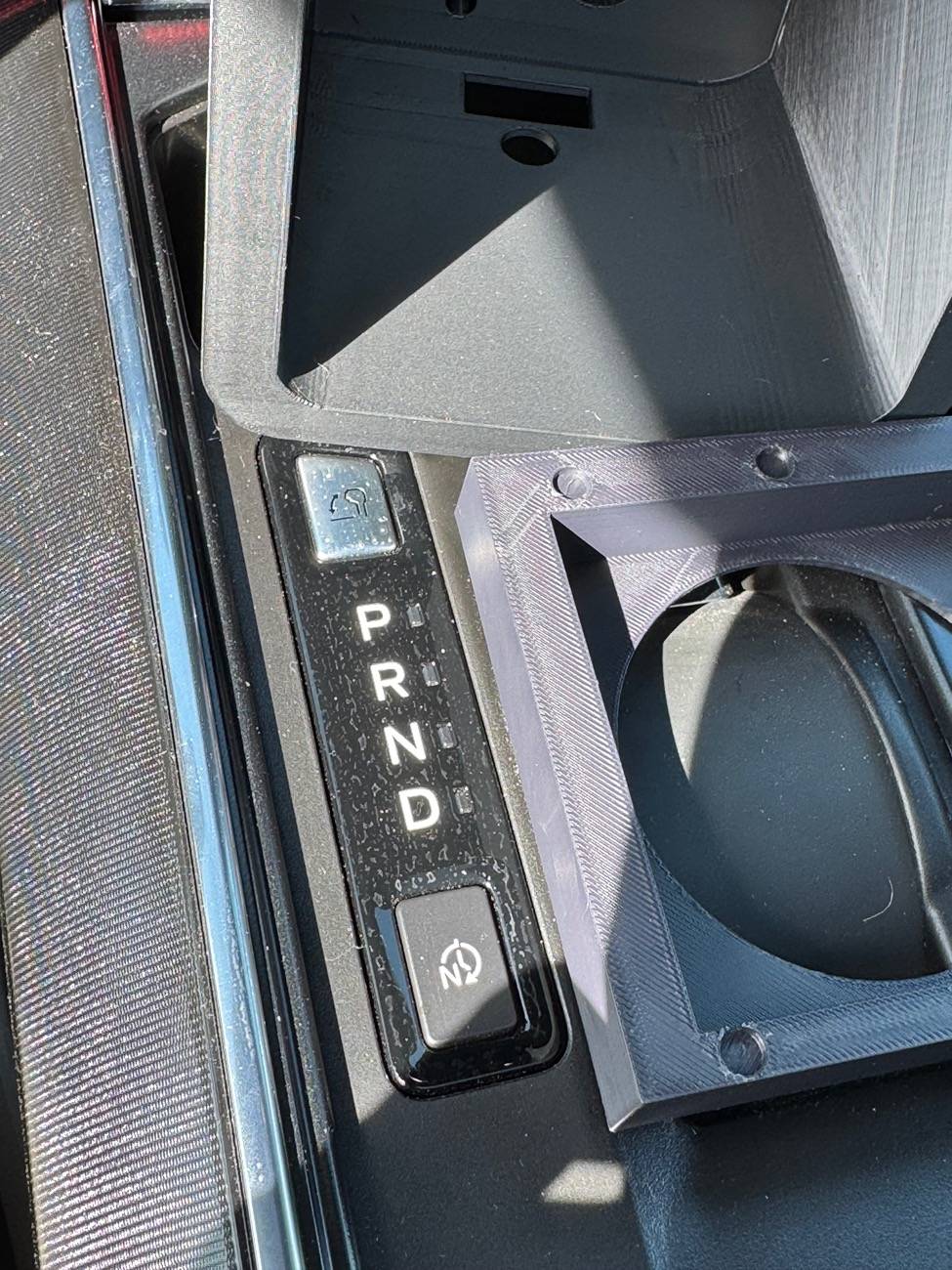

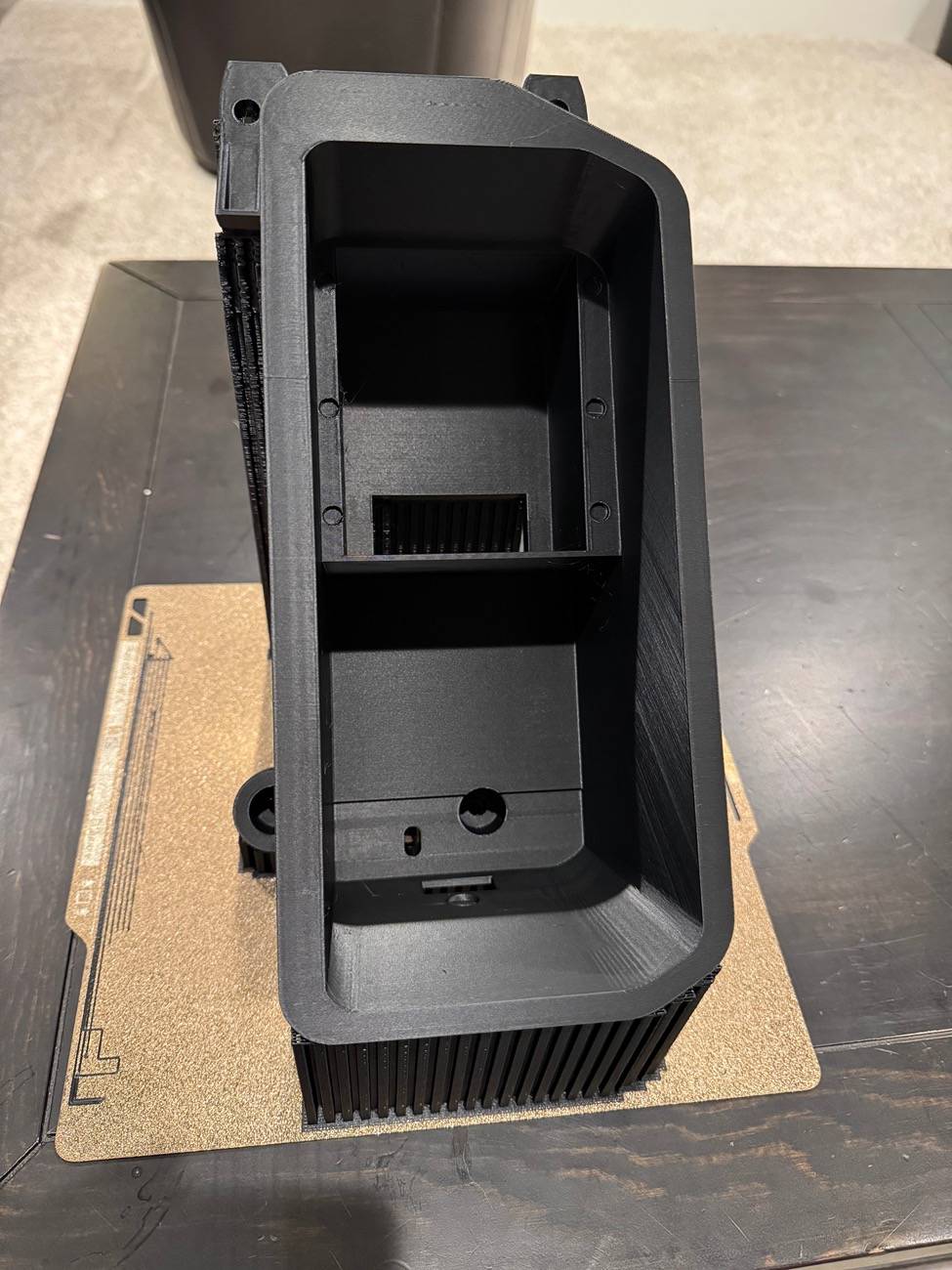

Printed both parts vertically. (Original cap version,… not using the carbon build plate, that comes Wednesday). No post processing done , except sanding off some of the supports in the circle.
Overture ASA Black is a bit too grey, almost a hint of red in the sun. It doesn’t match the ford interior at all. See the photo with the stock shifter. For the color difference. Major bummer.
Bambu labs PETG HF black is a nice deep black, but lacks the heat requirements for a hot summer day! I have Polylite ABS Black on order.
printer: Bambu x1c 0.2mm layer height (standard); 10 hours for the main body, another 2h for the cover (upright). Total filament, with supports, was around 350grams (1/3 a spool)

Awesome idea to print diagonally! Very happy to see it can be done in 256mm cubed as that appears to be a common build volume and expands my printer choices quite a bit.

Wow, this turned out great!

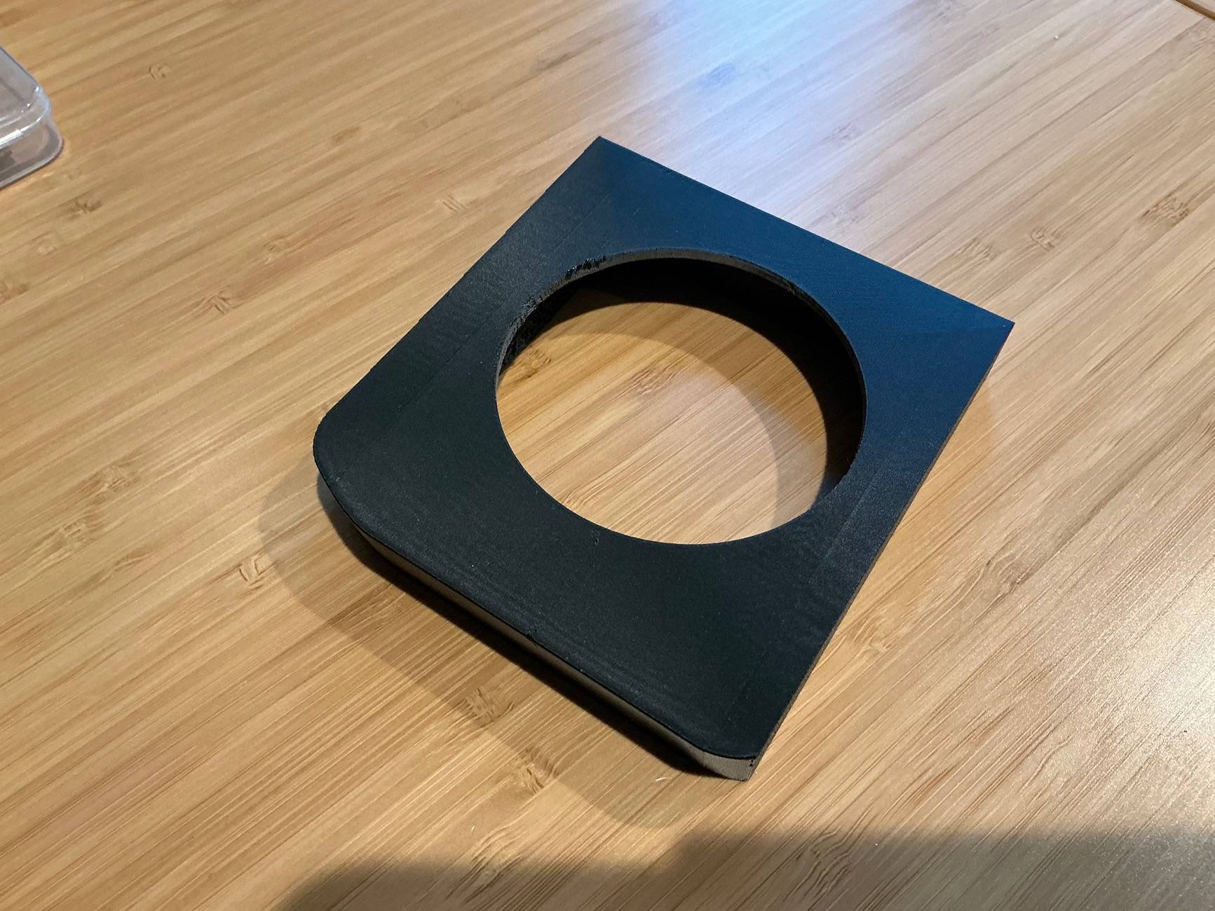

I think Im missing something, I printed the version with the magsafe slot and the lid built in, but the lid isnt removable? So how would I get the shifter in there?
I printed the version without the magsafe and there isnt a lid, so I can print that separately.
