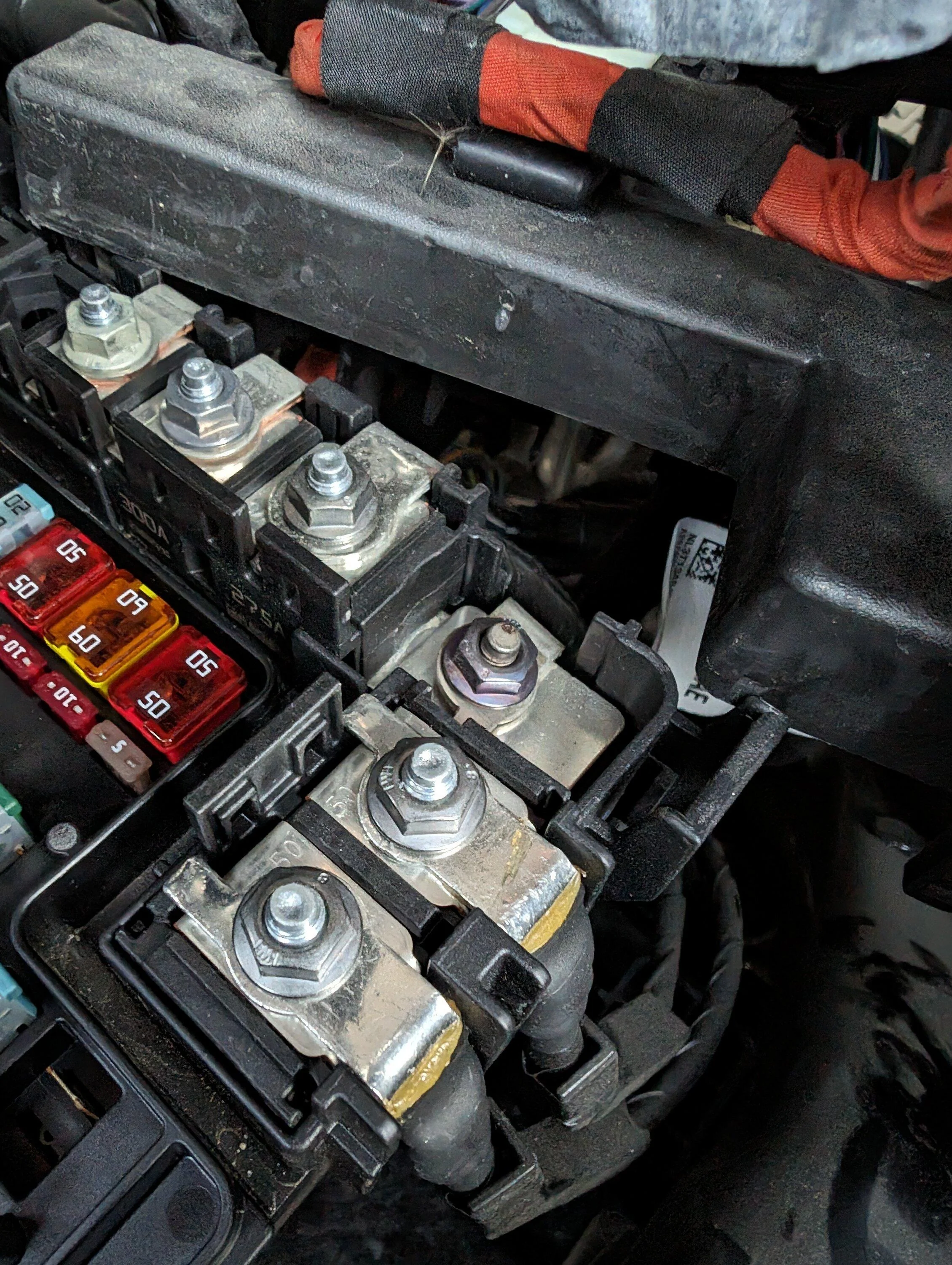

Do you have a way to check voltage at the bus bar?

No apparent signs of mouse damage. I didn't remove wheel well panels but I looked everywhere and everything *looks in order*.
Just checked these connections and all seem secure. I also checked the grounding points on the Fram that I can see from the wheel well and from crawling under the truck and those ALSO seem secure.
It WAS raining the night after I drove, before this happened. But besides that the truck was largely undisturbed. Will charge the 12V again all night and see if that fixes it, but did that last night with no success.
