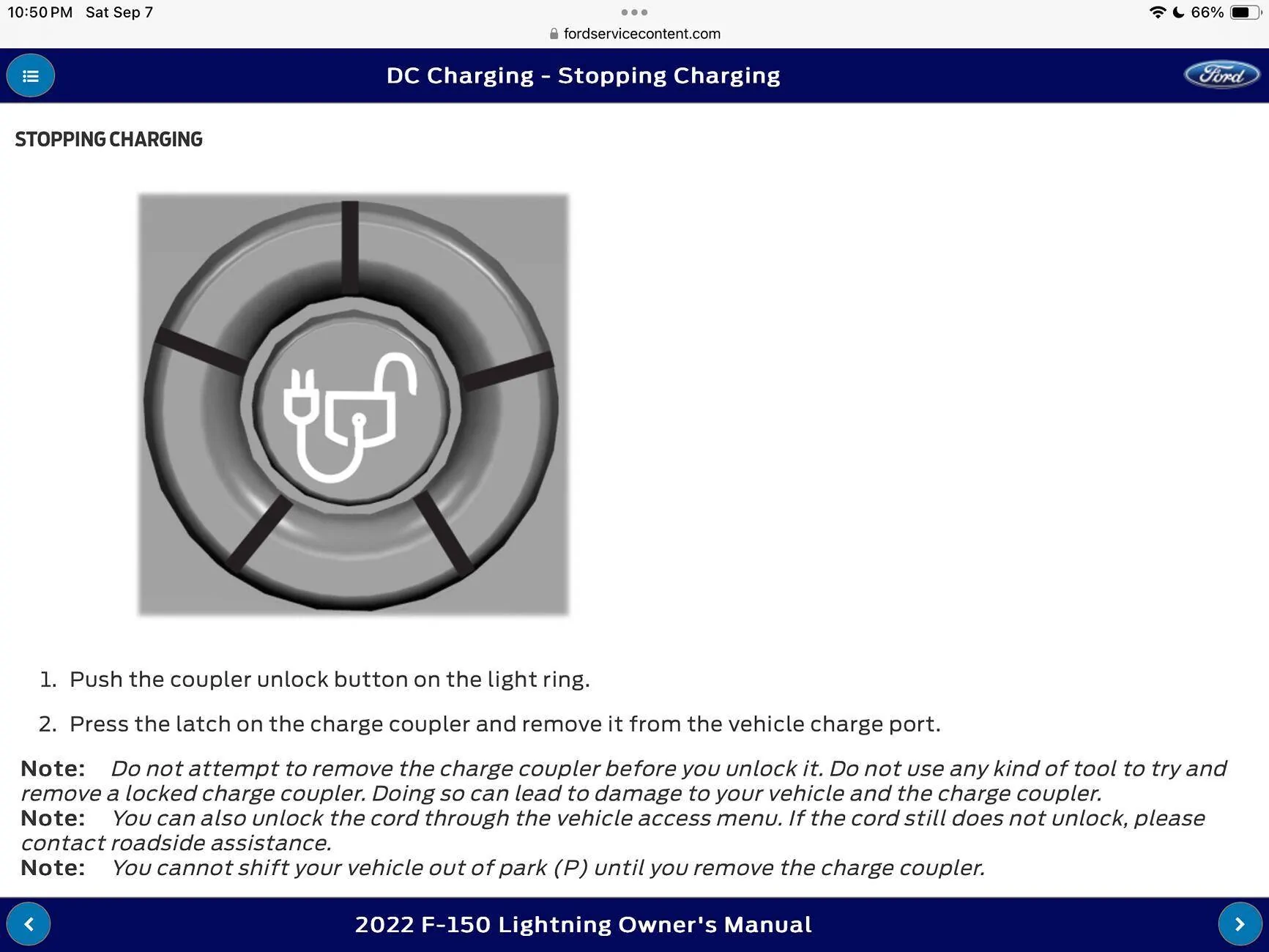

Are you guys neglecting to push this button before you try and remove the CCS plug or CCS adaptor, and possibly damaging your charge port ?
It's not clear that the OP abused or failed to follow disconnect procedures, since this episode, other trucks experienced this issue, requiring an update and/or repair of the DCFC safety interlock within the truck side CCS port.
