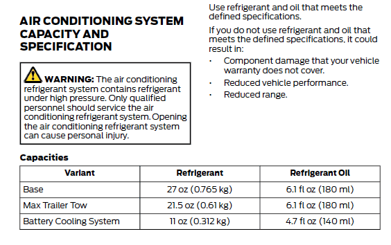

So just got back from the dealer. They topped off the coolant tank in the frunk. I had them take a look for any codes on the Max Tow package compressor. There were none. The technician remarks indicate he pulled .276 kg freon from the system. He then filled it with .312 kg freon. After getting back home...I looked in the owners manual and it is confusing. It lists 3 variants with different freon levels. It lists "Base", then "Max Trailer Tow" and finally "Battery Cooling System". The Battery Cooling System shows .312 kg as the correct capacity. However, I have the Max Trailer Tow package and I'm wondering if the correct capacity should be .61 kg?
He did find oil on the High Side service port cap and ended up replacing three schroeder valves (his spelling) So apparently there was leaking going on but no codes or MIL lamp.
As I ponder this...the Base variant gets .765 kg total. The Max Trailer package then gets .61 kg for the cabin, motors and all but the battery...then adds .312 kg just for the battery loop or .922 kg total for the two cooling loops. So need you folks to check my logic but if correct...the technician did fill the battery coolant side to the correct level at .312 kg. Right???

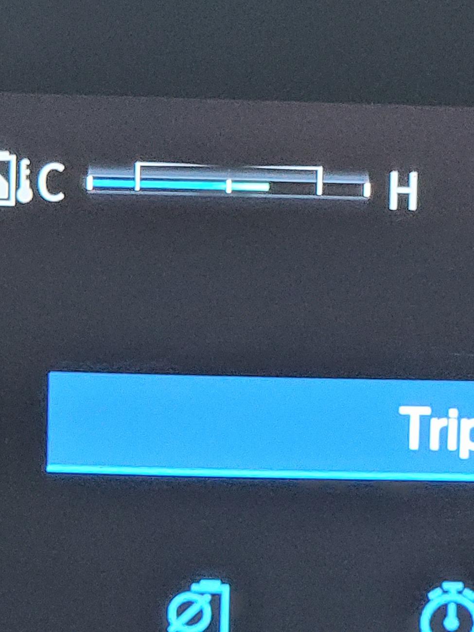

My truck is running higher than normal, I have never seen the temp gauge move past center. Las t few days the weather has been 105 to 110 and now I have seen the guage half way between center and the max. I checked my coolant level after a drive and level was even with the max fill line, checking this morning before driving the lever is the same. Shouldn't the level be lower when hot and my gauge showing higher temps?
Fluid expands when hot, that's why they leave room in the bottle, wait for it to cool once the heat wave passes, it should contract to a lower level
So even in the morning it will be at the max level? It is still hot in the garage, I would think fluid would contact a bit.
Under these hot conditions, it's not likely to drop much, is it possible the reservoir was overfilled on the last service? Ideally it should be just a bit over mid point fill line.
