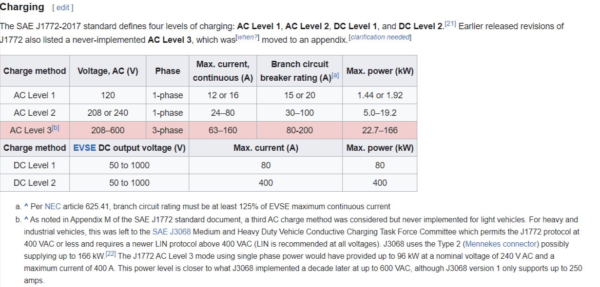

There are no Level 3 chargers available right now according to SAE. There are Level 1 and 2 AC chargers (what you normally find at your home) and Level 1 and 2 DC Fast Chargers. The requirements for Level 3 on each are still undefined.

I stand corrected! Just checked and AC Level 3 HAS been defined.
Ford F-150 Lightning Stranded! *temporarily (DC Fast Charging Issue?) 1679017294062
You can't buy one, but it has been defined.
