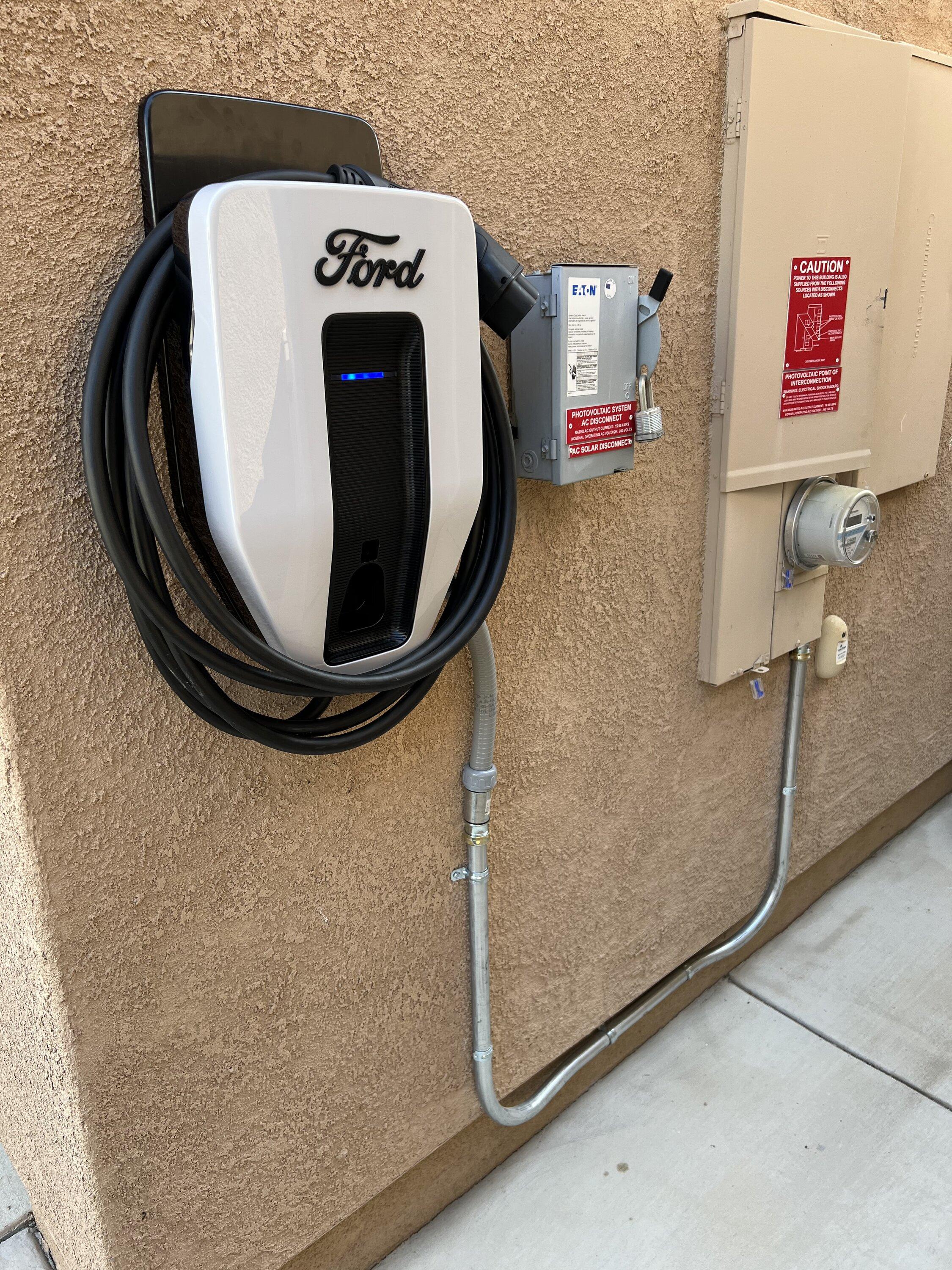

Today the Sunrun contractors came and installed the Ford Charge Station Pro. The contractors were ontime and installed in about 2 1/2 hours! After install was complete they showed me what was done and it was then he mentioned that they installed the 50 amp circuit inside panel and now the charger is ready to charge at 37 amps! I said what?! This charger is only on a 50 amp circuit?! I already have a dual charger on a 50 amp circuit! He informed me my panel would need serious upgrade to have a 100amp circuit installed as my home has a 200 amp. He was doing his job so I thanked him for the install and went inside furious that I was not informed by Sunrun that a 50 amp circuit was what I was paying for. Hell no! If I had known that a 50 amp was what would be installed, I would not have paid $1650 for the install! I already have a dual 50 amp charger from pervious evs we owned and the current MME! The contractor told me that he was given that directive by Sunrun! The charger is dialed down to 4!🤬🤬🤬
I have sent emails to the rep who sold this and the contractor contact at Sunrun and have been told that for their further customers they will give them more info on what and how their chargers can be installed prior to purchase. Before I purchased the install package, I was told to upload pictures of my panel and the existing dual charger I have. There was not a single person who physically came out to inspect and brief me on the install. I have asked them for a refund as I am furious about this!

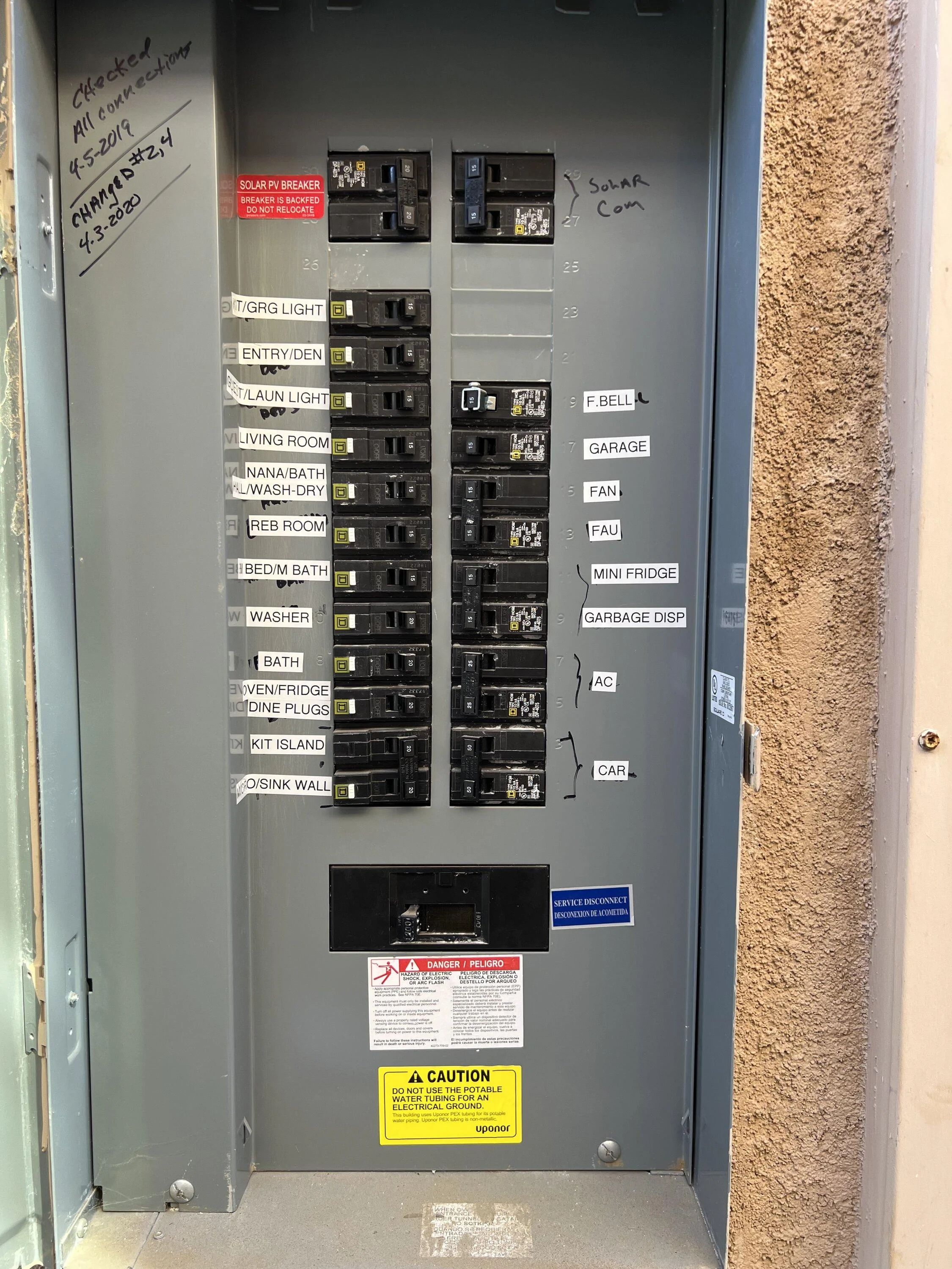

Do you know how many breakers you have inside your panel? That really is going to be the determining factor as far as the electrician goes. I dont think you should get a full refund, sans the electrician ripping out what he installed.
If anything its a simple switch from 6/4 to 4/4 and a breaker swap depending on if conduit was used. Thats atleast what I would ask for from Sunrun. Its just bizarre to me that some random person can install a FCSP with access to your breaker box without you approving it. They would have to break into them here in LA or the house.
This is before Sunrun install
Ford F-150 Lightning Sunrun did not inform me that I was paying for a 50 amp circuit! C9CC0E52-5139-4879-A6BC-3C89B75D9663

So I am just going to say that I also would not install a 100 amp breaker in that panel unless the 50 amp car charger was removed. Panel upgrades are not a big deal, just a lot of tedious work getting everything mounted and nice and neat.
I would highly recommend thinking about a panel upgrade that gives you more breaker slots. Just my opinion, but I rewired my entired house, swapped my old panel with a new one and I have an outside sub panel.
My deal with Sunrun is why was I not informed in the beginning before payment that could be the only option! There were many more pics I submitted so they had all the information necessary to give me that choice. Also if someone could have physically inspected before the purchase of install🤬
