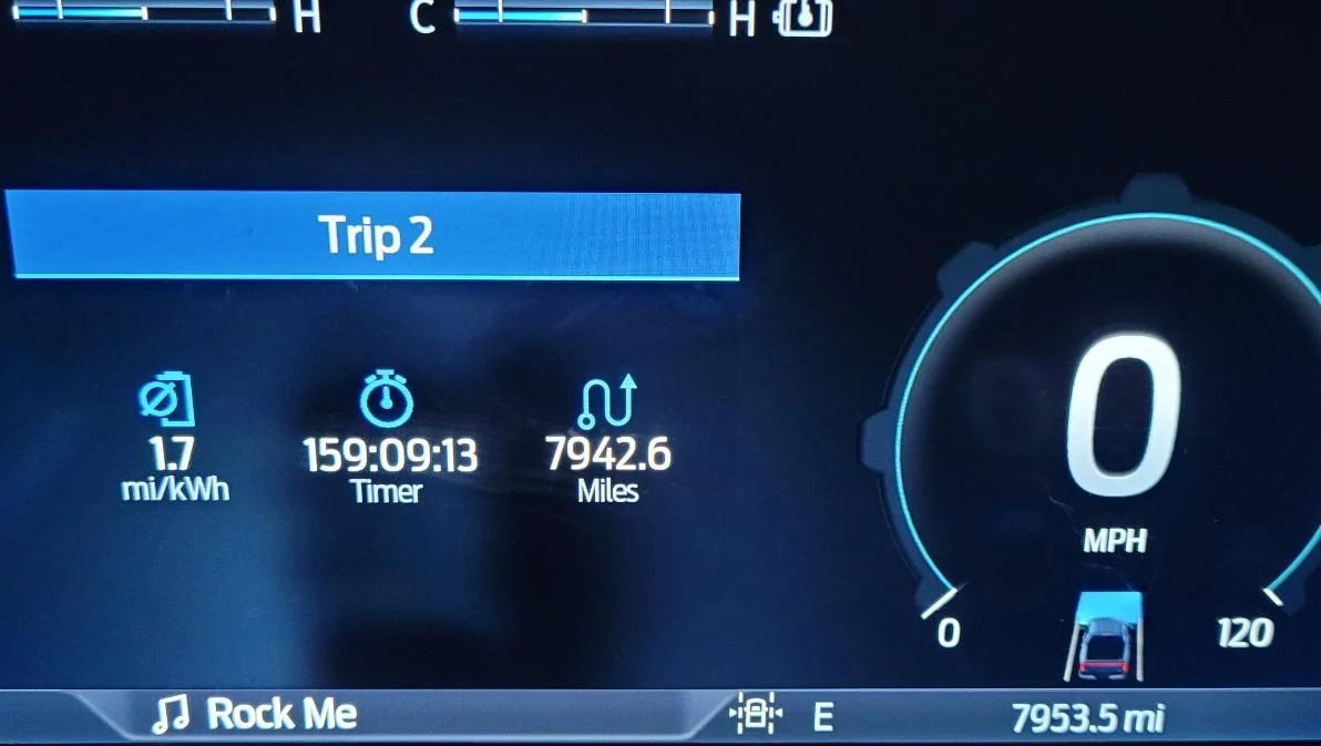

I've added "Trip 2" back in the mix....so i can reset it as desired.
Shouldn't have to though. :rolleyes:

I have noticed the "This Trip" issue since my truck got the update 4.1.3. The break pedal trick did work when you turn it off before. I thought it was just me, until this morning.

I want to leave Trip 2 alone so I have a lifetime consumption number.
I would of as well, but some how it was reset. My guess is that it reset after an update, as both trip 1 and 2 were identical, but not the same as my mileage at the time.
Could of also been the wife...

I guess I need to check it. I sure hope an update didn't reset it.
On one of my dealer service visits, they did a master reset. That resets most everything except the odometer.

Yeah. I can confirm that no updates (so far) have reset the Trip counters. I'm up to date with 4.1.3.
