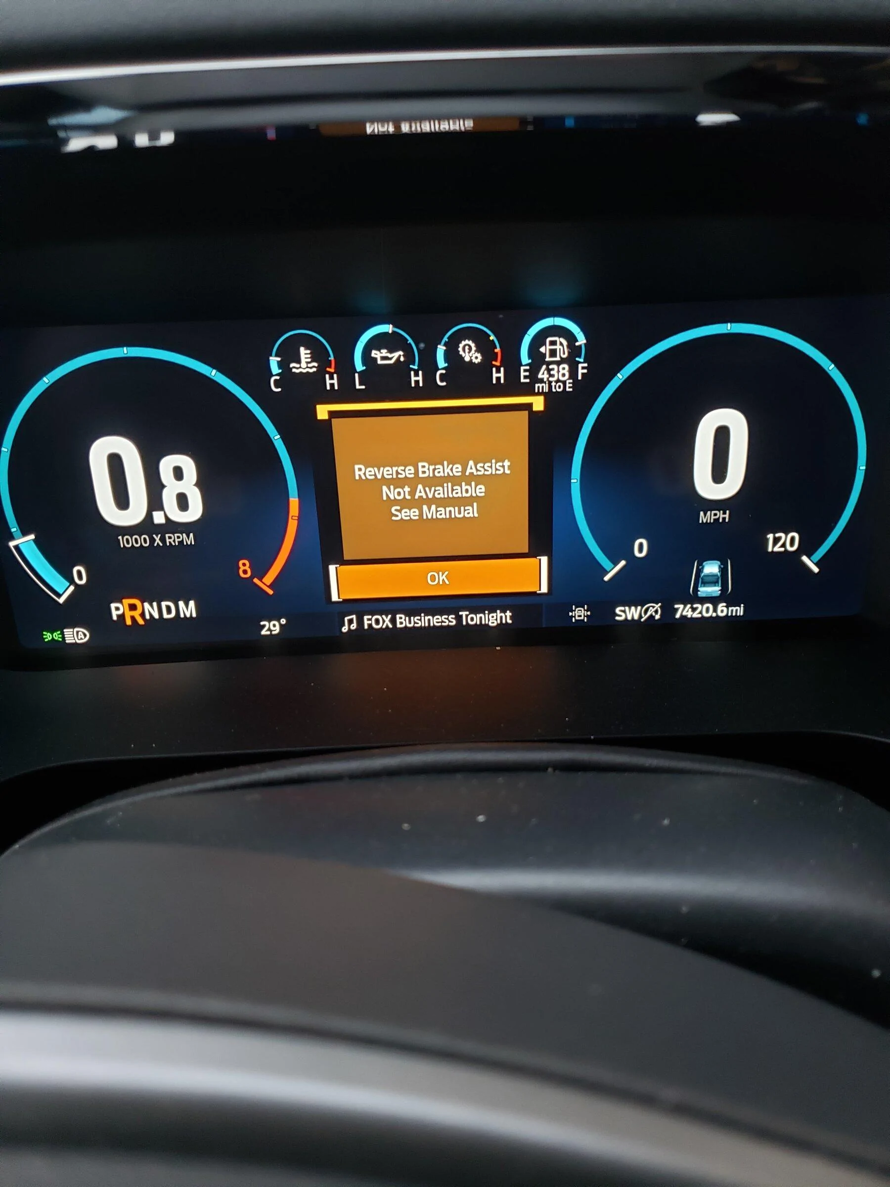

Same thing here! Intermittently fordpass responds, "vehicle is in deep sleep mode", so no remote start at 10 degrees! Sometimes no approach lighting with interior lights, other times approach lights come and no interior lighting, or Sometimes neither. Also now I'm getting Intermittently "reverse brake assist not available " . At this point I would prefer to have it as it was prior to the attempted updates. At least everything worked. This seems to be going downhill fast, and I fear the update will come with its own new set of problems.
My app also displays the same message now. I had never seen it before the last couple of weeks. Not sure if that’s an indicator of anything at all. Lol
