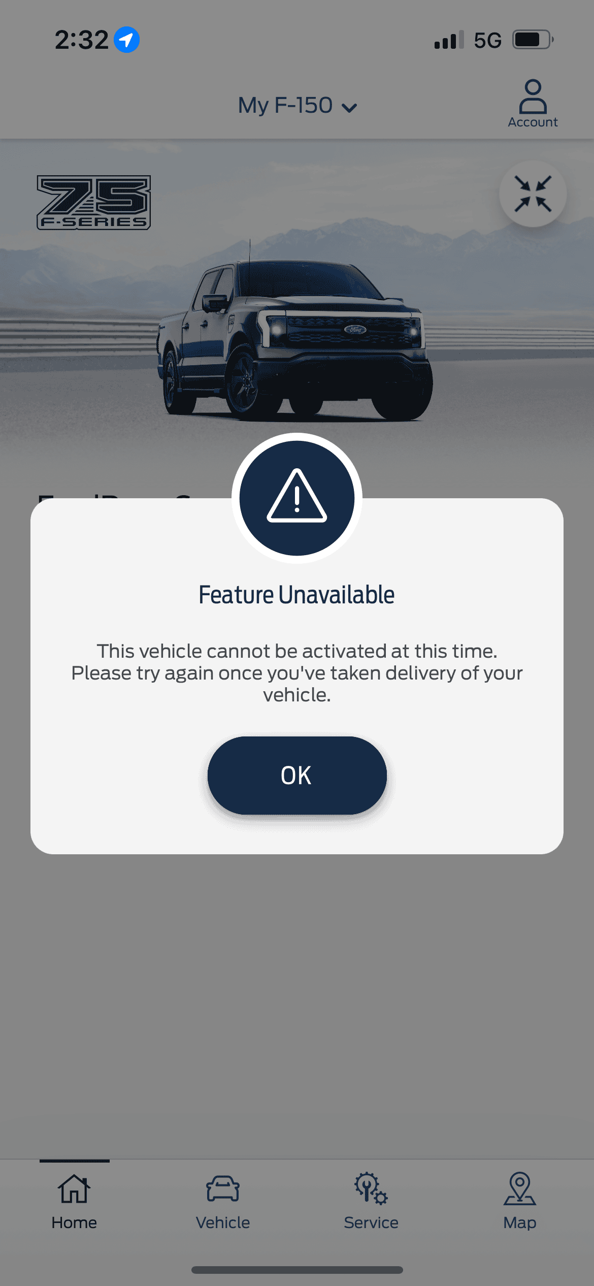

Took delivery of my 23 in March. Still no solution for FordPass app. Been to the dealer a dozen times and they haven’t been able to fix. I’m at my wits end. Any help would be greatly appreciated. This is the message I get in the photo. Dealer reassured me the vehicle is not in deliver mode.

What steps are you doing when this message appears?

I’ve tried 12v battery disconnect. Not sure what more I can do.

Reached out to FordPass support they tell me the dealership needs to resolve the issue, nothing they can do. Dealership has no clue on how to fix it. Tried several different phones no luck.

Call and ask for the BEV team, and get a case number. Looks like the dealershipnever reported it sold.

Thank you RickLightning. Didn’t know such a thing existed. I’ll try first thing Monday morning.

The dealer should have had this set up and working before you drove away from the lot. My FordPass was working before my wife drove her MME off the lot as well as my Lightning. This is standard delivery procedure for the dealer. You'll need to get the dealer to complete their sales process on the truck, including the setup of FordPass
