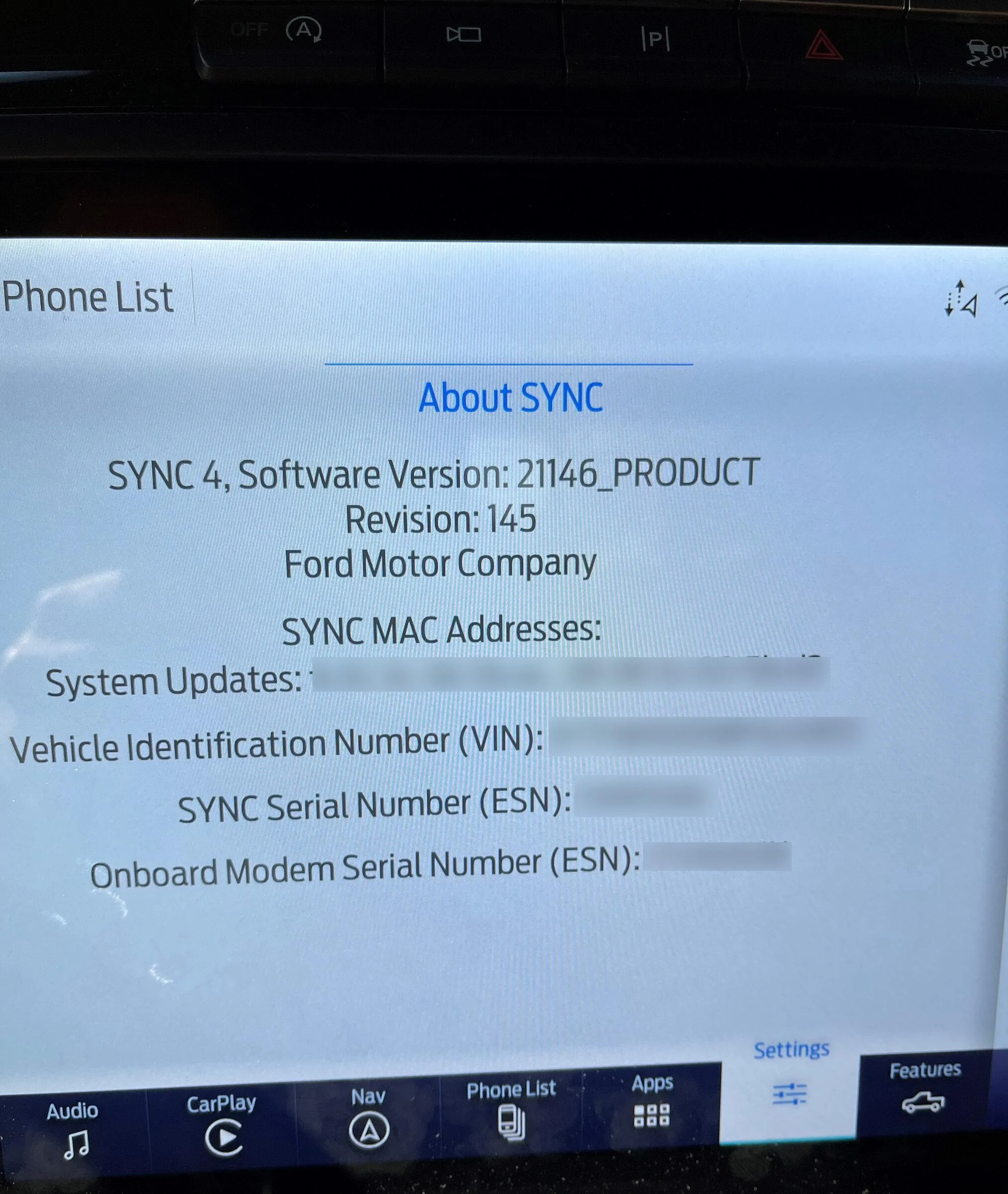

My truck has been to the dealer 3 times for the OTA update failings. I spoke to Ford tech and they told me that what the server configuration of the truck didn't match what was actually installed in the truck(modules).
They wanted the dealer to upload an updated truck configuration so Ford could update their side of it, but they had no clue as how to do that.
Then the dealer told me they were able to update it but when I picked it up still had the shipped versions. Still on power up 1.4 but the Ford pass app says I'm at 1.7.1.
I'm sending pic of all the screens to the dealer so they can supposedly get with Ford tech dept as to find out what the issue may be with updating.
I have a bunch of quirky things happening with connections with my phone. The recirculation setting keeps turning itself off and a few others.
