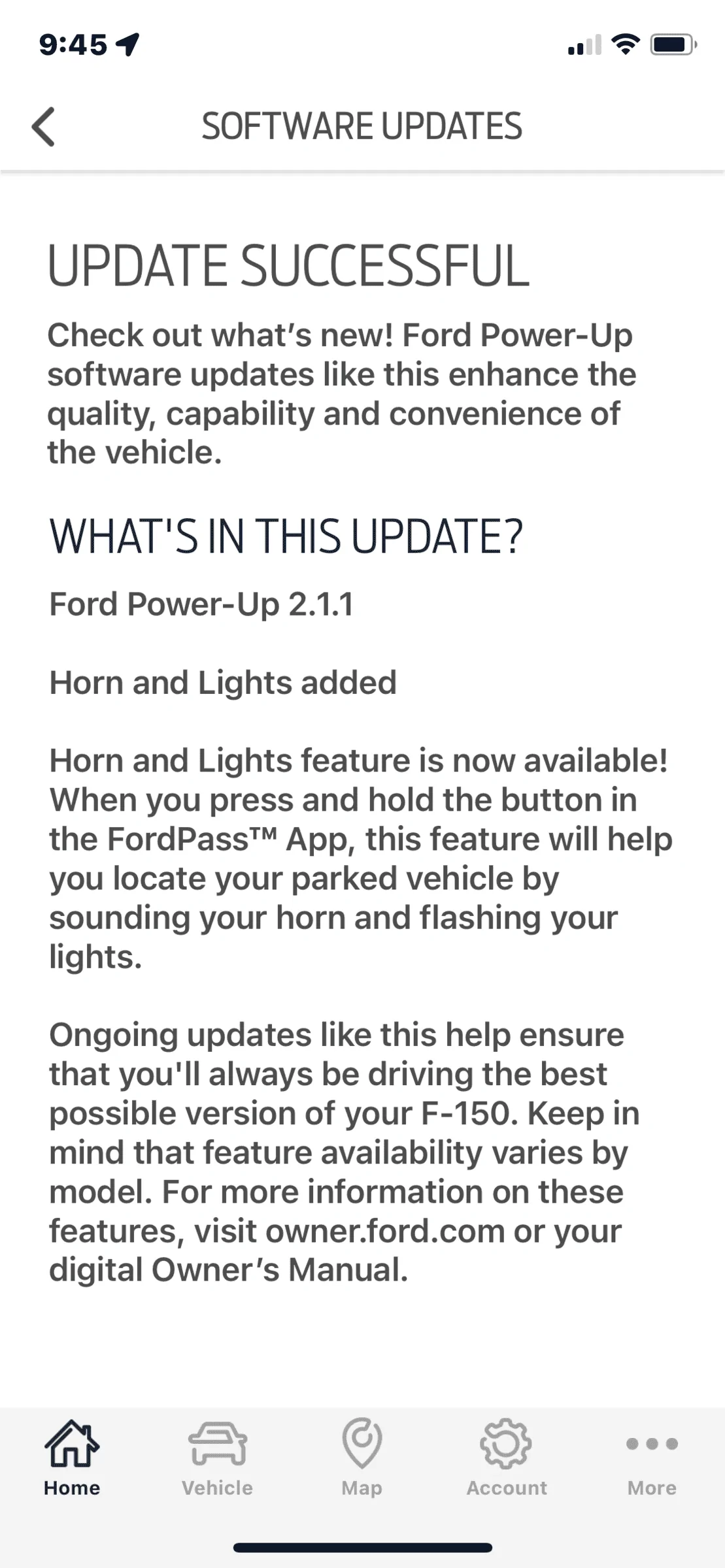

I supposedly have updates scheduled for early Sunday mornings… but I got a notification tonight that Ford Power-Up version 2.1.1 was installed. Funny, the only change they mention is lights/horn which was in 1.7.1.

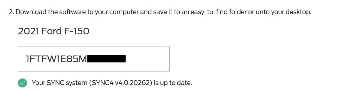

Mine says I am at 20262 and is up to date ?!?
Little background here: After lots of troubleshooting I found that my truck failed to download and install the 1.7.1 PowerUp OTA update. My update screen is greyed out and Sync version is not showing up on the screen. I have tried to manually update my Sync over USB, the installation starts, prompts for restart but never finishes. I have read somewhere that Ford is suppose to issue an OTA fix for failed 1.7.1 OTA so I am deliberating between waiting for it or take the truck in and have my APIM replaced.
If there is no actual issues. I’d just wait. Mine failed also but it works fine so I’ll wait.
Where did you find updated frimware ? I thought someone said its not possible to manually update over usb at this point
It is, if you have access to Ford Diagnostic an Repair software. The tool will create an update USB flash drive that you can use to update your SYNC. After lots of trouble, finally I managed to update it today!
Ford F-150 Lightning Took truck in because it has never received an OTA update. Service was clueless sync
BTW - if you take your truck to the dealer, they will do exactly the same procedure.

I never got any notification about a Software update, but I do see Lights & Horns now in the FordPass App. I guess I am on PowerUp 2.1.1
