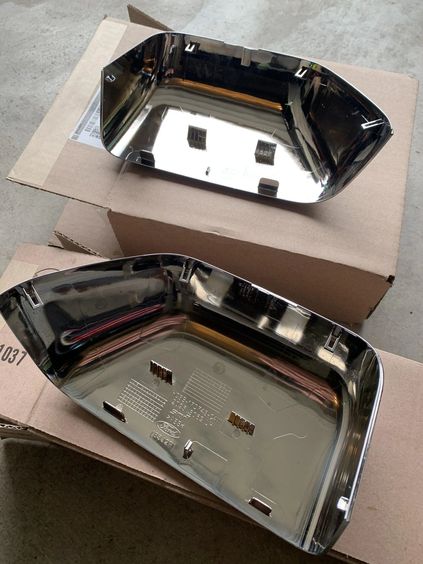

The chrome ones came off completely, the dealer did it for me. I have them sitting in a box, so I don’t know if the tabs are still in tact. I’ll check later today.
Here are the back side of the chrome which came off, looks like they stayed perfectly in tact.

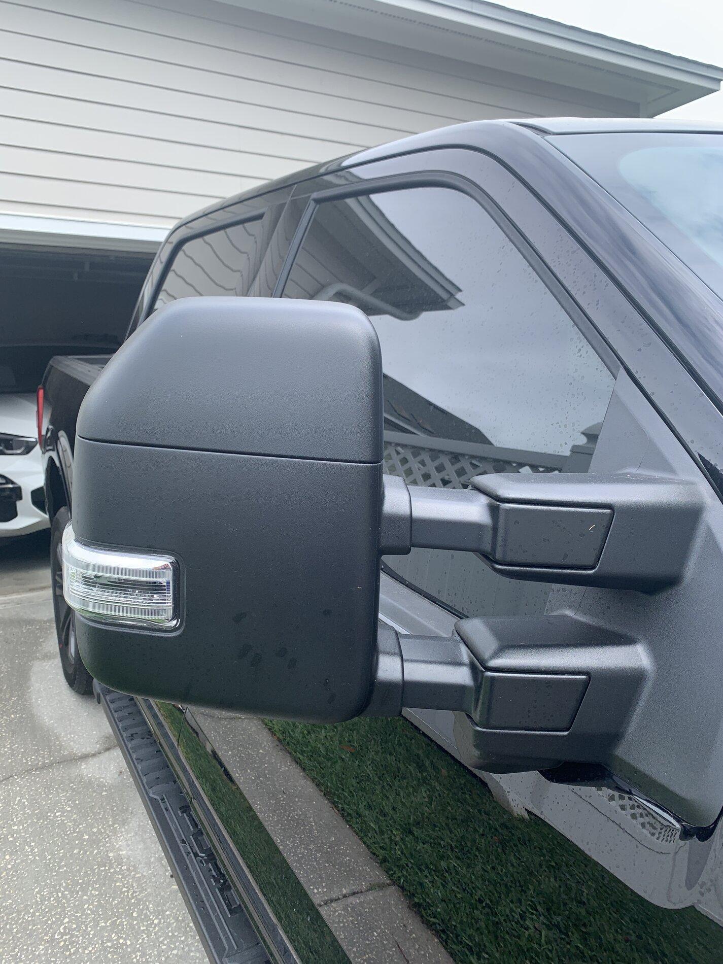

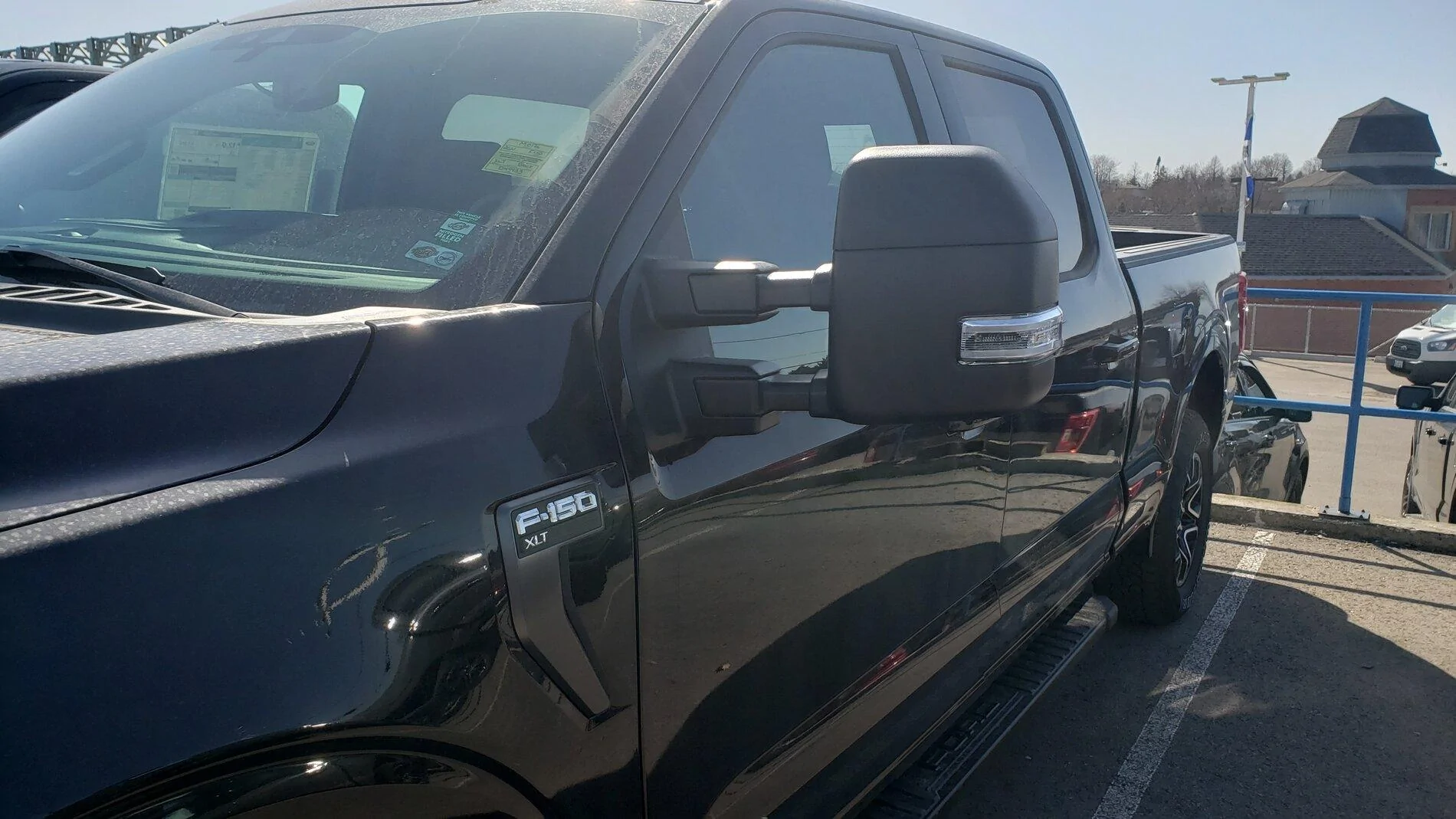

Cruising the lot this afternoon saw this xlt sport with black tow mirrors.
lariats and above get the chrome no matter what...sport package or chrome package.

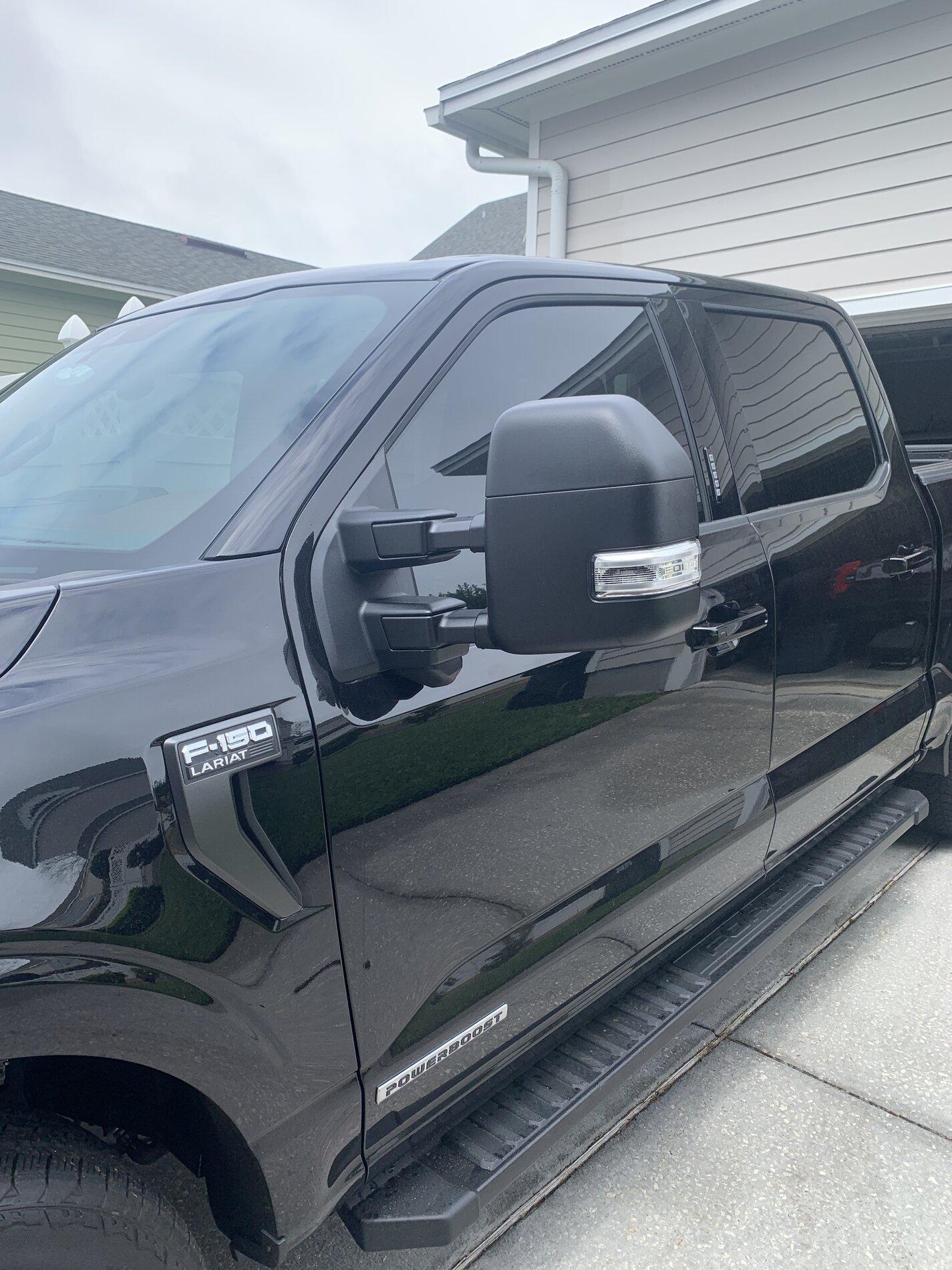

My black skull caps came today...I ordered yesterday...I’ll post pics after install.

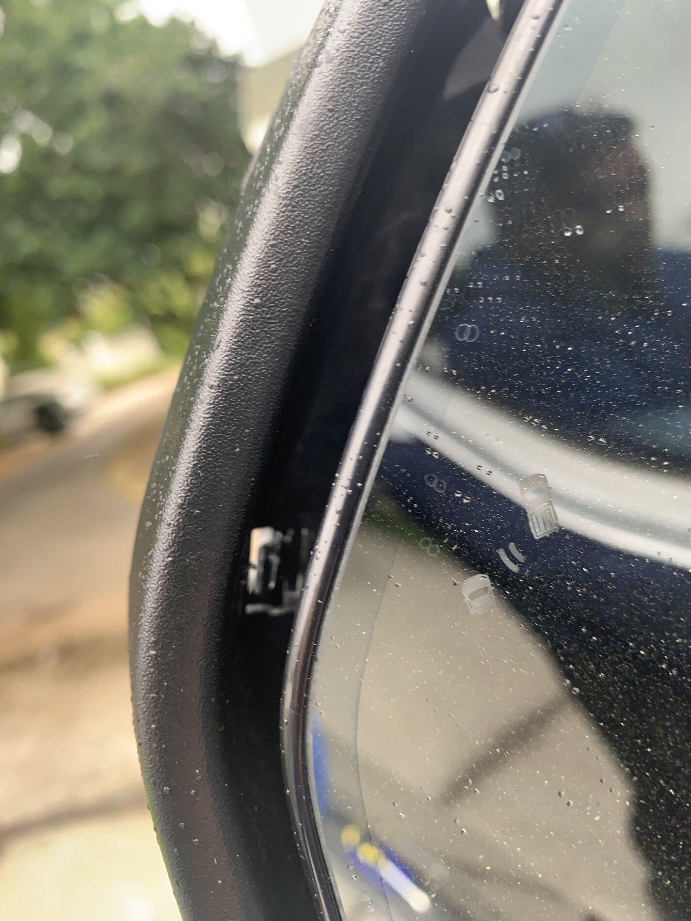

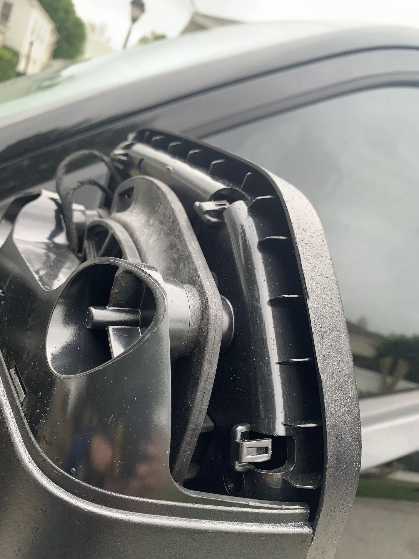

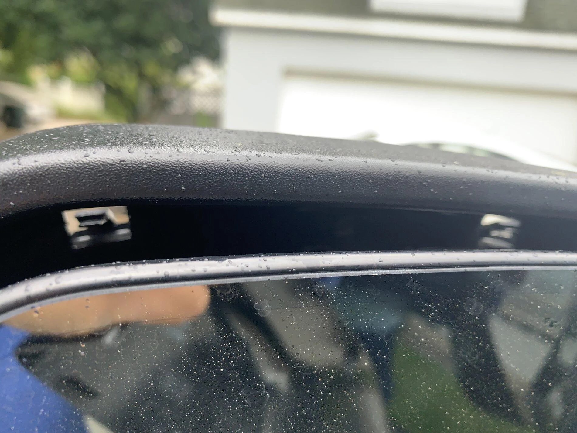

Relatively easy removal of the chrome caps by pushing 3 tabs with a flathead screwdriver (a few pics of the tabs)...there's a 4th tab in the middle which can't be reached and did break off when I took off the chrome caps. Maybe MrTrav's installer did a legit removal and disassembled what was needed to access.

Looks like they broke the middle bottom clip on the top one.
Yeah, not sure if it’s broken off or not. Who knows if it would clip in and be secure with the other ones in place.

$49 for both including tax and free shipping. It came next day. I guess the dealer I ordered from had them in stock. Don't have a dealer install if it's not free... it's a very easy install...takes 5-10 mins tops. BTW one of mrtrav's middle tabs is broken. I'm pretty confident it would install securely with the other tabs in place.
