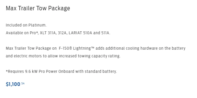

I don't ever, ever plan to do this but maybe I'm in a situation where I need to tow a few hundred pounds over my truck's 5000 lb capacity. Would one just keep an eye on temperatures on the gauge and keep off the highway when possible?
I'm curious here partly for preparedness, but also because the only thing that seems to separate my trim from max tow (providing 7700 lbs) is additional cooling. Lightning's all seem to be structurally built to a 10,000 lb towing capacity regardless. And I haven't read anything that says the brakes are stronger on one trim level than the other.
212
15,656
17,527
What is the Ford F-150® Lightning® towing capacity?
The F-150® Lightning® XLT and LARIAT models have a maximum conventional towing capacity of 10,000 pounds.
Models featuring the standard range battery can tow up to 7,700 lbs. *
*Max towing on XLT and LARIAT models with available extended-range battery and Max trailer tow package. Max towing varies based on cargo, vehicle configuration, accessories and number of passengers.
I would watch the motor & battery temps, the Max Tow package helps keep temps under control in the worst of conditions, if you don't have that option, you're not likely to encounter a problem unless pushing the limits and duration in hottest climates, driving slower can help control the situation.
