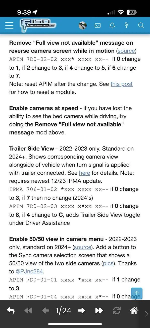

Trying this here on Main. Back in Oct 2024, I test drove a dealer truck, and did a small tow test with my tent trailer. I noticed that when I turned on the turn signals, it automatically showed the camera view for the side views of the vehicle....super handy.
Fast forward to now, and I recently test towed a bigger travel trailer with my own 2024 flash trim. But, when I put on the turn signals, there was no camera view automatically turned on.
Anyone know how to enable this back on?
