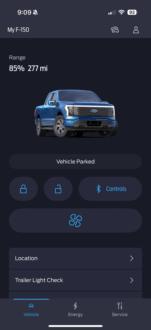

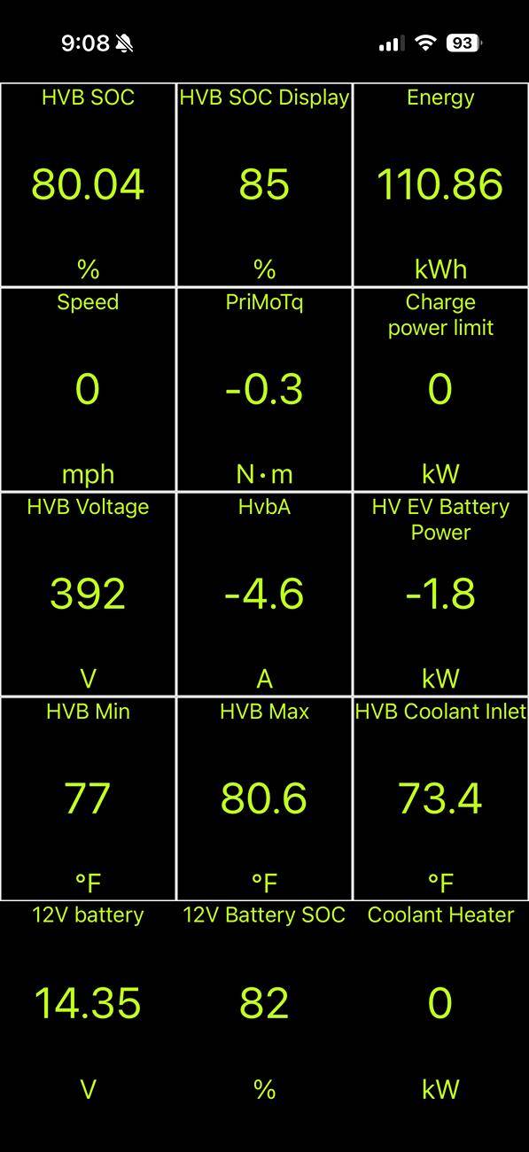

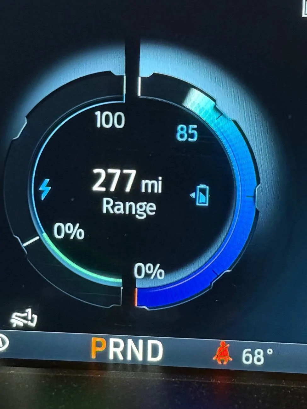

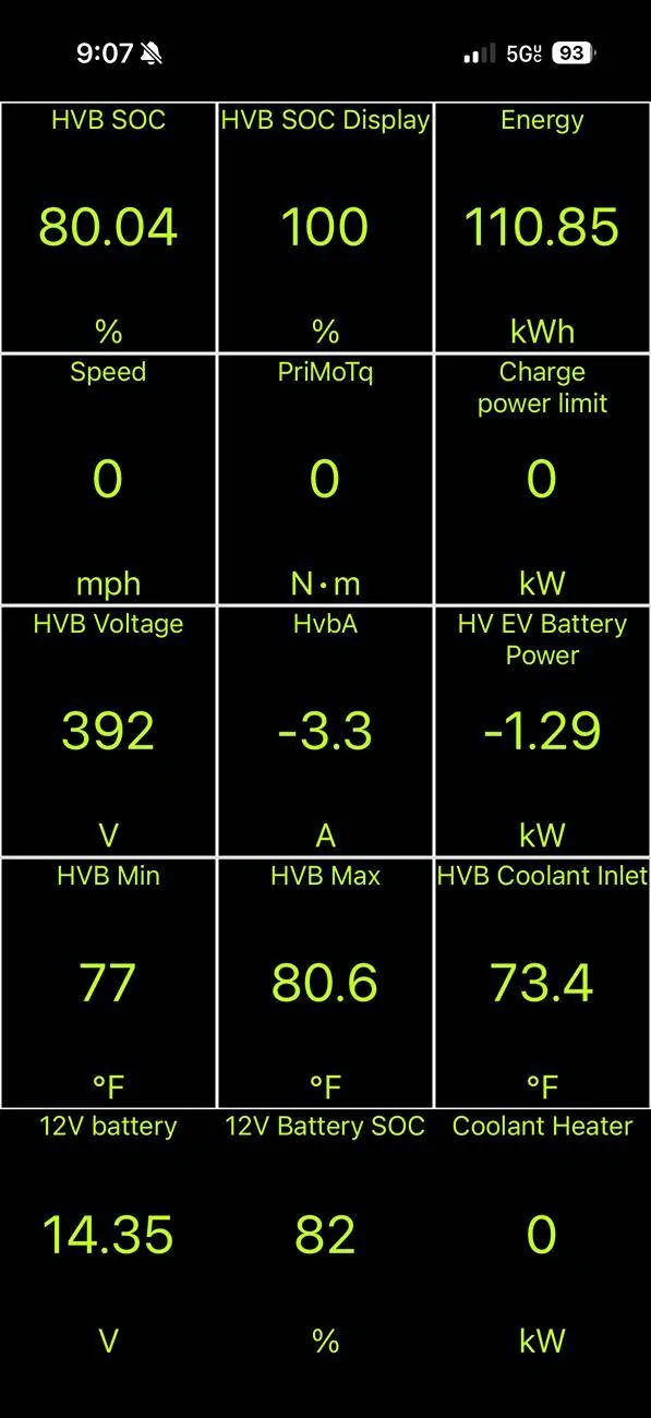

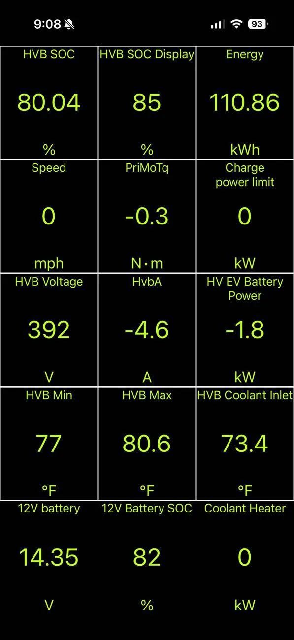

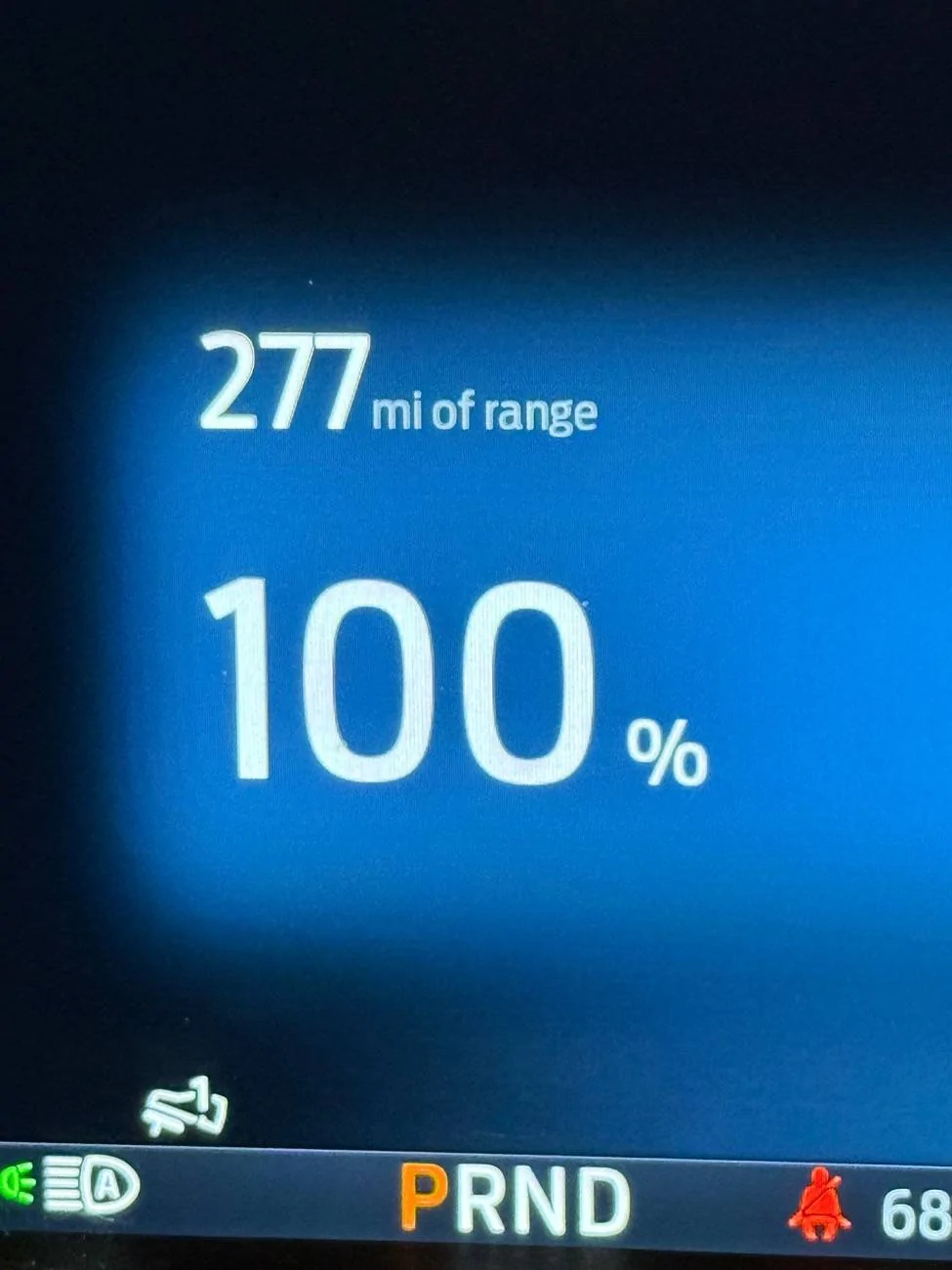

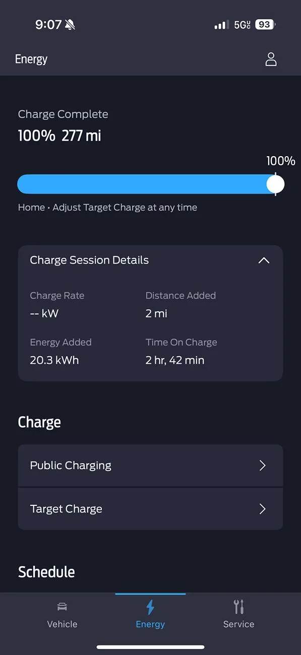

So my truck refuses to charge past 84-87%. As you can see, it is set to charge to 100%. The vehicle “thinks” it chargers to 100%, as soon as you unplug and turn the truck on, it immediately drops back to that 84-87%.
No errors shown in the vehicle or ford pass app.
To troubleshoot all charging location profiles have been removed. There is no schedule charging on either the vehicle or charger side. I have verified the issue continues on my L2 48A hardwired charger (ChargePoint home flex), ford mobile charger on a NEMA 14-50, and a DCFC.
Has been in service for 24+ days now and been escalated to Ford Engineering and their “token based advanced log gathering”
Anyone else having a similar issue?

I often scroll down on these threads and you will see a section called Similar Threads. There is one from @WileyKyle from 2023 that is almost exactly like yours. Unfortunately he never posted the outcome. But others on that thread suggested bad module.
I agree with @CurtisW , take a look at the HVB SOC module variation (%). Mine stayed under 0.6% until a module went bad and it jumped to over 4%.

I realize it's it the shop but maybe you screenshot the other screens as well.

I noticed the problem when module SOC variation was above 7% it was almost at 9% when I took it to the dealer. Initially wouldn't charge past 88% and then every few days lost another % until it was at 85% and I brought it to the dealer. My SOH was 99.5% with this issue and voltage variation was also very good. Prior to the issue my module SOC variation was 0.6% after the repair its at 3.3% but that's likely normal due to 1 new module and 66k miles on the others. MY SOH after the replaced module is 99%
