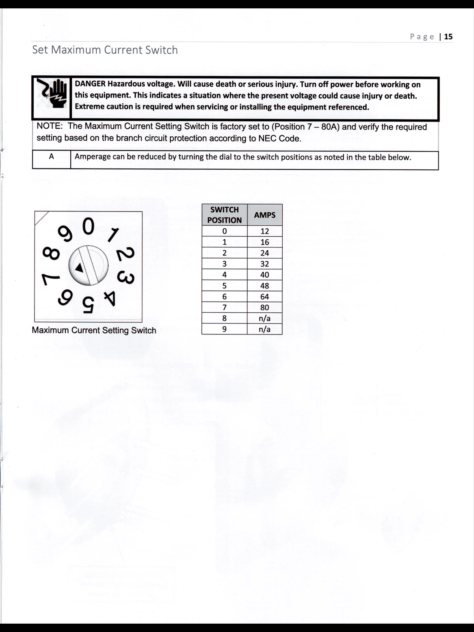

I have my pro charger hooked up to a 50 amp circuit. I have it set to 4. How many amps well it charge at?
From the Installation Guide

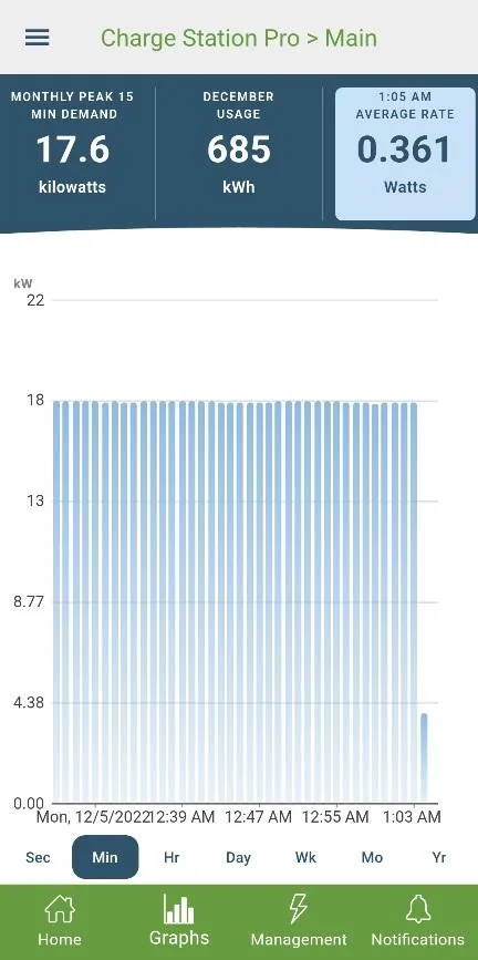

Not to go off topic, but had anybody ever seen anything close to that? I've never recorded anything over 17.5 to 17.6kW.

Not to go off topic, but had subordinate ever seen anything close to that? I've never recorded anything over 17.8 to 17.9kW.
The 19.2kW is peak output - 240V * 80A = 19,200W.
Your 17.9 is probably about where it should be after efficiency loss of about 5 ~ 7 % on the charge process under normal conditions. 17.9 / 19.2 = 0.93229 or 93.23%
I was just saying that absolute peak, possible output is 19.2kW, which is much lower than DCFC charge rates, so the charging rate doesn't need to be slowed until close to the end or target charge level.
