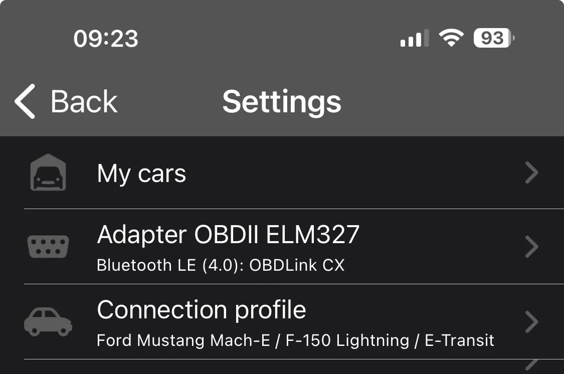

It is probably just user error, but for the life of me, I can only select F150 BEV profile, and it only reads out useless F150 ICE data on the diags, etc. Is that the right model to select, or is there an entire different profile I should be using?
I use the Mustang Mach E/F-150 Lightning profile.
Ford F-150 Lightning Using ABRP, is OBD worth the investment? IMG_0659

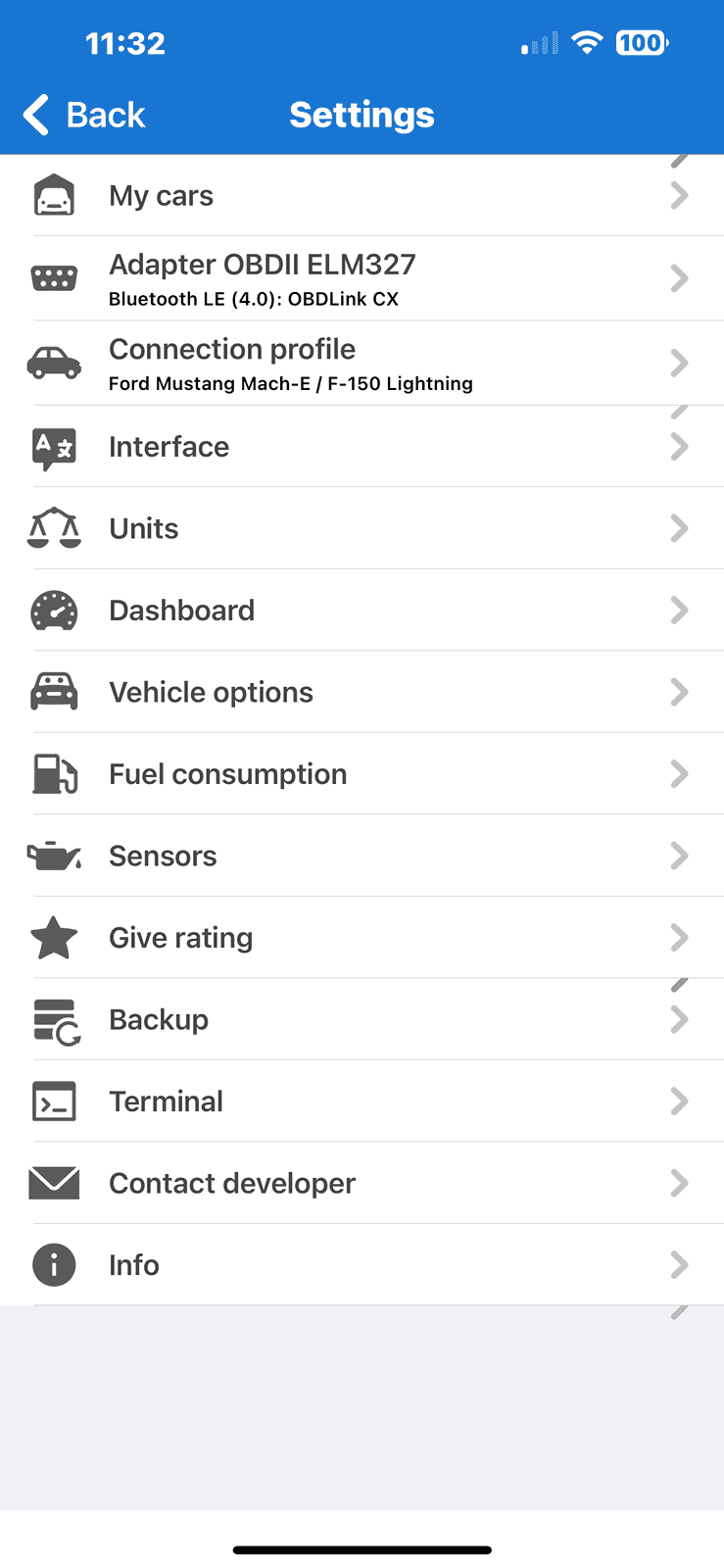

carys98 answered you too, that's the profile I use albeit my connection profile is slightly different in that it also references the E-Transit. That may just be an iOS vs Android thing. Regardless, yes there is indeed an absolute TON of EV specific data avaialble to you with the right profile.
Ford F-150 Lightning Using ABRP, is OBD worth the investment? IMG_2225
There must have been an update. I went through the menu again and now I have the E-Transit version. The old one is gone so I wonder if they just renamed it or if there are some new PIDs.
