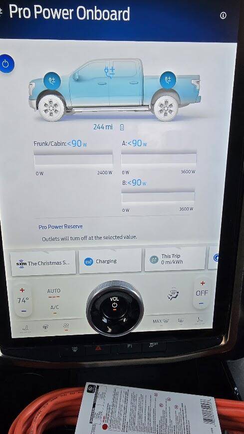

Using Pro power in the bed for an electric blanket?

it just seemed strange that it says there's power going there and nothing seemed to work.
All you've reported is that your electric blanket doesn't work when plugged into the bed outlets, yet it works in the house.
If you test the bed outlets with a meter or by plugging something else in like a trouble light, and they work, you have a problem that others have reported: some devices do not work on ProPower.
If the bed outlets actually are not working when Ford's software reports that they should be, then you can say "nothing works".
I've experienced the first type of problem. My old dremel zip tool that works anywhere else doesn't work at all when plugged into my 2024 Flash, while everything else I've ever plugged into the truck bed outlets, including my travel trailer, works.

Okay, so update for everyone. A lamp works in the outlets, a heated blanket doesn't. The heated blanket works in all the house outlets, but not the truck. It's not a special heated blanket by any means. It's just a twin size with 1e heat options, a button for on and off, and then a 1e hour off feature. Maybe that could be what's throwing it off.
Sorry it took so long to get that test proven right away. I really don't know if there is a remedy for this type of thing to be plugged in. I got it for a camping trip to keep warm (the lady) when we go out in the truck. Maybe other brands have different wiring and will work?

I tried that and it would work. I think the blanket has some odd features that doesn't work well with the truck. The lamp was also a dimming style lamp so I could change from completely off, to full brightness, no problem.

Yup, no luck guys! ?

I'll probably end up keeping this one since it'll work on her side of the split king bed!! I'll maybe do some online shopping though to see if there's another brand that is compatible. Maybe Amazon since they have a fairly easy return policy.
It does raise the question though, is it the blanket with the auto off feature that it doesn't like? Or, is it the amount of power needed to turn it on? ?
