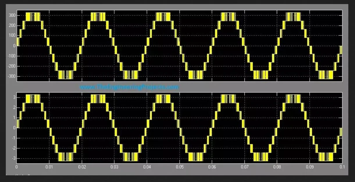

b) The first link said the bed outlets were pure sine wave on that truck and posted an oscilloscope image - however it was hard to really tell just how clean the output was from the image. I think to really see how sinusoidal the output is, the scale of the oscilloscope should be widened. Some modified sine waves can appear to be "clean" at one scale but on closer inspection the small steps can be seen. Some modified sine waves are cleaner than others.
[EDIT: or maybe the truck he has is not 9.6kW ProPower, but the 7.2Kw version with only one inverter? Does the 7.2Kw provide 120vac outlets in the bed?]
Ford F-150 Lightning Using Pro power in the bed for an electric blanket? modified sine wave inverter output
2) The second link is a long winded explanation of the problem when the neutrals are bonded (grounded) in two places, source and load, which causes a GFCI trip. But the OP here did not have a GFCI trip as far as we can tell from the posts. Other people HAVE had the GFCI trip when using tools, like a Dremmel which I believe is RF noise created by the tool causing a current to be induced in the hot/or neutral detected as a ground fault current.
So I still think the problem is a dirty sine wave from the bed inverter and it could be because the inverter that powers the bed circuits is bad and should be replaced under warranty. Or maybe the bed inverter by design does not produce as perfect a sine wave as the front circuit inverter - I am not convinced yet by the first link that the sine wave from the bed is "clean."
