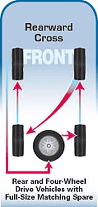

While I don’t know what’s in Ford’s head, there are several reasons companies and customers may prefer a “full sized non-matching” spare over a “full sized matching” spare. Yes, cost and vehicle weight are reasons. But other reasons include that for changing a tire a lighter spare is that much easier to deal with.
Another reason is that the benefits of a full-sized matching spare (i.e., being able to simply use it in the event of a flat), require some onerous and maybe unexpected efforts: namely, it should be rotated into the tire rotation schedule, so that it wears in the same way and at the same rate as your other “matching” tires. And getting that 5-point rotation correct is a bit of an unfamiliar dance for not only owners but even some tire shops - and the correct 5-point pattern depends on front vs rear/4-wheel drive. (Jeep Wrangler owners with big beefy matching spares are supposed to be doing this, but I doubt many do.) And when it’s time for new tires, you’re buying 5. And if you have directional tires, forget about it altogether (the 5-point rotation doesn’t work here, as I understand it.)
So, given the relative rarity of flat tires for the majority of drivers, the full-sized non-matching spare actually achieves a lot of efficiencies for average owners vs a matching spare. It’s easier to handle when changing a flat roadside, it’s cheaper to replace, and it just sits there until (rarely) needed.
It can be done but two tires have to be dismounted and remounted each time.
