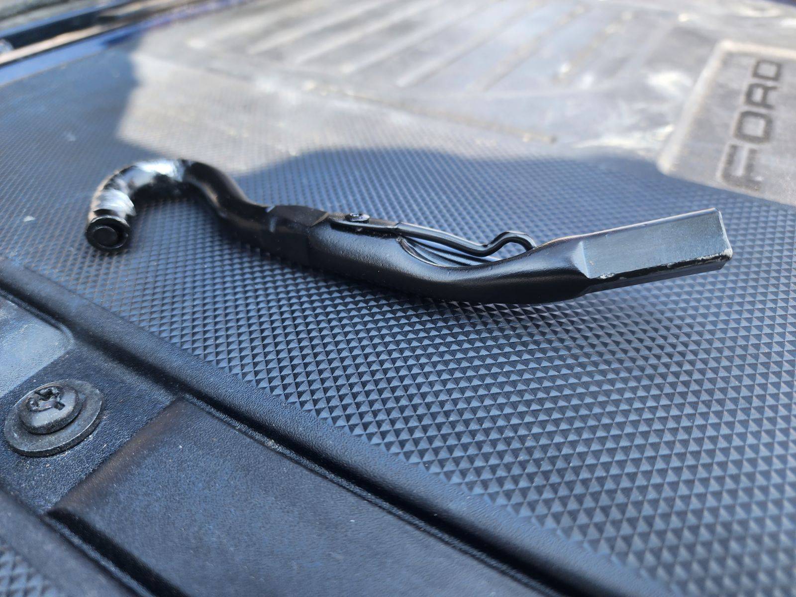

I had a flat as well during the summer. Front right and when I used the jack, it twisted twisted like a pretzel, could not lift the vehicle at all. I contacted ford to let them know and they ignored my email so I gave up. I will rely on road assistance IF it happens again.
Not very user friendly, if you don't have the handle straight then it will bind and you end up twisting the shaft. Has happened to several users.
