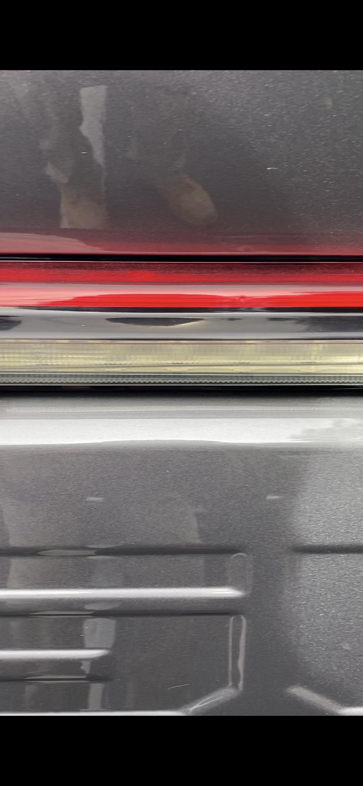

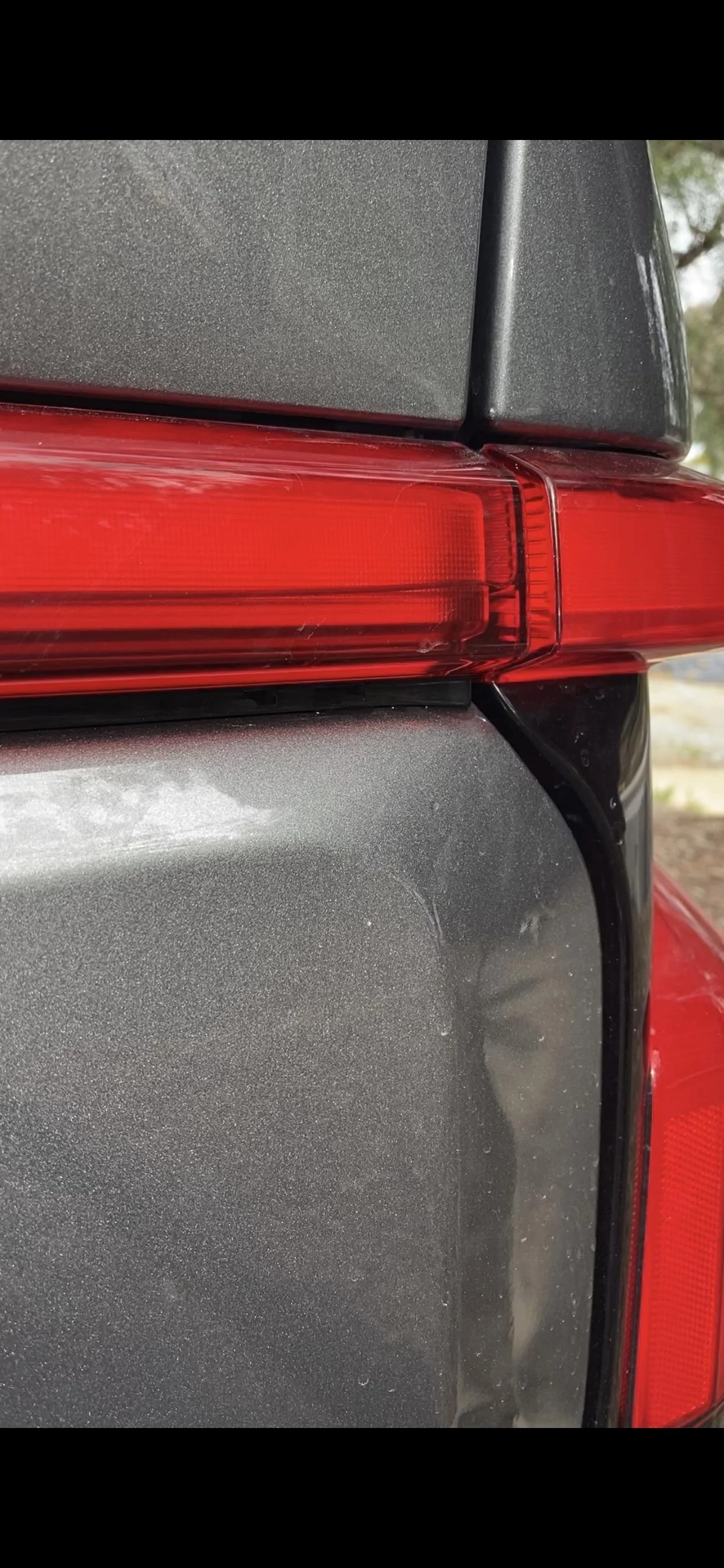

I noticed a problem with mine a few months ago, only thing missing is a trout to swim around in the lake inside my light. I went to the dealer they told me the taillights were back ordered. They ordered it two months ago and I’m still waiting, frustrating they can still build trucks and put them out but they can’t fix my tail light on the truck I already paid for.
