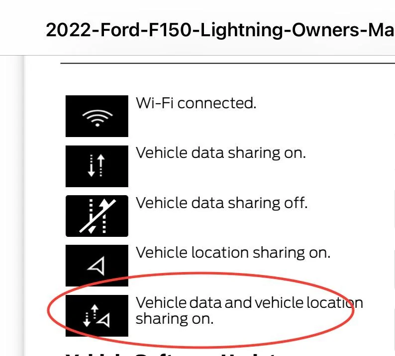

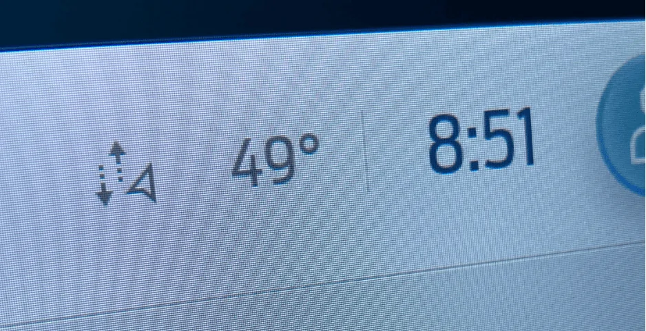

This.It's the icon for Connected Services - the inbuilt cell connection the car uses for Bluecruise, updates, telematics, etc. If the icon appears it means the car is connected to Ford's servers.
Is there a way to get the icon to show up? I looked in the settings under Connectivity -> Connected Vehicle Features and nothing is listed there.The connected services icon is definitely key to getting OTA updates. My truck only started showing the icon on every drive after I did a round of FDRS updates a few months ago. Prior to that it was not consistent and showed up about 1 out of every 5-6 drives and I was NOT receiving OTA updates in a timely matter. Which was why I using FDRS in the first place.
Now the icon is displayed on every drive and so far I have received the most recent updates just a few days after they are reported here on the forum.
yea, that was the same issue I had. When the icon didn't show up the Connected Vehicle menu was blank. I had to turn the truck off then on and then sometimes it would appear.Is there a way to get the icon to show up? I looked in the settings under Connectivity -> Connected Vehicle Features and nothing is listed there.
Known bug.I looked in the settings under Connectivity -> Connected Vehicle Features and nothing is listed there.

Can anyone tell me what the icon to the left of the temperature is? Can’t find any reference to it in the owners manual. Thanks in advance.
