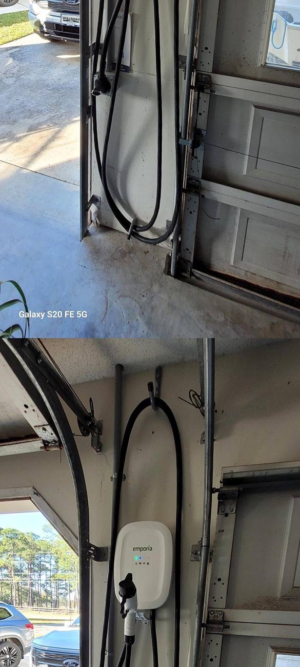

I've been using the Emporia charger for about 6 weeks and find it works as advertised but I don't have anything to really compare it to. It charges at the advertised 48 amps/ 11 kw. It comes with a NEMA 14-50 plug already attached that allows up to 40 amps / 9.6 kw. It's easy to convert to a hardwired arrangement to get the full 48.
The biggest complaint that people seem have is the diameter and weight of the cable and the adapter holster but that is supposed to be updated in future versions. I hang my cable on handlers from the ceiling so it doesn't affect me. The adapter hangs right beside the charge port.
I also use the Emporia home energy monitor so it ties right in to that.

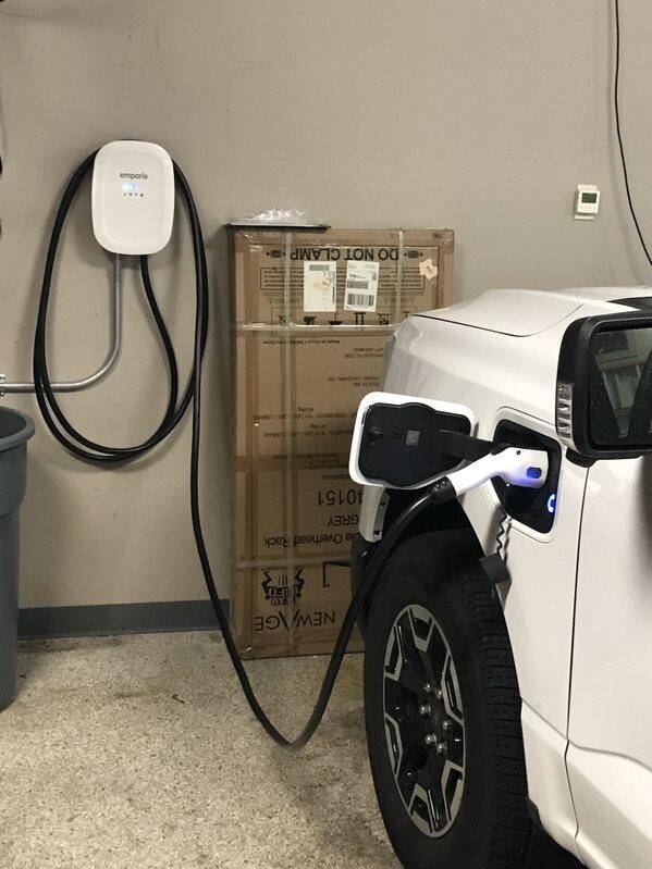

With my Emporia, I just loop the cord over the top of the unit. Mounted on the wall at back of garage between the two stalls.
Ford F-150 Lightning What Level 2 charger do you recommend 1733066961054-w2

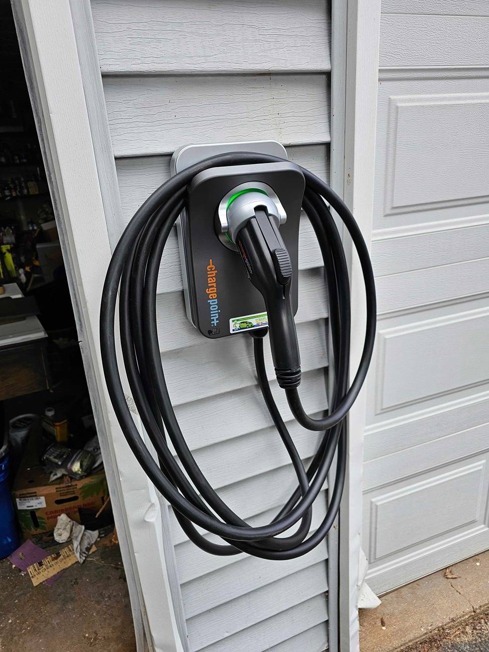

Another vote for the ChargePoint Home Flex and especially for checking with your power company.
My power company (Eversource CT) gave me a $500 rebate for the charger, almost exactly what I paid for it, and an additional $1k for having it professionally installed. I also get a small discount on my monthly bill for charging during off peak hours. In a 100% electric house every little bit helps :-/
I'm running it on a 40A breaker with 32A rate limit because it replaced an older charger that was already using the same circuit.
Edit: Adding photo since we're apparently doing that too.
Ford F-150 Lightning What Level 2 charger do you recommend ChargePoint Home Flex Charger - Copy
