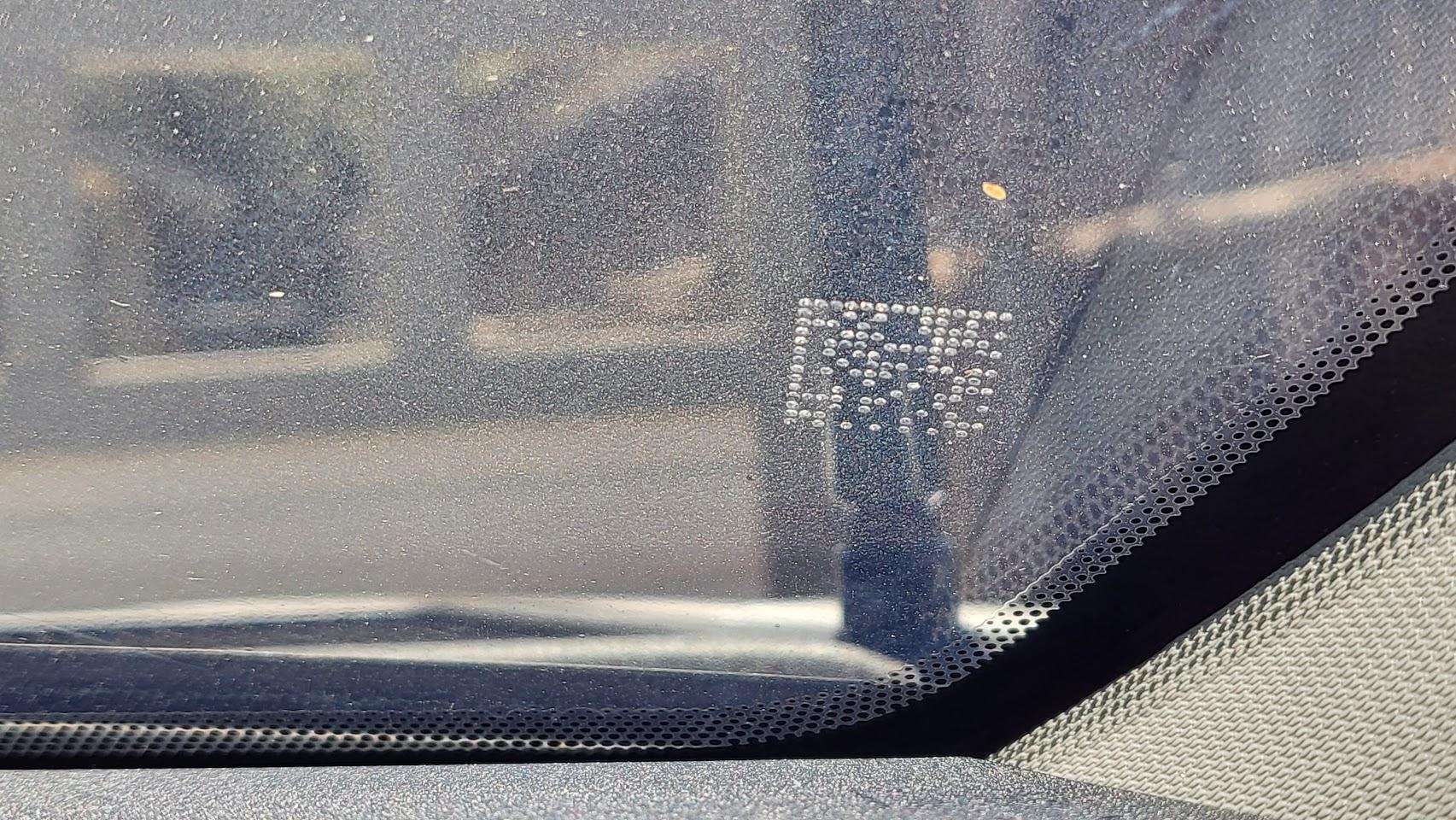

What's this QR code thing on the windshield on the lower passenger side? is that factory or was it done when I had tint installed? Never seen anything like it. This area was covered up by the original dealer registration sticker prior to having tint installed so I have no idea if it was there beforehand.

no idea but had it on 21 powerboost and lightning, wasn't your tint guy.

Can your camera on phone detect it as a code?

My dealer said it’s a factory thing and they had no idea what it is for.

I'd noticed that on mine too, and figured it was another Ford Easter egg, but haven't tried scanning it

Many of the parts on my Bronco have a QR type code on them. I assume it’s something used for tracking parts in the factory.

Well, Google lens failed to recognize it or pull anything useful from your picture.
