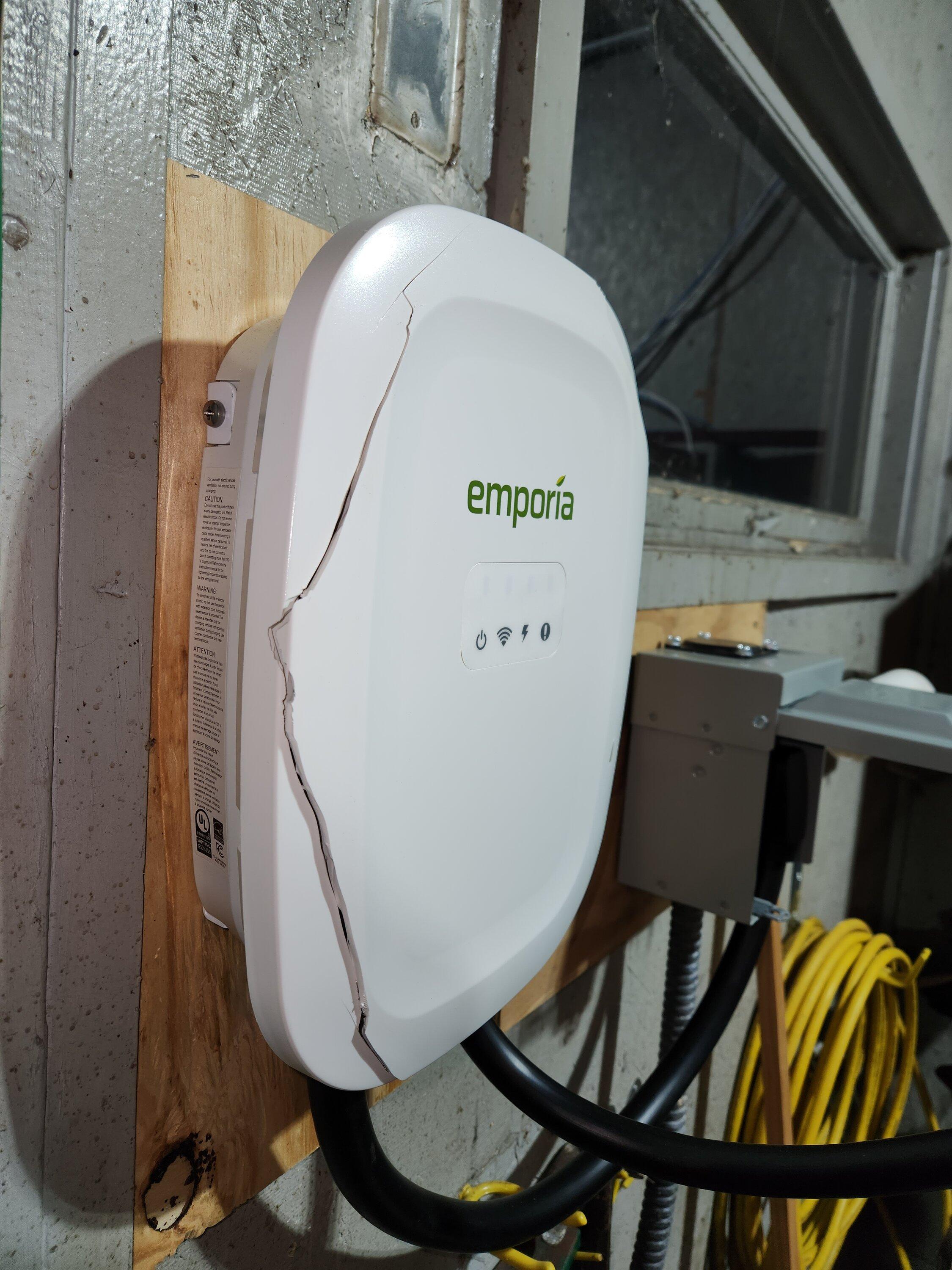

A storm blew through this evening and we took a lightning strike that knocked out one phase of our home power. Cycling the main breaker brought it back to normal but I found this when I went to check on the garage:
Ford F-150 Lightning Wrong kind of lightning strike - damaged charger 20230419_225303
That probably explains why the breaker to the garage also tripped... Needless to say I'm leaving the breaker to the charger off. I did reset it before I saw the damage and nothing happened (device did not power up). Truck seems fine and is responding to FordPass app but I did not try to start or drive it.
The worst part is that our utility room (not where the electrical panel is) has a strong ozone/burning smell. No visible signs of any damage but needless to say we will be checking it frequently through the night.

Possible you got a spike on one leg. Did you lose TV, fridge, or any other device?
Yeah, lost everything for a second. Half the house came back on right away. The toaster oven was making strange noise so that has been unplugged for now but nothing else found to be broken so far.
I'm still amazed by the physical damage to the charger with no external signs of heat. Looking forward to opening it up but it might be a day or two before I have time.

If it were me, I’d get a reputable, licensed electrician to check out your home’s wiring system. Given the symptoms you’ve discovered, there’s likely other hidden damage. Your homeowner’s insurance might cover this.

Wow! I have two of those Emporia chargers, opened one to hardwire, the only thing I could think of that could cause that cover to crack would be a transformer but even then the gap from cover to the board where everything is mounted seemed at least 1" away
If there are any capacitors on the board beneath the cracked area, those are prone to catastrophic failure when overstressed. They can explode violently.
True, we used to put electrolytics in backwards as fireworks.
Come to think of it, it's a somewhat sealed box so the air pressure of it popping tops of caps is probably what did it

I have a Whole House Surge Protector installed in my main electrical panel to mitigate damage from nearby lightning strikes and other power surges. It has worked well, but it will not protect from a direct lightning strike, which appears may have happened to you. You may consider adding one if you do not have one installed.
