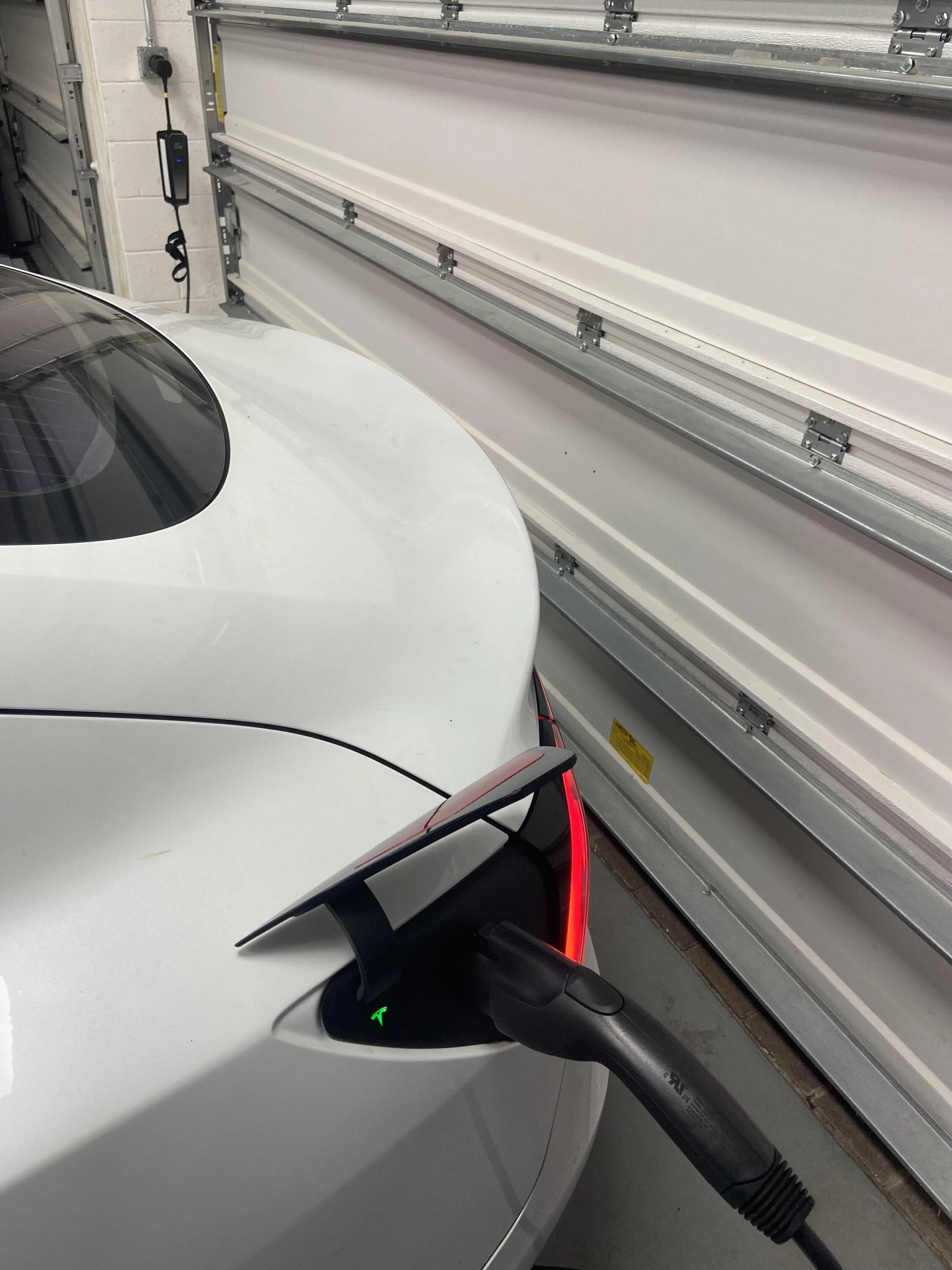

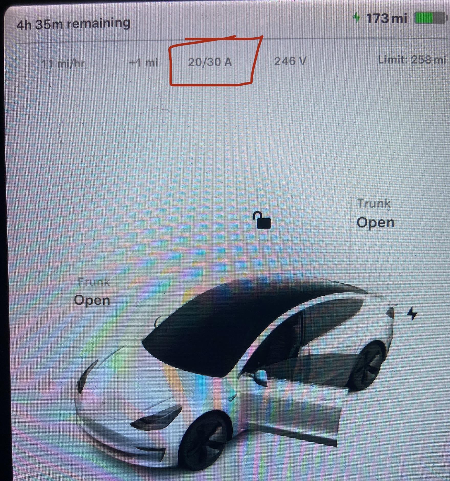

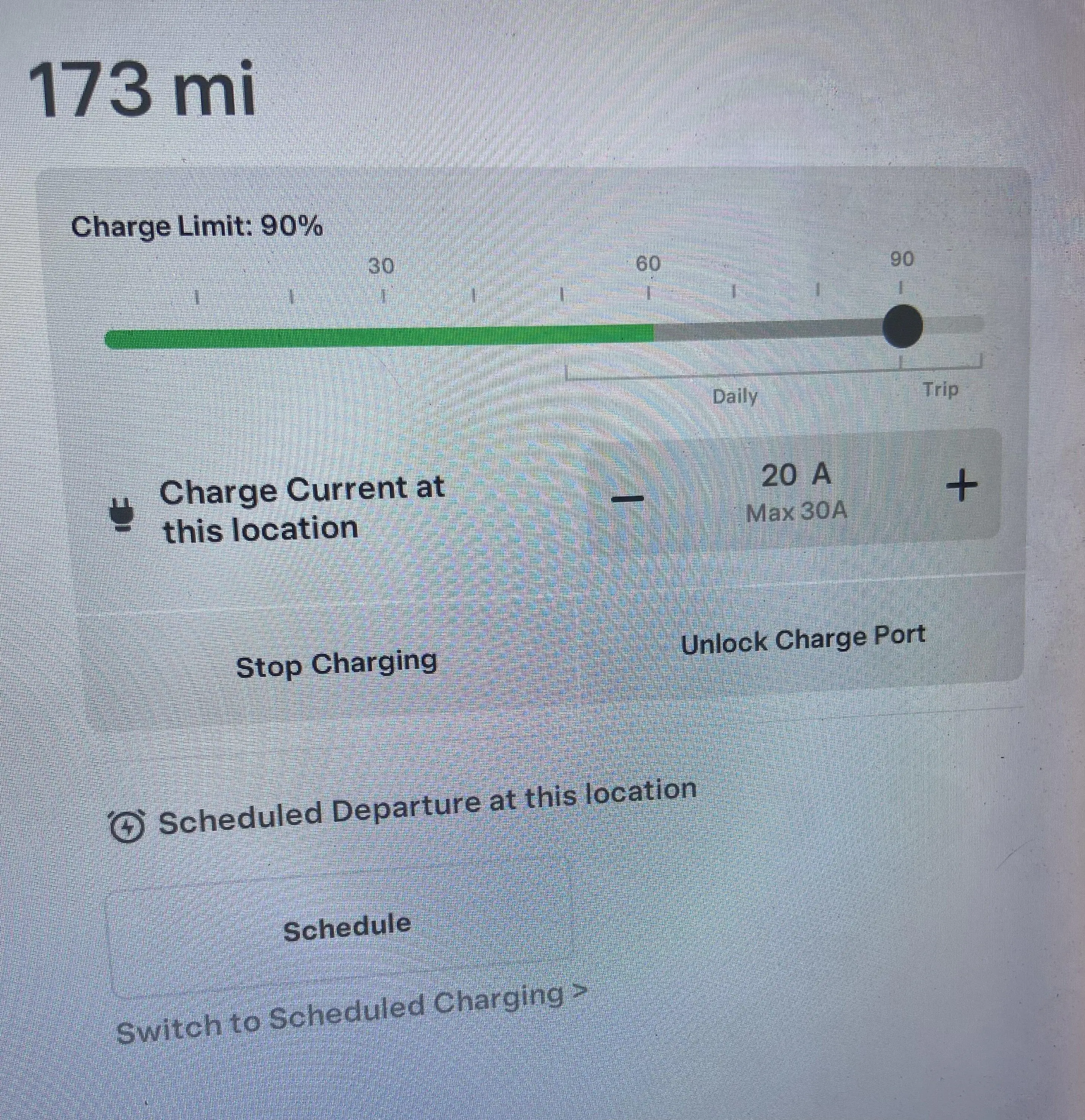

Correct, this is a vehicle software limitation, not a mobile cord problem. I just tried charging my Tesla from the Ford mobile cord with an adapter, and had no problem dialing down the amps from the default max 30A of the Ford mobile cord. I really hope Ford brings these features to the Lightning interface and the Fordpass app, since it’s very primitive in this and other regards.
