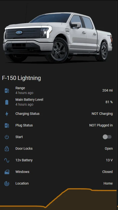

After setting up a custom HomeAssistant card
Ford F-150 Lightning LightningROD - Better Charge Logs 1695872562804
I still wasn't happy.
I wanted a nice dashboard to display my charges.

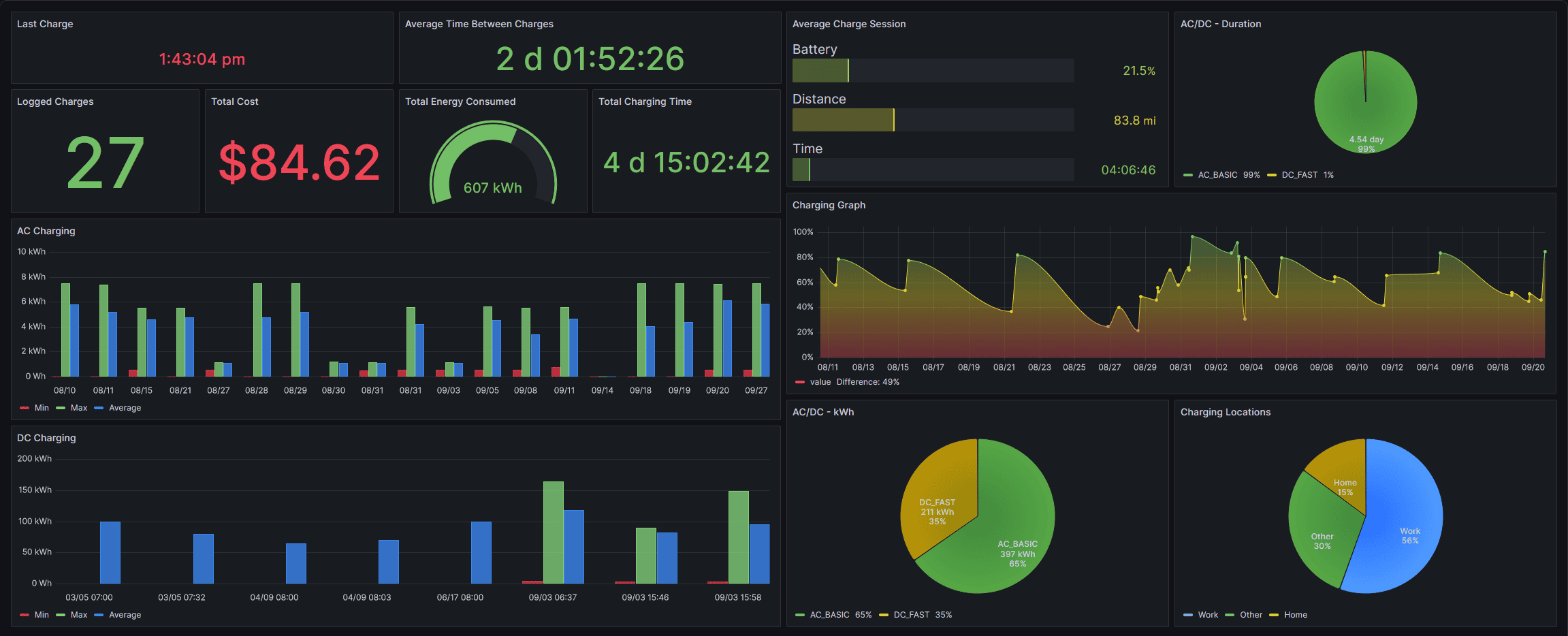

Here is a screenshot of what my current dashboard looks like
Ford F-150 Lightning LightningROD - Better Charge Logs LightningROD
I'm sure it will change over time

I love it!!! I want this on may phone
Ford peeps, please pay this person and use this work and make a data app for us. I would happily pay a small monthly fee for access. Diversification of revenue sources ?‍♂?

This is self hosted, but it does not stop Ford from also having your logs
This is just mimicking the FordPass App to make an API request (using the fordpass-ha) but downloading the data instead of displaying it
I initially planned on making it a standalone project, similar to TeslaMate but I just don't have that amount of time or skill so I figured I would post what I currently have an open myself up to collaboration.
I am happy to answer any questions
First one is probably going to be:
  • Q: Have you really only spent $85 on charging in 7 months?
  • A: Yes, I can charge for free at work - its great.
    • I also don't drive that often.... and these are the only logs I have available
Project can be found here:
https://github.com/SquidBytes/LightningROD
