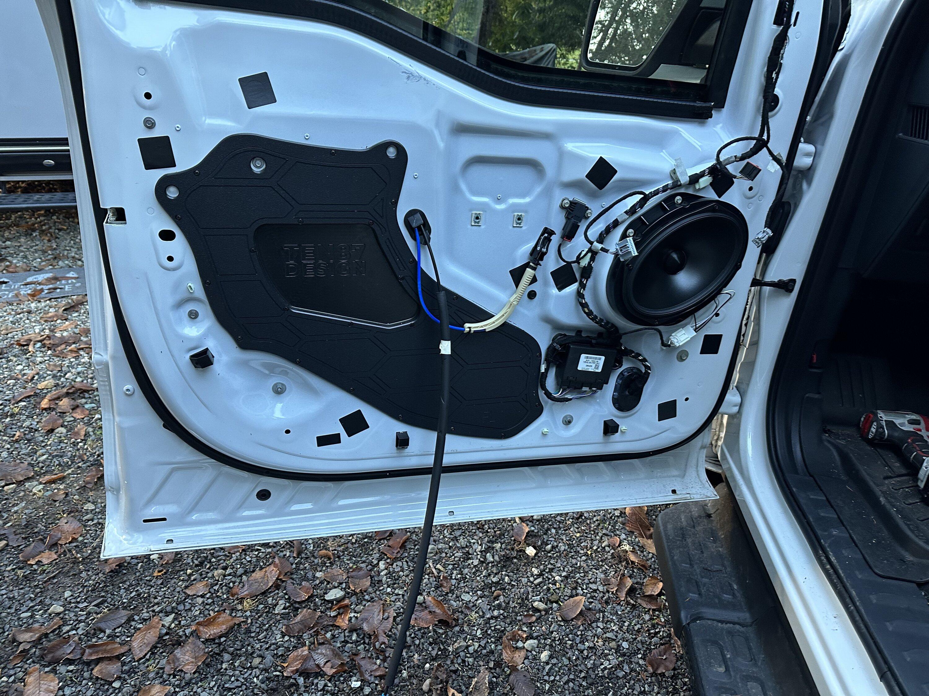

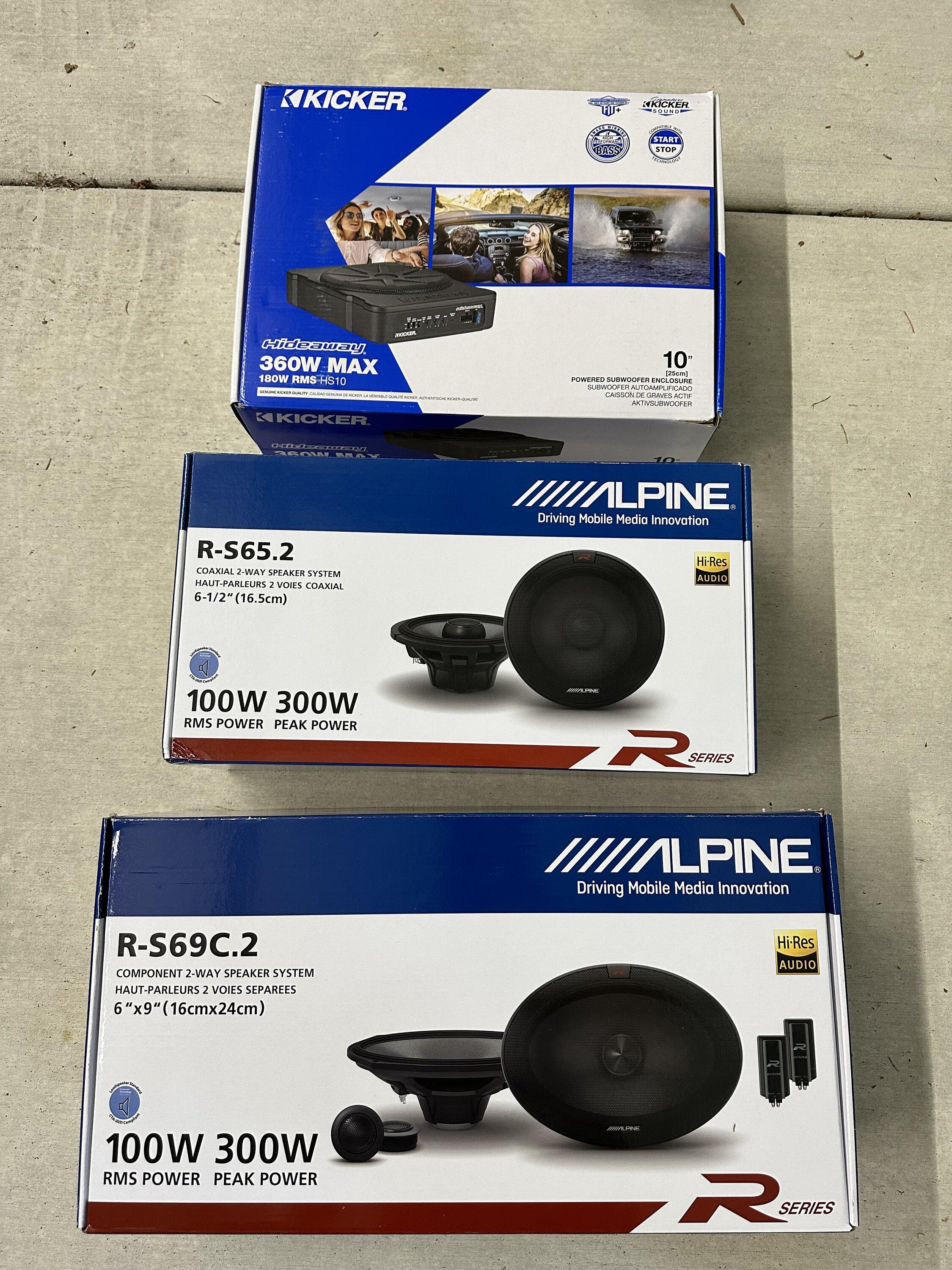

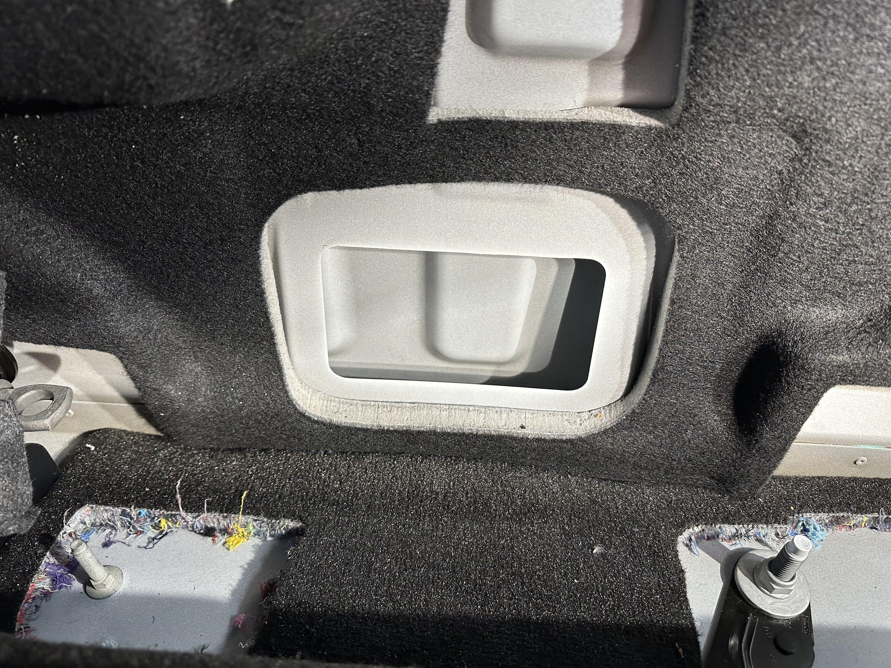

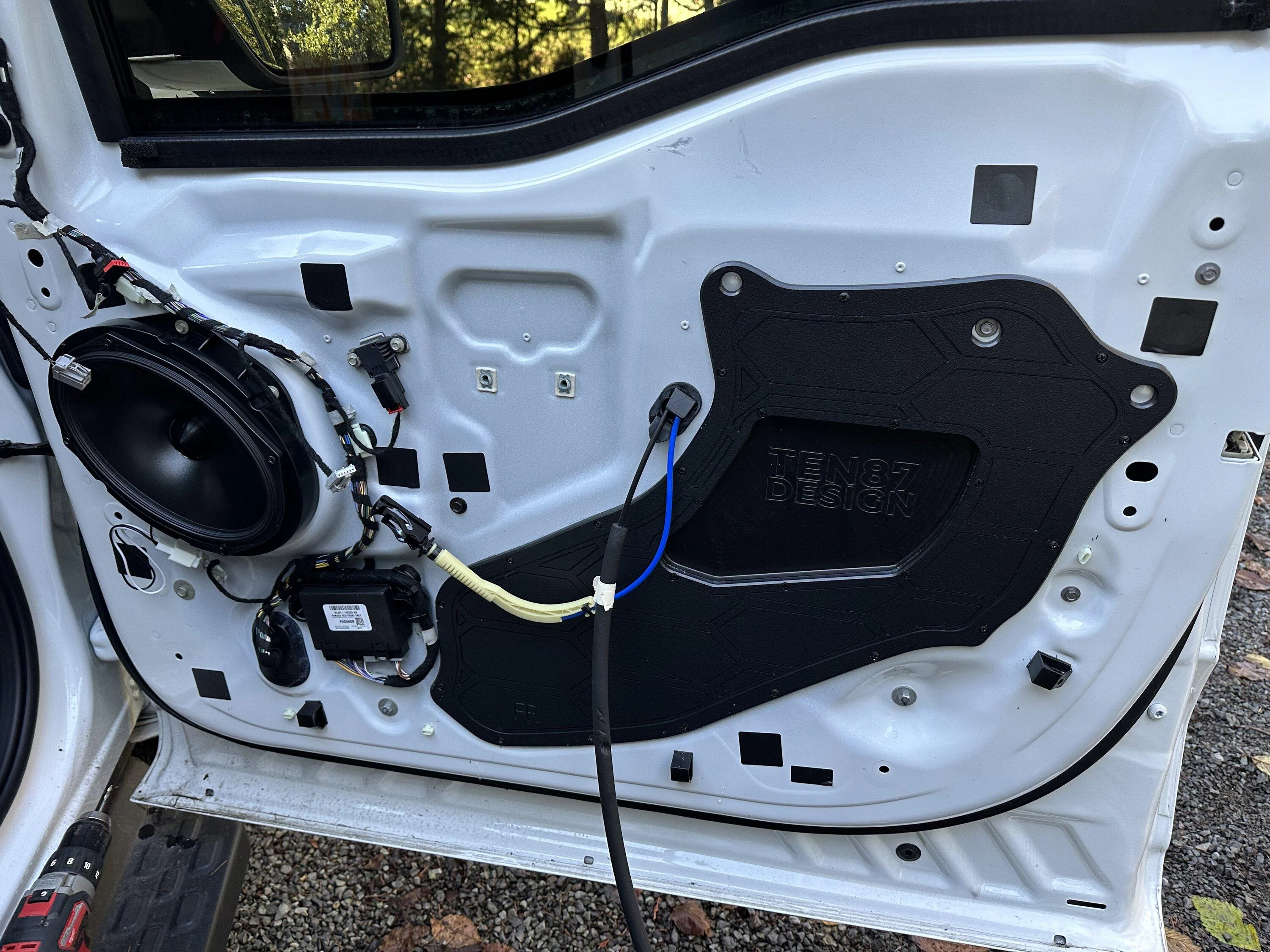

I recently completed an audio upgrade which I started over the summer. After a lot of research on this forum, the other Lightning forum, and Youtube I pulled the trigger. I did not upgrade the head unit for obvious reasons. I am adding this content because most audio upgrades on this forum are multiple thousands of dollars. I am not an audiophile, and listen primarily to Sirius/XM / Apple Music / Spotify. Total cost was under $1000 (more likely $850 but I didn’t track all of my receipts). I was initially hesitant with such expensive truck but found the job to be easier than I thought (with help listed below). I was slow and careful. BTW the B&O 8 speaker system is complete garbage.
This has made a HUGE difference. It is so much better.
A couple of clarifications : 1) I have never worked on car audio before 2) I am a strong believer in YouTube university 3) I am pretty handy 4) I have had to figure out a lot of electrical gremlins in boats so I was not too worried about doing this.
I want to shout out soundgoodstereo for the plug and play sub adapter, sub block plate, and front/rear door block out plates.
I also want to shout out provobeast on YouTube () for a complete walk through of front/tweeter/rear speaker tutorials.

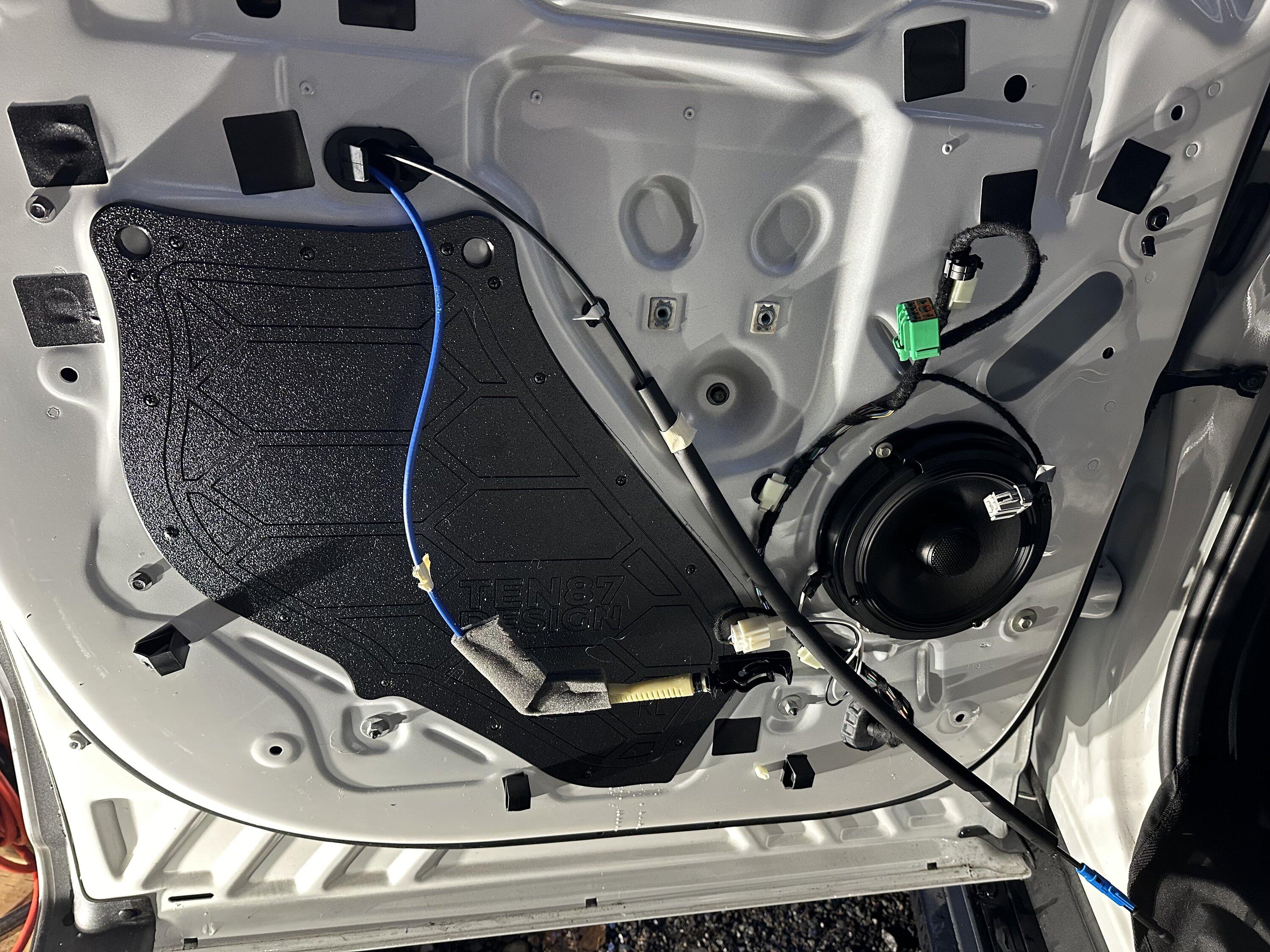

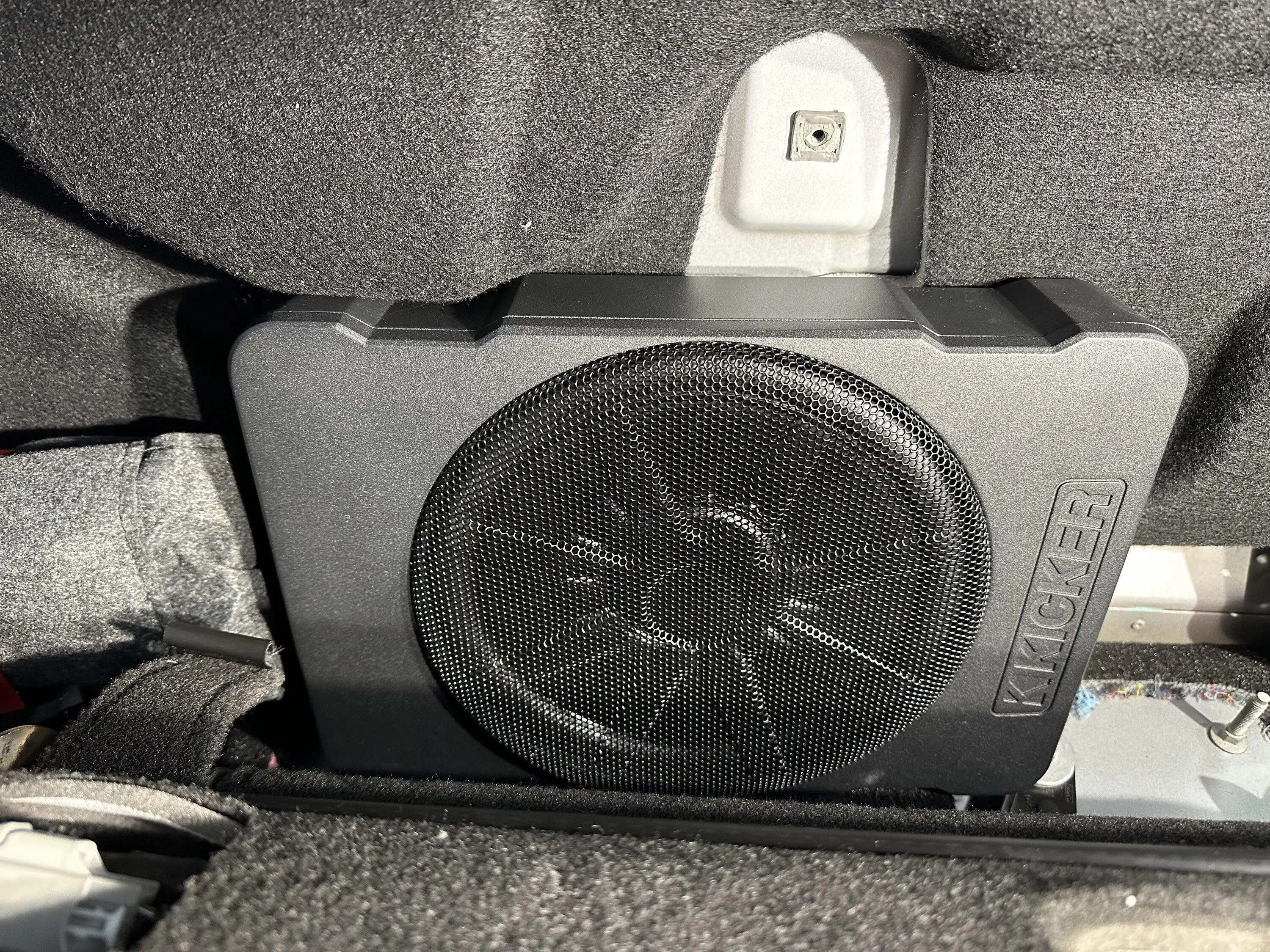

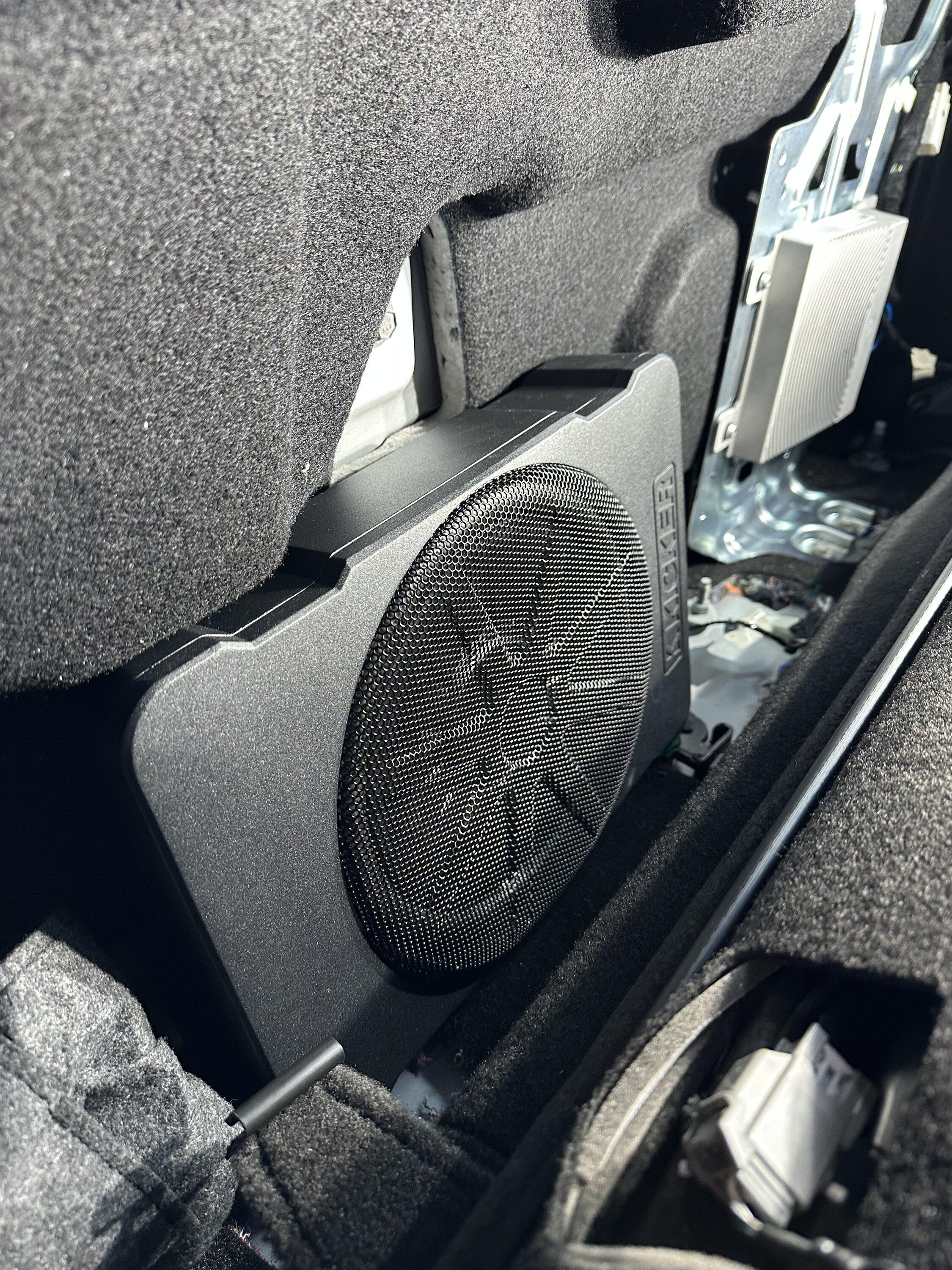

I had to figure out the sub replacement and center dash speaker on my own. The trickiest parts were running power to the 12 V battery from the rear seat area for the sub and replacing the A pillar tweeters. I broke a few clips when removing certain trim pieces along the way. The tweeter factory wires were extremely small and hard to join with the speaker wires. There is no aftermarket harness for them. The 4 door speakers and sub have adapters (links provided). I also had to ‘hard wire’ the center dash speaker.

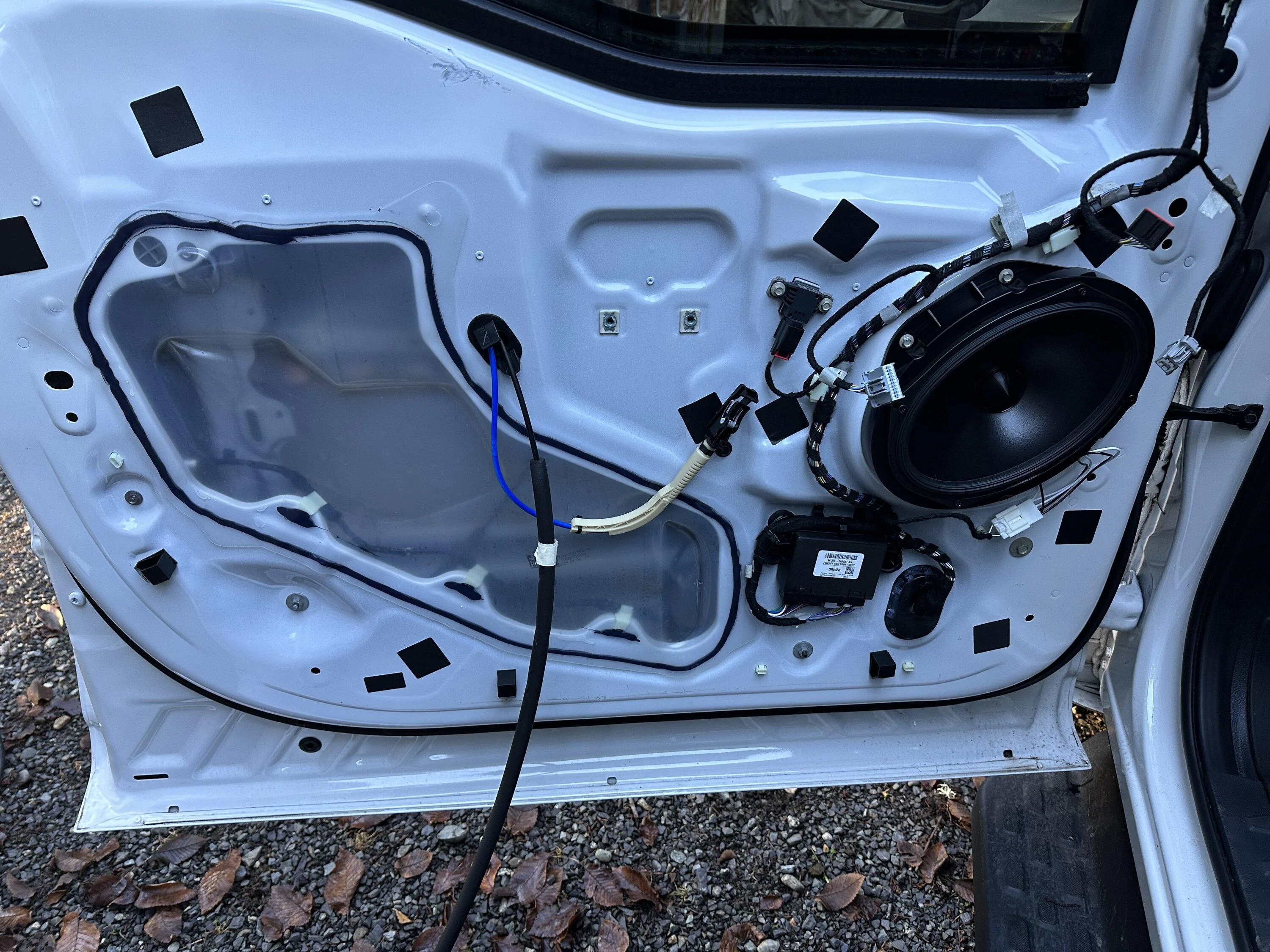

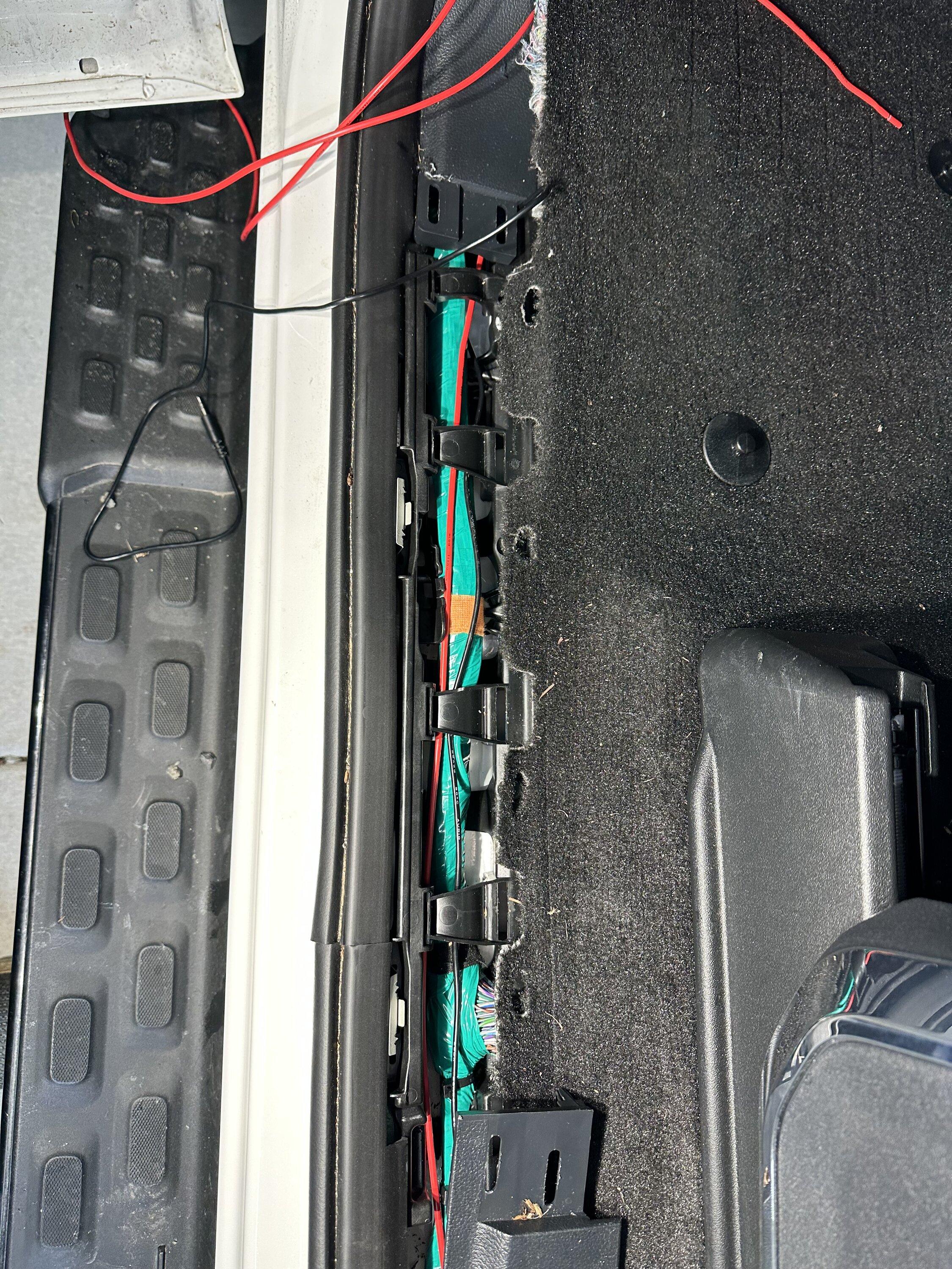

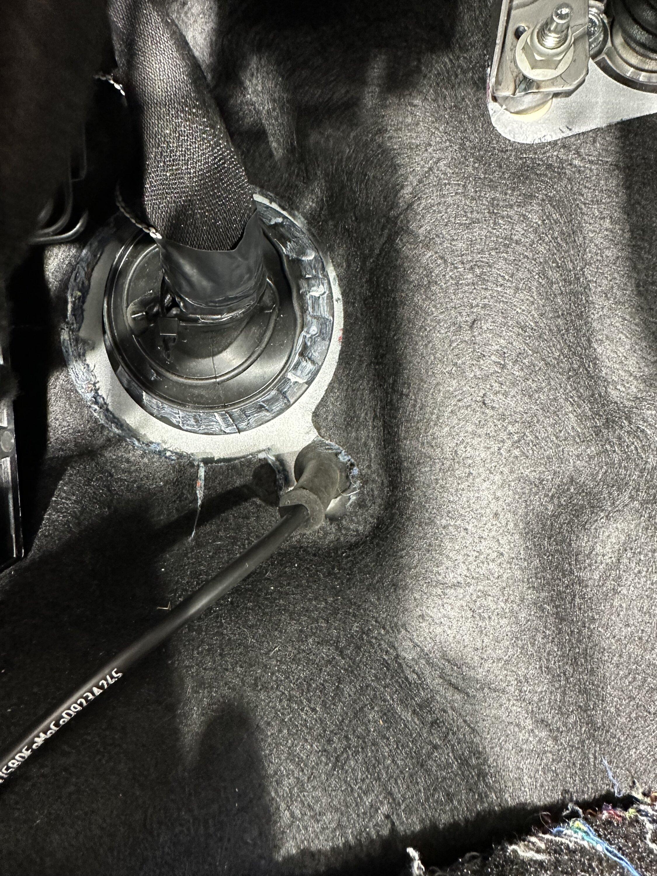

I ended up running wiring under the drivers side door channels for the sub control and power. I poked through the ‘firewall’ under the drivers side steering console. There is a rubber grommet that allowed me to route to the 12 V battery. (I have had not 12 V issues at all). I strongly recommend buying a good trim kit instead of using pliers and screwdrivers.
Here is a list of parts. Most came at the recommendation of provobeast. Sound Good Stereo has a lot of great options as well, but those were out of my price range. The sub fits perfectly in the existing spot and is only attached with command hook Velcro.

I appreciate the passion on the topic. I wanted to add a couple of things.
1. I went to a local high end shop and was quoted over $5k (custom sub enclosure/amp/amp rack/minimal sound deadening/dsp/speakers). These were better components than I installed. Generally I scoff at things like that and decided to do it myself. The shop owner told me my approach wouldn’t help (speakers only or powered sub).
2. I wanted to demonstrate that an average handy person could do this and be happy with the result. No need to break the bank. There are less expensive versions that would also yield positive results. The most expensive item was the powered sub. I also know a lot of people like to invest heavily in this area. That wasn’t my choice.
3. Once the factory speakers were removed, I laughed. The combination of the 4 of them weighed less than one of the new speakers. They promptly went into the garbage. Regardless of the name, the speakers were cheap cheap cheap.
4. I played with the existing ‘tuning’ options. I wish there was more control than balance/fade/bass/mid/treble/surround/stereo.
5. If I was to start again I would start with the powered sub replacement. For me, with that addition, the power output is more than enough for the remaining speakers
6. Isolating the tweeters from the lows is part of the components I installed, that is why I went with that recommendation
7. I added the door blocking for two reasons, speaker enclosure and to see if I could make the cabin even quieter. I LOVE how quiet this truck is and smooth the ride is. Better than any car or truck I have ever had.
And finally, I am totally satisfied with the results.

anybody replace the 6x9 "sub" with another high quality 6x9 exactly in its place?
