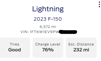

To make sure the number is current, open FordPass and do a refresh. That will send the current data to the mothership. Otherwise you might be seeing an old number.
Yes, I was aware of that, but thanks for checking. Charger has AMB selected, and indicates fully charged. Yet,
Ford F-150 Lightning 12 V battery drained overnight 1702905917395
