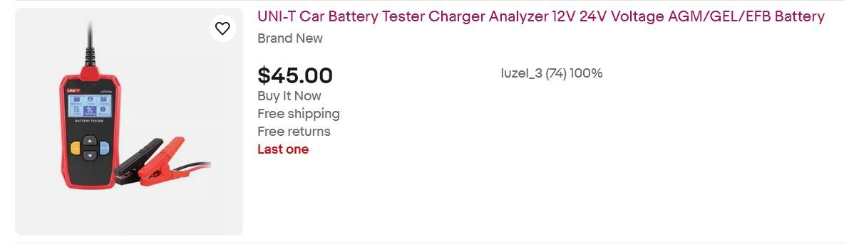

Yes, you can have adequate terminal voltage but no ability to draw a sufficient current (capacity) and your device is just relying on terminal voltage.
I'd bet the dealer did NOT do a real check of the battery current capacity.
If you want to do it on your own, you could get one of these:
Ford F-150 Lightning 12v Battery Issue UNI-T 673 pic 0
It will give you a real assessment of the health of the LV battery.
There are a lot of posts about how to get the LV battery charged up because surprisingly, Ford lets it go as low as 40% for 48 hours before transferring energy to it from the HV battery.
The LV battery WILL get charged when the Lightning is plugged into a Ford Charge Station Pro for several hours, is turned on, and the HVB is set to charge to 90% - that's what I had to do when I could not get an update due to the LV battery being too low.
So you could do an exhaustive test of the LV battery, or just do what I did above (based on some info posted on this forum btw).
