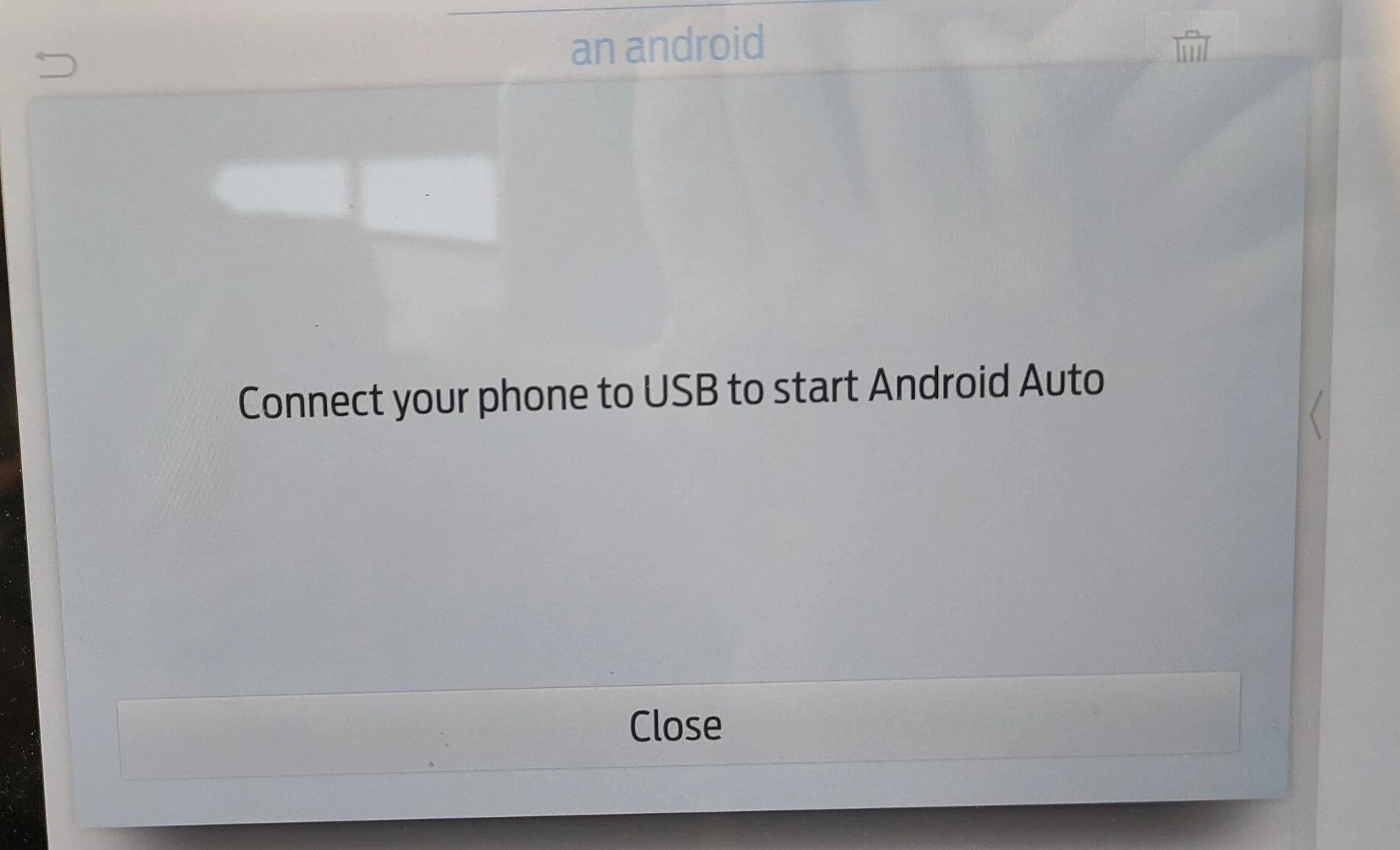

It could be your phone. Here are the current list of phones that supposedly support Android auto. https://support.google.com/androidauto/answer/6348019?hl=en#zippy=,android-auto-on-your-car-display-wireless
well, I assume it's the phone, but it is running Android 11.x and obviously supports 5 GHz wifi. I have an old Pixel phone around here, I'll try that, for no reason other than to see if it works and I'll get the Pixel 6 next month.
I futzed around for a while, tried every menu, can't find a way to get iPhone or Android to connect wirelessly (other than just streaming bluetooth.) Here's the only message when attempting to get the Android 11.x phone to connect wirelessly (USB works fine.)
Ford F-150 Lightning 2021+ F-150 FORScan List / Database / Spreadsheet ? android auto usb
I'll add this to my list of questions for the truck's first service next week. Maybe mine was built before wireless Android Auto was implemented (?)
Maybe look at "permissions" on your phone
that was it! the phone had an individual permission to turn off android wireless
