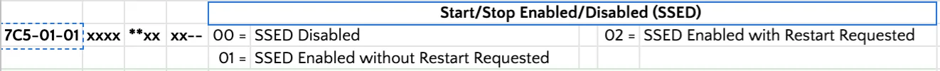

Hi All,
Just got my '21 Raptor a few days ago. I've started to change some things around Forscan.
Here is what I can confirm works the same as the spreadsheet:
1. Double Horn Honk.
2. Fogs on when high beams on.
3. 726-38-01 xxxx xxxx **-- DRL_IncludeParklamps_Cfg: 00=Disable 01=Enable turns the 5 marker lights on when the DRL's are on.
Here is what I can confirm DOES NOT WORK the same as the spreadsheet:
1. Auto Start/Stop Disabled
Can anyone help with the auto start/stop disable? That's the sole reason I got Forscan and I really want to get it disabled ASAP.

This may not help you any, but disabling it in Forscan will not cause the button light to light up like it does when you manually turn it off. However, when you're sitting at a standstill, you should still see the icon on your gauge cluster that indicates that it's disabled (it's the (A) icon with a slash through it)
I appreciate the input. Unfortunately, when using the programming found in the spreadsheet, my truck does not recognize that a steering event is occurring. As it does not recognize that a steering event is occurring, the Auto start/stop works as if I hadn't done any programming at all.
