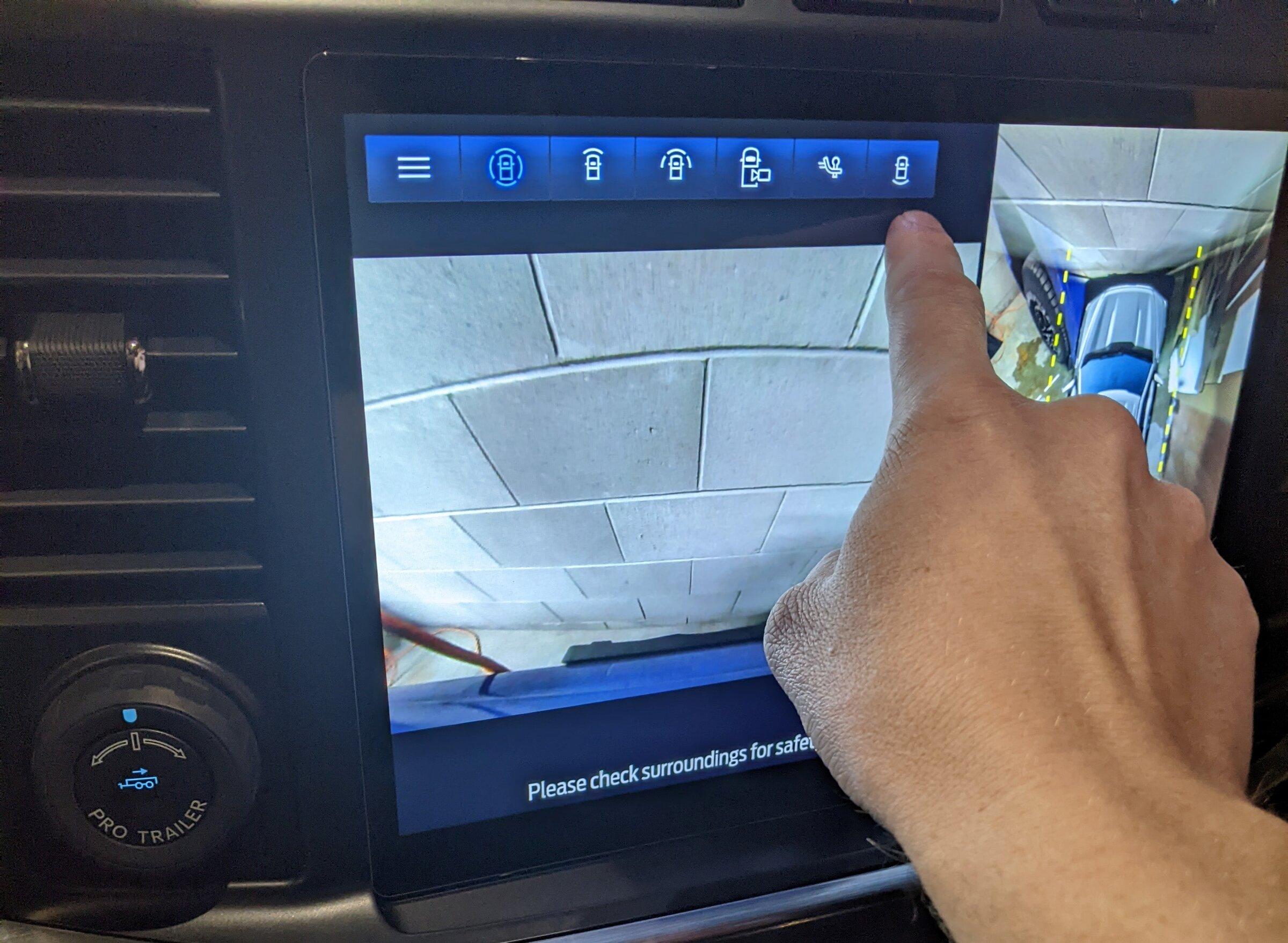

I also was able to get my Sync version up to 21281 rev244 with FDRS. I now have camera's at speed also based on the following changes. I have a Feb 2021 build.
IPMA 706-02-02 xxxB CExx xx--
APIM 7D0-01-01 xxxx xxxx Fx--
APIM 7D0-01-02 6xxx xxxx xx- (Tried it but I lost my camera menu "three horizonal bars". Went back to stock)
APIM 7D0-01-04 xxxx EDxx xx--
I haven't been able to get my Rear-View Split-view button (See picture) to work. I can tap it all I want and nothing happens.
My raptor doesn't have the rear split view at speeds. So im not sure your missing anything
EDIT- I just noticed you where reffering to the regular rear view and not the wide/split rear view like we can do with the front.
