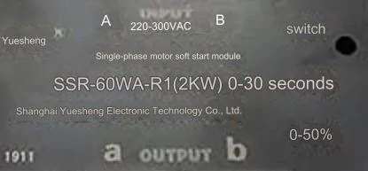

I wonder if a soft start contactor would keep the surge down to not overload the Pro Power? I suspect it has zero headroom beyond the 7.2kW. Maybe this Chinese thing from Amazon (I had google translate the image):
Single-Phase-controller2KW4KW6KW8KW
Ford F-150 Lightning 9.6kw ProPower - different battery pack? 231009 chinese soft start need translate Screenshot 2023-10-09 214918

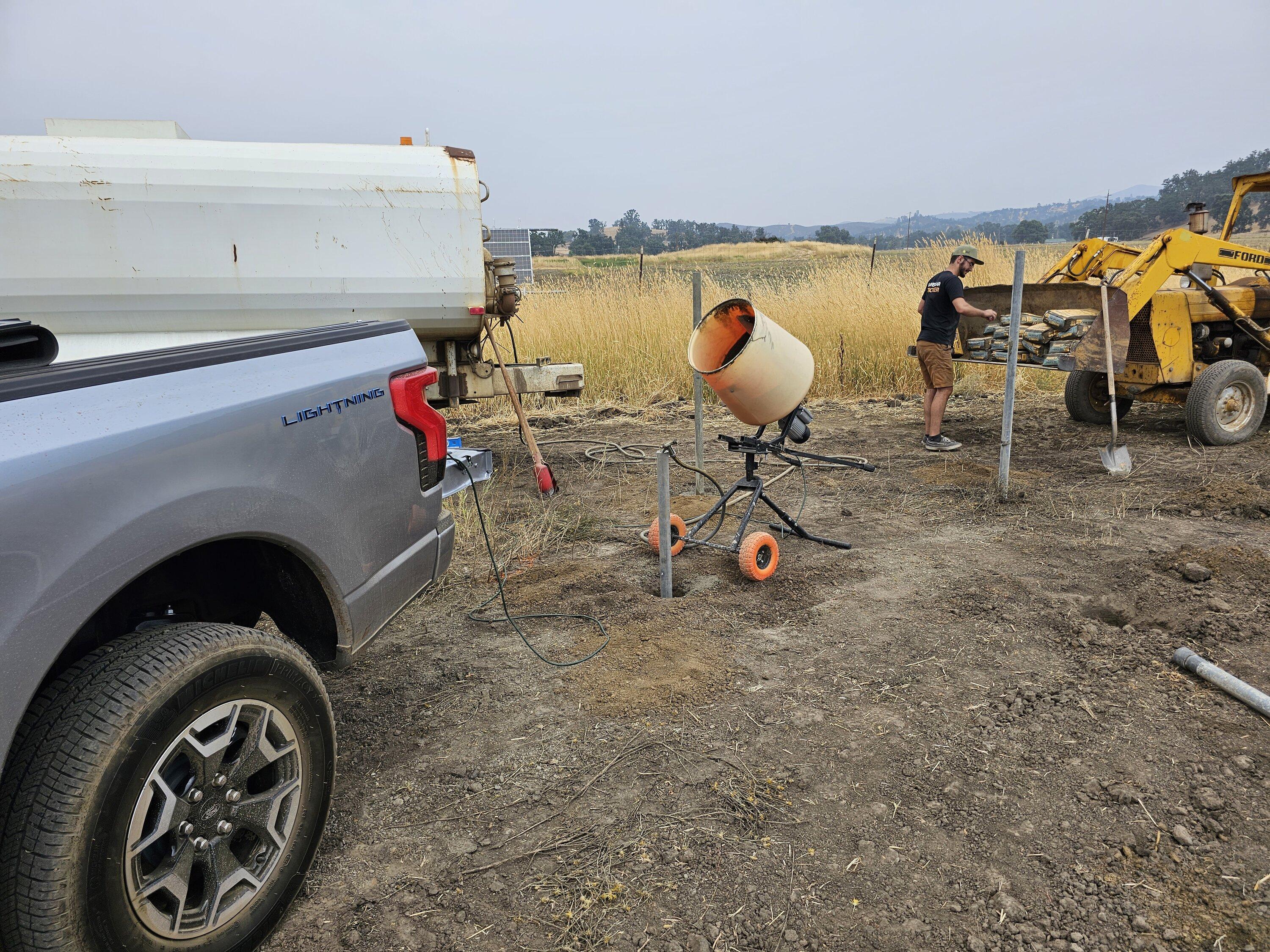

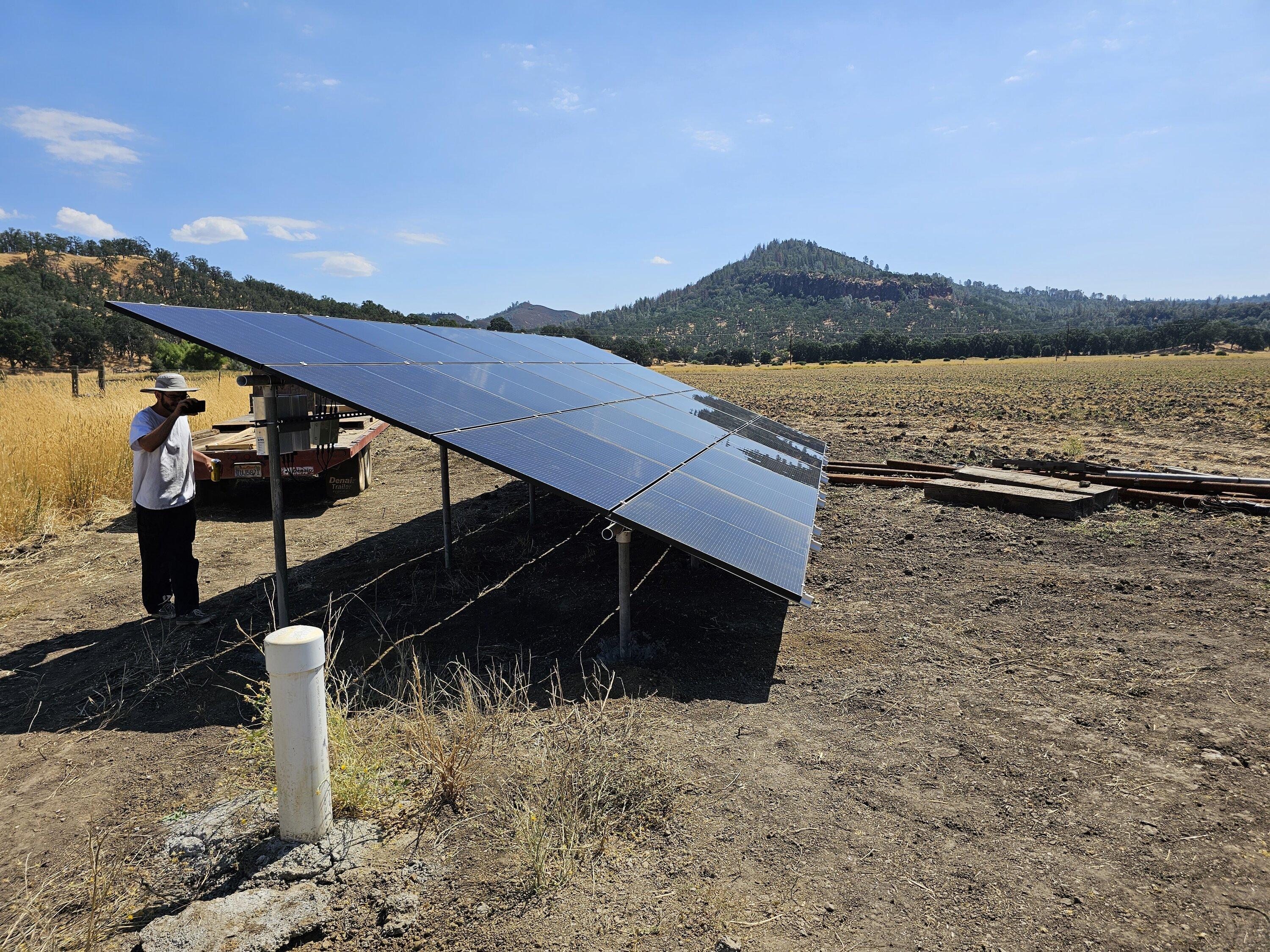

I use my lightning for work, We run a concrete mixer along with other various equipment all the time.running the mixer for 6 hours dropped the range by 2 miles. It's the best work truck I have had. It's very capable off road. We have hauled a 8000 lb trailer thru some pretty deep mud and over some slippery back roads.
Ford F-150 Lightning 9.6kw ProPower - different battery pack? 20230821_134514
Ford F-150 Lightning 9.6kw ProPower - different battery pack? 20230824_120426
You guys haven't made the switch to ground screws?
Concrete sonotubes are caveman tech now-a-days.
We do ground screws but this customer wanted concrete. We also build solar trailers with batteries , generators and what ever else somebody needs. But I am very happy with my lightning.

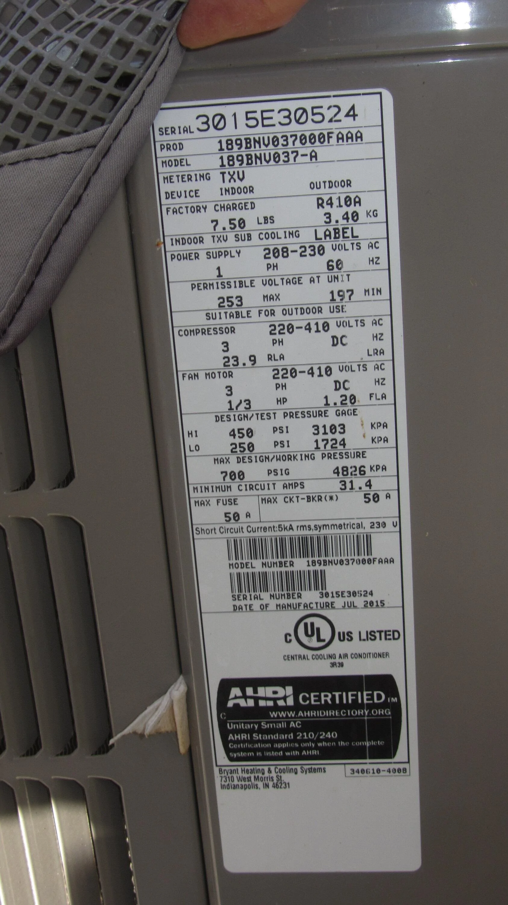

Getting farther from the OP's initial question of where does the power come from (HV battery) and how much range loss (up to 9kW per hour from 98kW-hr or 131kW-hr battery), with the discussion of power surge, our small 1200 sq. ft. house Bryant variable speed air conditioner shows minimum circuit Amps at 31A, but never gets over 10A max'd out and no surge detected. Highly recommend going variable speed. Fairly quiet as well. However, we cannot keep the 50A spa circuit on when backfeeding the house from the truck!
